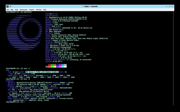

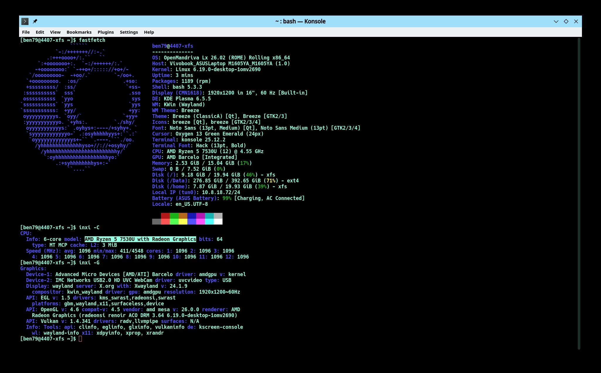

I am also using Ventoy. Have done 2 installs on hw (AMD Ryzen 5 7530U with Radeon Graphics).
ROME P6 X11 x86_64 from iso # 4403
ROME P6 Wayland Ryzen from iso # 4407
This is from one of those:
Everything is working except virtualbox-7.2.6. That has no kernel modules for kernel 6.19.0-1. If I use a kernel 6.18.x I can load kernel modules but there is another problem reported here. VBox is also broken in Cooker.

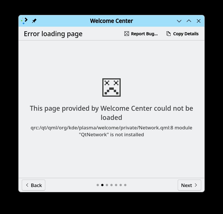

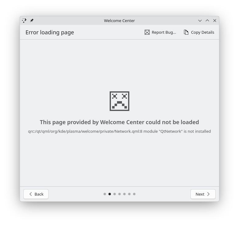

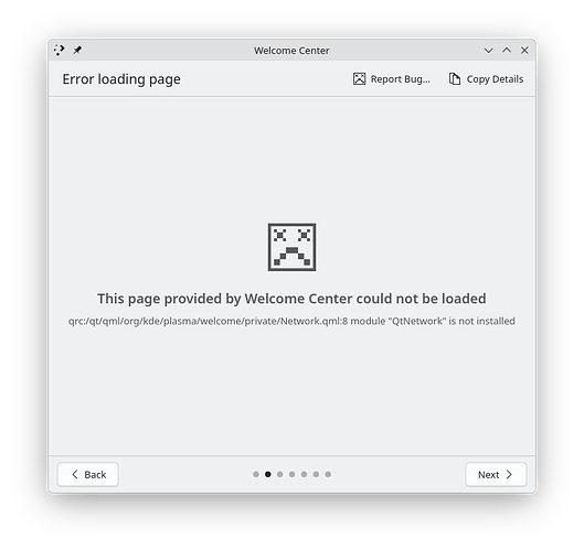

I got two errors.
The first one was with the Welcome Center:
No idea as to how to resolve that. So I kept going. That happened in the KDE Plasma 6 Welcome Center. Not the OM Welcome Center.

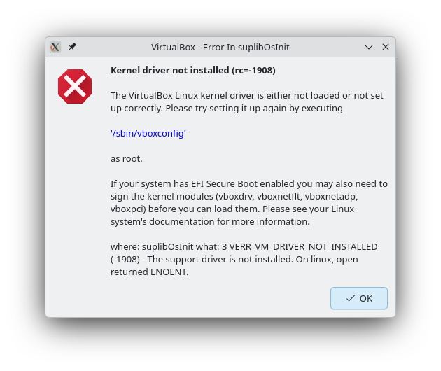

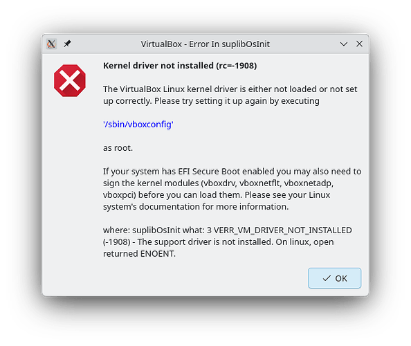

I figured I would give VirtualBox a try. It installed, or so I thought. This is the error I received when I tried to run a virtual machine:
When I ran the installer for 4404 from Ventoy, Secure Boot was disabled and I kept it set to disabled in the UEFI settings. One less thing to deal with.
When I try to execute /sbin/vboxconfig as sudo, I am informed there is no such file. I have no idea what is happening.

That is one page. I never worried or thought about because why? I have not idea why that page does not load. But I also have a negative opinion of that KDE Welcome Center. It seems useless fluff that should be eliminated. Just my opinion though.

Digging a little deeper on the Internet, it seems several other big-name distros are having the same issue with the KDE Welcome Center. Not a good look for KDE. I believe this it their problem.
I tried this on the installation that I performed back in March last year on my other laptop, the ASUS X555UA. Guess what? Same KDE Welcome Center error message. Anyone can replicate it simply by running this app if using Plasma 6. It seems X11 or Wayland doesn’t matter as I just did it running X11.
I reported this to KDE. Will see where this goes. I highly suspect it is not a high priority for them right now.

Two messages from KDE:
Nate Graham nate@kde.org changed:
       What    |Removed                     |Added
             CC|                            |
— Comment #4 from Nate Graham nate@kde.org —
*** Bug 516153 has been marked as a duplicate of this bug. ***
You are receiving this mail because:
You are on the CC list for the bug.
         Status|REPORTED                    |RESOLVED
     Resolution|---                         |DUPLICATE
— Comment #1 from Nate Graham nate@kde.org —
This is a packaging issue in your distro; see Bug 511809. Please tell them to
install the QtNetworks QML module as a mandatory dependency for plasma-welcome.
*** This bug has been marked as a duplicate of bug 511809 ***
You reported the bug.
End edit.
I tried to go to ~/VirtualBox VM//Logs/VBox.log to locate that log file. It is missing. There is no Logs folder, never mind any .log files. Is this because the virtual machine never ran long enough to generate the .log file?

There are 2 problems. There are no kernel modules for kernel 6.19.0-1 for VBox. That would probably be why you do not see logs.
The problem in the bug report is a different issue that does not allow VBox to start VM’s, I got the information for the bug report using kernel 6.18.9.
