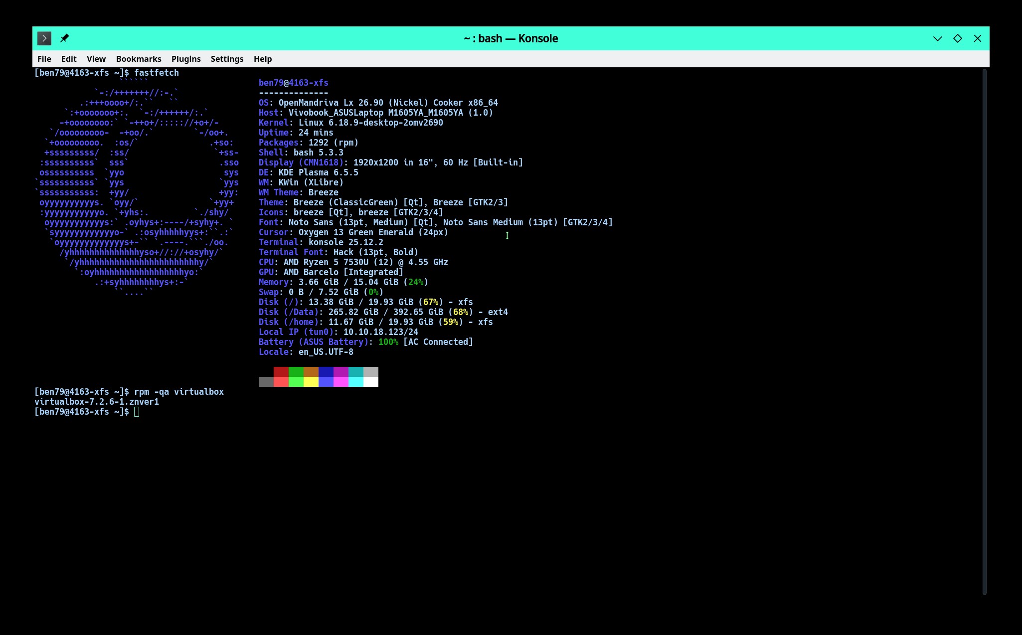

$ cat /etc/release
OpenMandriva Lx release 26.90 (Nickel) Cooker for znver1
Cooker and ROME Plasma6 both dsynced today

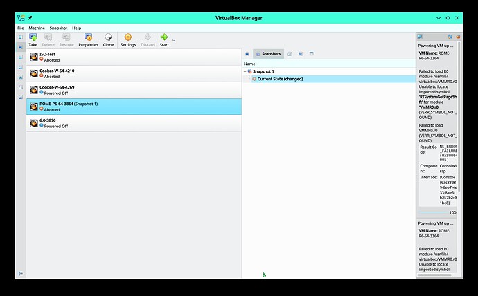

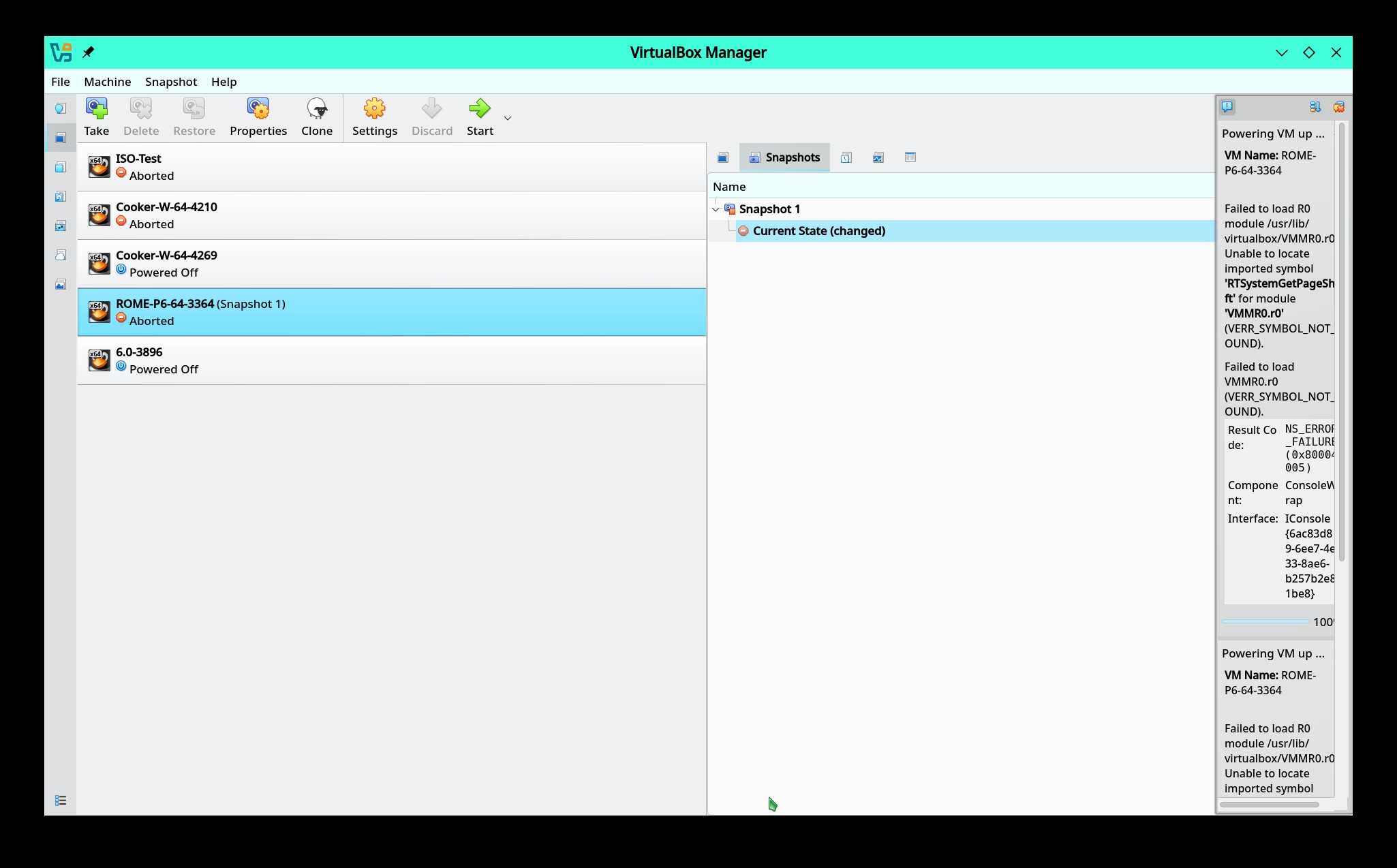

The problem is that VM’s do not open as shown in screen shot above.
Starting VM from cli just tells what is already known:
$ VBoxManage startvm "ROME-P6-64-3364" --type headless
Waiting for VM "ROME-P6-64-3364" to power on...
VBoxManage: error: Failed to load R0 module /usr/lib/virtualbox/VMMR0.r0: Unable to locate imported symbol 'RTSystemGetPageShift' for module 'VMMR0.r0' (VERR_SYMBOL_NOT_FOUND).
VBoxManage: error: Failed to load VMMR0.r0 (VERR_SYMBOL_NOT_FOUND)
VBoxManage: error: Details: code NS_ERROR_FAILURE (0x80004005), component ConsoleWrap, interface IConsole

That would be some kernel patch openSUSE has? Can we hope that is in the latest from kernel.org? Which is 6.19.2 and which is building for Cooker right now.
Looks like I may need to change the title of this thread. I tried in a new ROME system installing virtualbox-7.1.8 and using it with kernel-desktop-6.17.8-1 and I am still getting this error. That suggests the problem is something else, not the kernel or the version of VBox.
