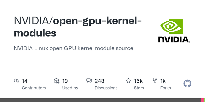

From the top: Yes it is. I looked at that exact page, used my PCIID (10DE:1F07), and it is NOT there. This version of the 2070 is literally ONE iteration too old.

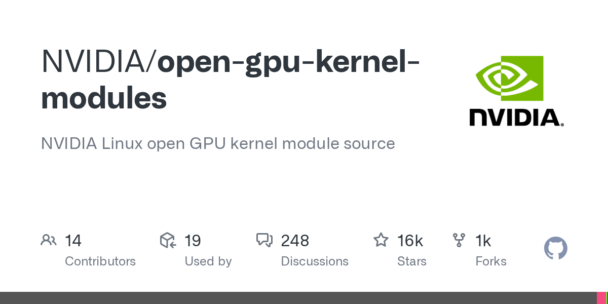

Finally, after Ctrl + F on the Github page you can find this:
NVIDIA GeForce RTX 2070	1F07
That is your card.
I saw that, but when I look at the format of the PCI IDs on that table, I am fairly certain that is for a different field. This is on top of the fact that during my last installation using the “open source NVIDIA modules” didn’t work. Unless I am mistaken running that command should have made the “Kernel driver in use” be nouveau, correct? Because it had showed “nvidia” from that iteration. I have not attempted to install the open source modules this time, as stated because I managed to cripple the install last time, and that 10DE is nowhere near 1F07 in the listing.
I will attempt your solutions tomorrow.
That is referenced for the same family Quadro card with the same die but different features. I think there are other issues beyond the open or closed driver.
