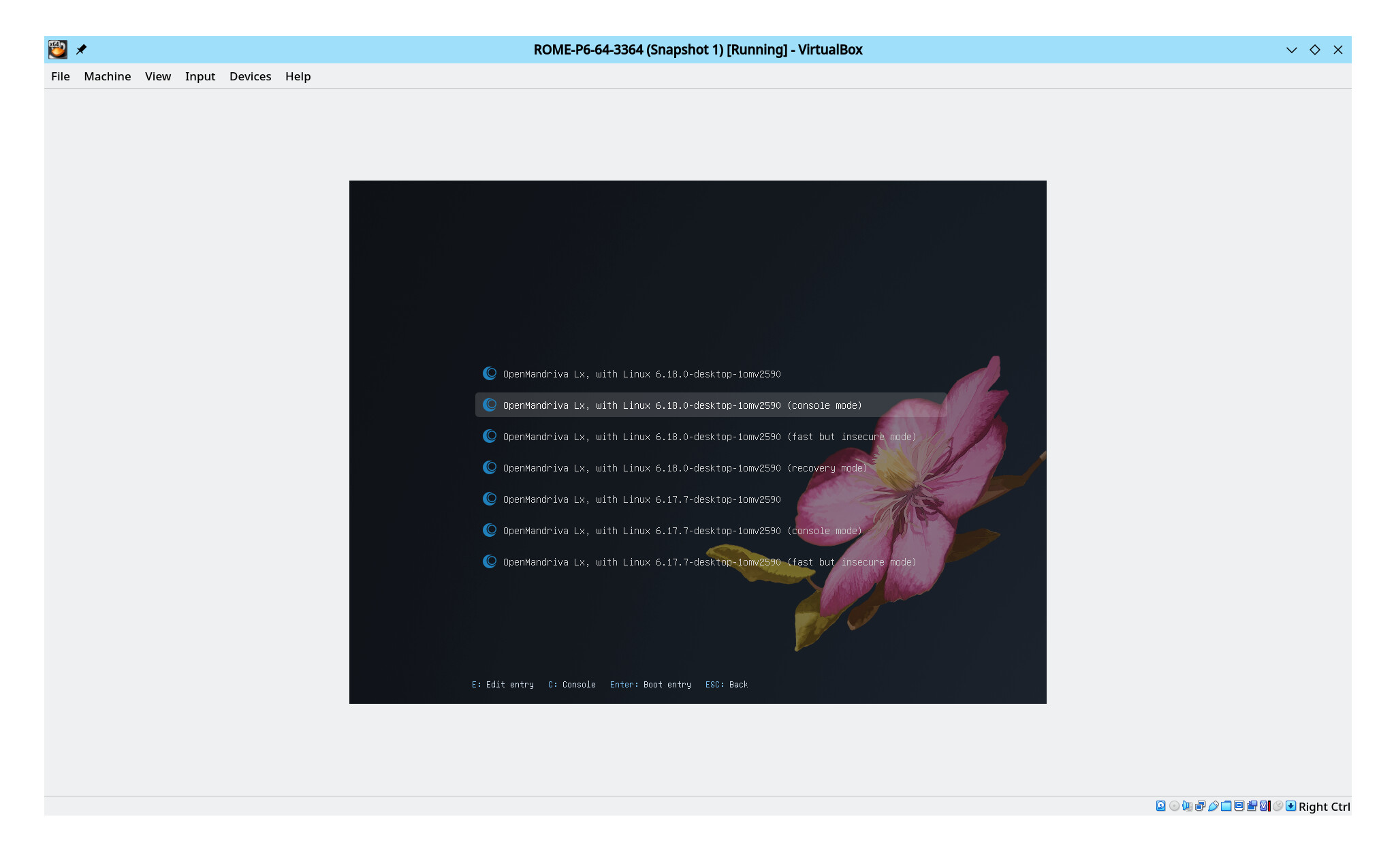

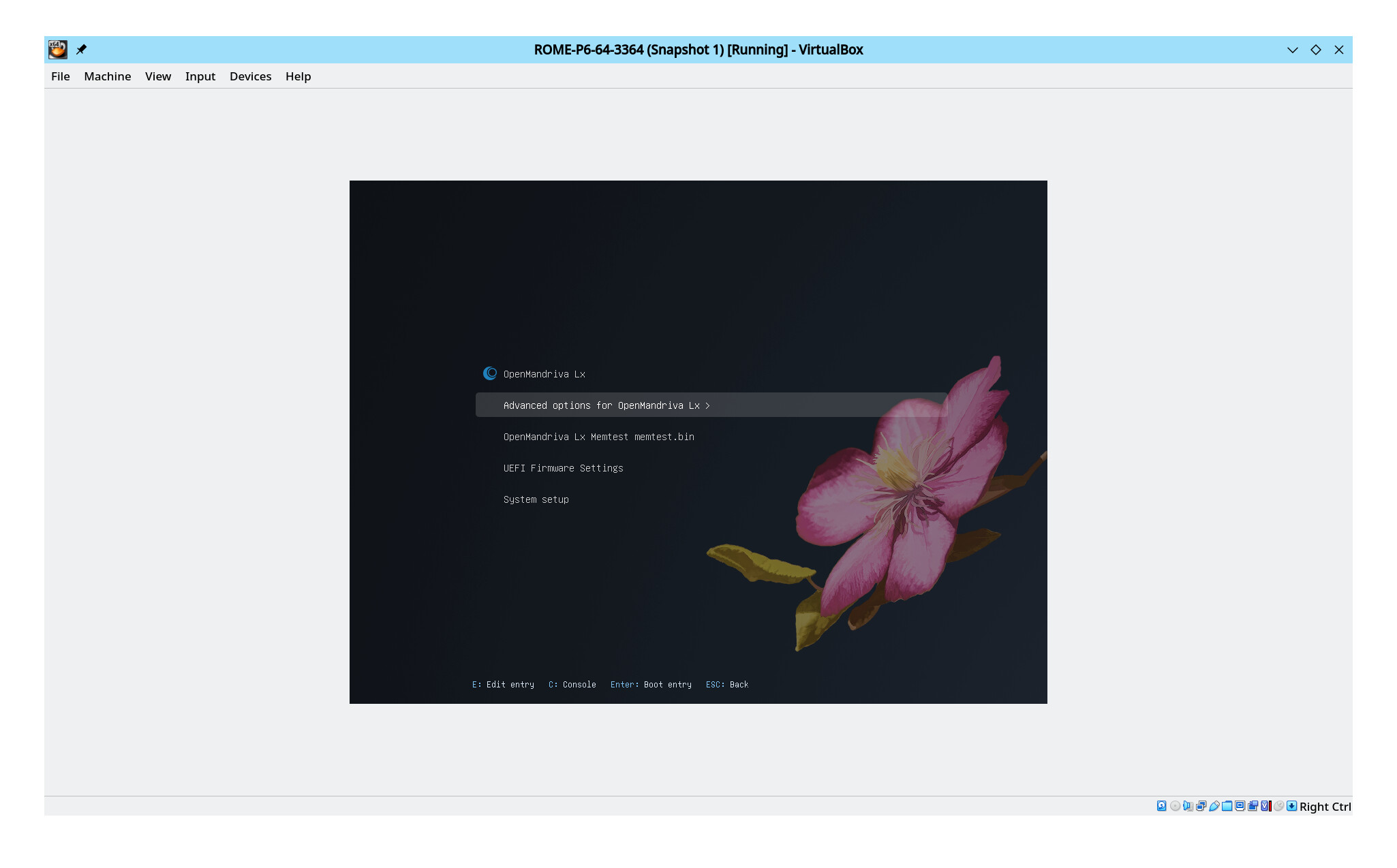

Upgrading ROME(rolling) after Nov. 9, 2025 upgrade
This part is essential and would not be obvious to a new user:
Boot system in console mode and login at the prompt >>> Important you are booting in to console mode from Advanced Options line in the grub menu not booting in to your graphical desktop.
But there is more than that so read the whole thing.

@blazini36 No you do not want to do this upgrade from graphical desktop. Console mode is found in your grub2 menu under ‘Advanced options’.

No. You reboot in to Console Moded, see the screen-shots. I seem to be failing to explain this adequately. See the screen-shots. If you do this from tty do not use tty 1 or 2 use 3, 4, 5, or 6.
