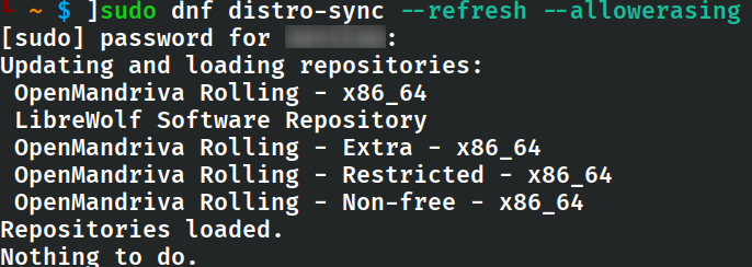

@rugyada hey, I just updated and got om-welcome-2.9.3-1. Thanks for all the work! While I was in there, though, I poked around and happened to click on the repo picker… and it says:
even though I’m on ROME:
In the Repo Picker, I checked if the Extra, Restricted, and Non-Free were enabled if I happened to be on my correct Update Channel, but when I went to ROME, it gave the typical warning:
I feel like there is an error somewhere. So I ran dnf distro-sync, and it’s showing right:
@P_J I don’t think you should point the Update Channel to Release. It should point to ROME.
I agree, @WilsonPhillips. The issue is that the repo picker is saying that I am on Release, when I am on Rome. Also that it says I only have Main enabled, when I have all three other repos enabled, in reality, as seen in the terminal output.

To reiterate. I have not changed anything. I changed no update channel. I started on ROME and have never changed any update channel to be on any other channel. After distro-syncing this evening and getting the latest version of om-welcome (2.9.3-1) I started and browsed through the welcome screen just to see as I usually just try things out. That is when I saw in the repo-picker that it said I was in a different update channel. But as shown in the terminal output, I am not in any other channel called release or elsewise.

EDIT: I removed it to check if that had, indeed, created a problem. After removal, and running repolist again, it showing that there were no other than the standard repositories, I started om-welcome, went to repo-picker, and it still showed the incorrect update channel.
Okay. I restored symlinking of dnf to dnf-3 (instead of dnf5) in /usr/bin. Then went back to the repo-picker. It now showed correctly.
So, dnf5 is not showing the information that repo-picker understands to display the correct information. I apologize for calling an error when it was my own.
