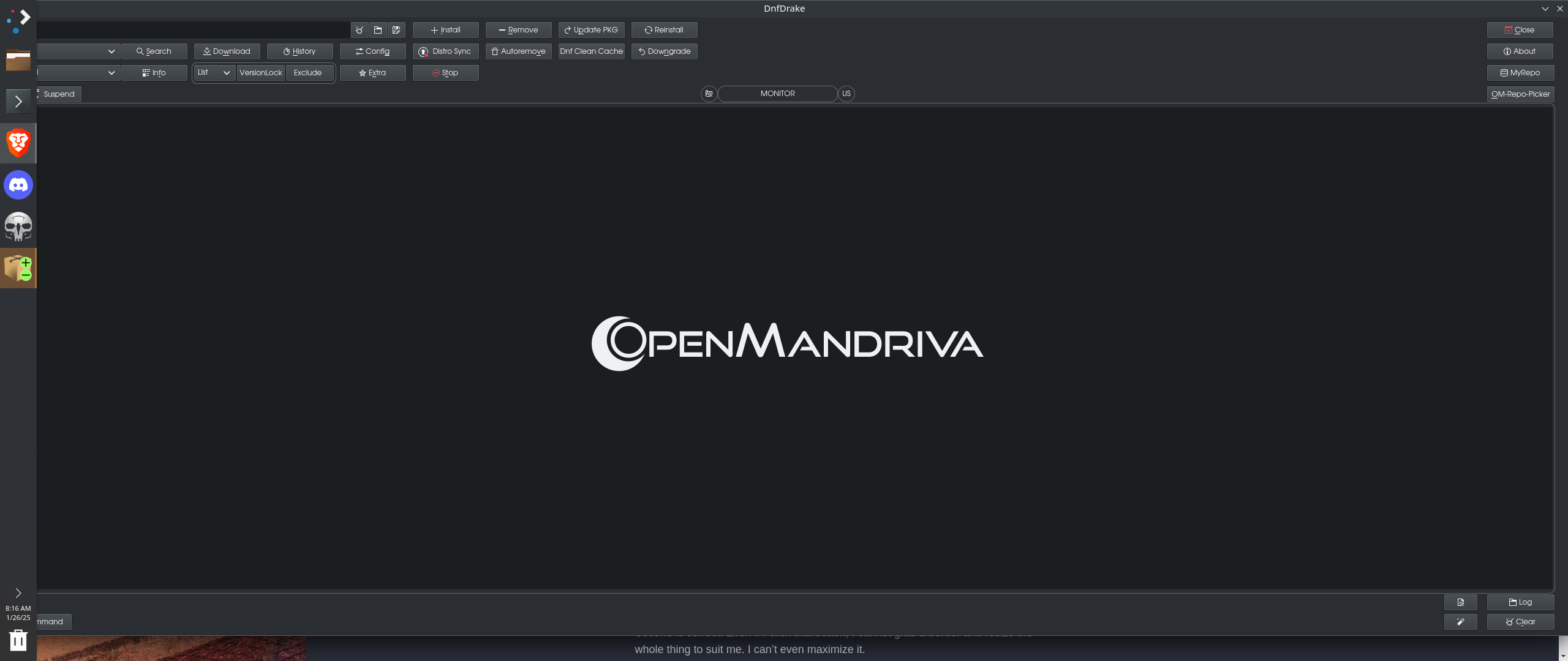

Second is correct. Even if I click that button, I cannot grab a border and resize the whole thing to suit me. I can’t even maximize it.

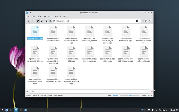

back to testing the Brave Browser thing again, you would need to:
sudo dnf remove brave-browser
(if already installed whatever method you did)
delete or move this file if existing
/etc/yum.repos.d/brave-browser.repo
Test install :wink:
DNFDrake seems to ignore the task bar position. Yes, I have the task bar on the side, because I would rather give up some space there on this ultra-wide monitor.
