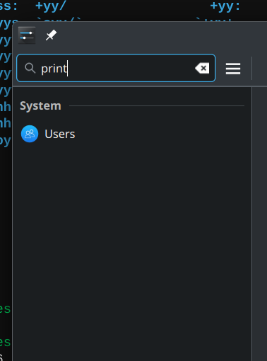

I noticed that the printer section of system settings is missing for me.
Further, when I run kcmshell6 kcm_printer_manager I get the following error message: Could not find plugin kcm_printer_manager.
I’ve tried looking around online to resolve this issue, but so far I haven’t had any luck getting this to work as I would expect. Note that I have the following package related to “print” installed:

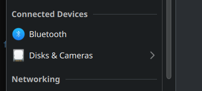

If you go into System Settings and scroll down to the Connected Devices section, there is no Printers item on the left side of the window?
Nope.

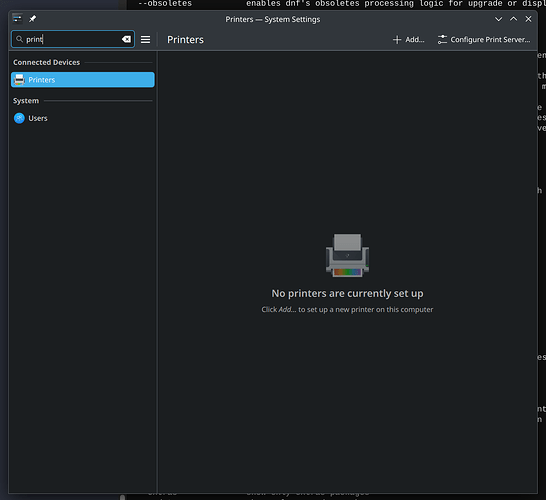

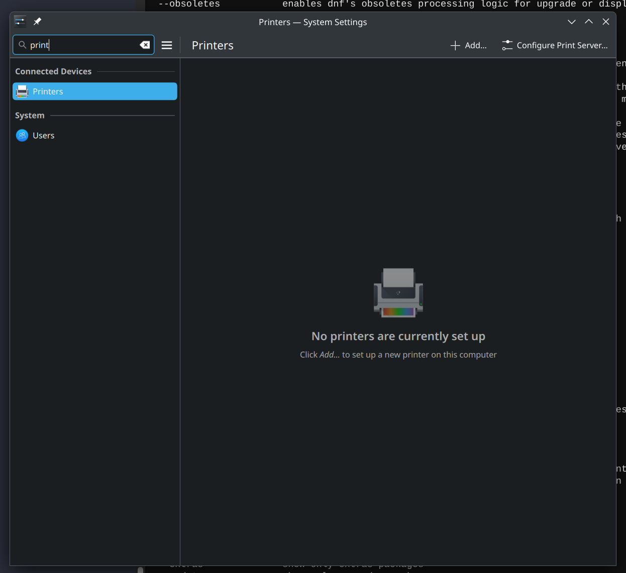

kcmshell6 --list |grep kcm_print
dnf search plasma6-print
Repositories loaded.
Matched fields: name
 plasma6-print-manager.x86_64: Print manager for Plasma 6
Make sure that is installed.
It should be plasma6-print-manager
Install it.
In command you may have to add --allowerasing
or
sudo dnf swap print-manager plasma6-print-manager --allowerasing --refresh
I’d suggest to try some of them and if you get any doubt post the console output here
(abort the transaction of course)
It probably should be installed by default with plasma. Even the slim version.

Just verify in the same Settings (under About this System) that you are using Plasma 6 and all those dependencies should be okay to remove.
Yup, I did and went through with removing print-manager and installing plasma6-print-manager and success!

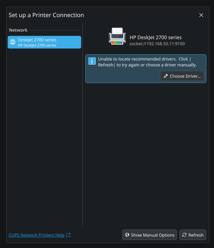

Now though I need to determine why it’s not automatically recognizing the printers on my network for set up. I have the following installed for my HP printers:
task-printing-hp.znver1                            4.0-7                     @rolling-znver1
task-printing-server.znver1                        4.0-7                     @rolling-znver1
