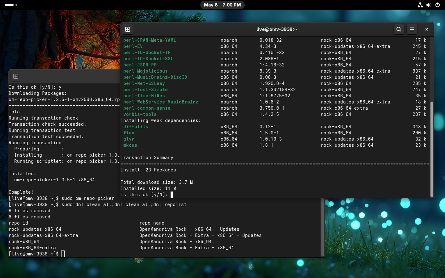

Ok looks like you have the repository properly configured.
Open Repository Selector and enable Extra. Then refresh the dnf cache.
Install your abcde package.
9 file rimossi
0 file rimossi
id repo                         nome repo
opera                           Opera Browser
rock-updates-x86_64             OpenMandriva Rock - x86_64 - Updates
rock-x86_64                     OpenMandriva Rock - x86_64
rock-x86_64-extra               OpenMandriva Rock - Extra - x86_64
sudo dnf install abcde

I think I know why..
It’s missing the extra updates
sudo dnf --refresh --enablerepo=rock-updates-x86_64-extra install abcde
after
i was able to install abcde without switching to release
want me to show the repolist now?
Yes
here it is
id repo                    nome repo
opera                      Opera Browser
rock-x86_64-extra

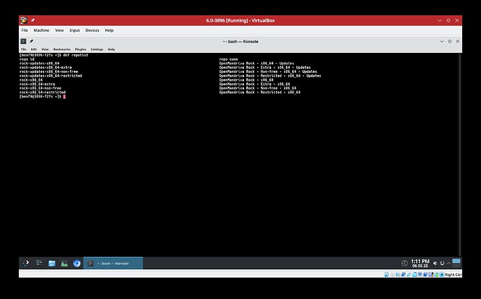

Friendly reminder:
Never change the release channel, unless you are absolutely sure you know what you are doing. It will break your system.
If you need a package that is available in testing, we can give you a command to grab it without adding a repo that will break your system. :grinning:
In Rock every repo category has both a main and an update repo so like this:
So if you used some application that enabled extra and did not enable extra/updates that application has a bug and must be fixed. If you did this manually then consider this part of your education. This applies only to the OM point release called Rock. Updates repos are not used for ROME(rolling) and Cooker. But if you use Rock you must have enabled both the main and the updates for each of the 4 repo categories that you use.
Hope this is clear and hope it helps.
It is a lot easier to help you do something than it is to fix something broken.
