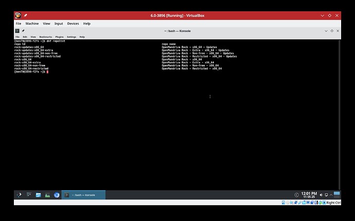

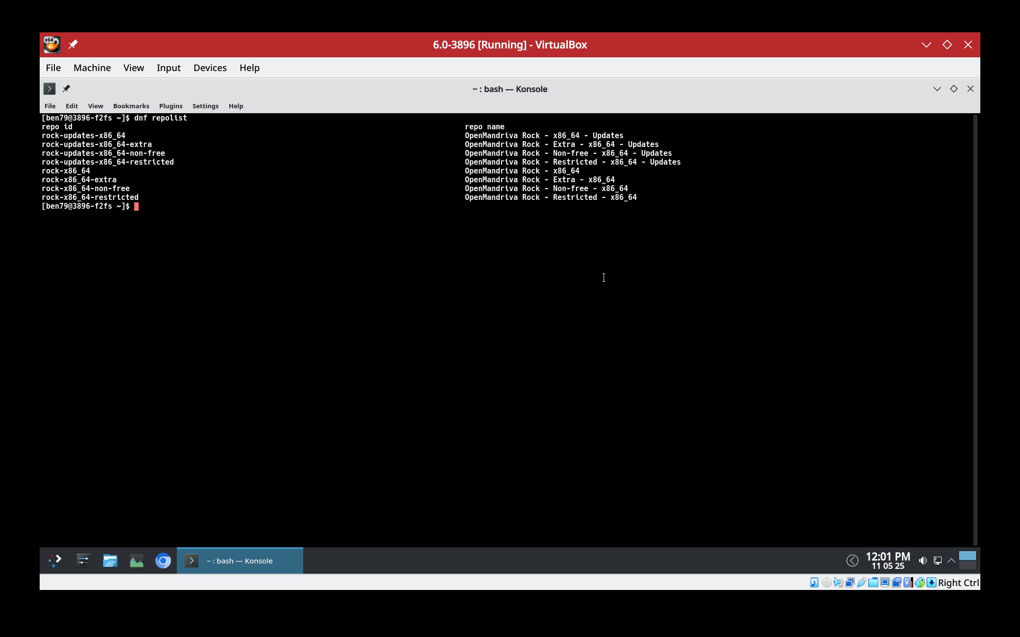

I do not run Rock, but those repos don’t look right. Can you please post the output of
dnf repolist
You are not posting the whole thing, so I cannot see what command you ran to get this.
Nevermind. I see your name is bash. :disappointed:
So, uninstall the version you have now. Then run the command.
You are missing the Updates repos for Extra, Restricted, and Non-Free, that won’t work well at all. Updated packages for Rock are in the Updates repos.
Your repolist should look like this:
I gave you this command yesterday to run that would rebuild your repo files. Did you run it?

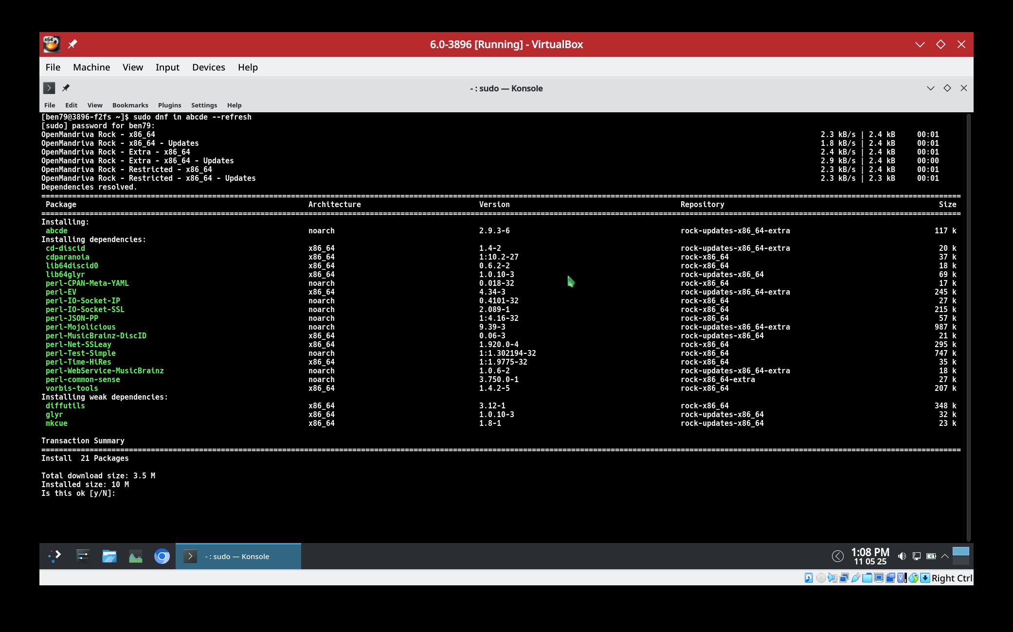

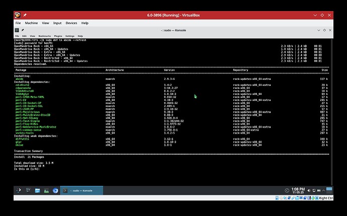

sudo dnf reinstall distro-release-repos
I look in ABF and I do not see where abcde-2.9.3-6 was ever published to Rock. Not sure what the heck people are talking about.
Edit: I’ll see if I can backport that right now.
I see it here @ben79

That was ROME(rolling) not Rock. At any rate in git 6.0 had files for abcde-2.9.3-5. So I updated the files and built the package and:
So package is built of 6.0, it installs, whether it works is to be determined by someone that actually knows what this software is for.
@247 note the repos in use for this abcde install. I don’t use non-free repos normally. That is for the poor sad souls with nVidia hardware and other non-free stuff.
just for clarification, the command is the one you gave me
sudo dnf install --enablerepo=rock-x86_64-extra abcde --refresh
and dnf repolist is exactly in that message, i included it already :slight_smile:
now give me a second and i’ll read all the other messages :slight_smile:

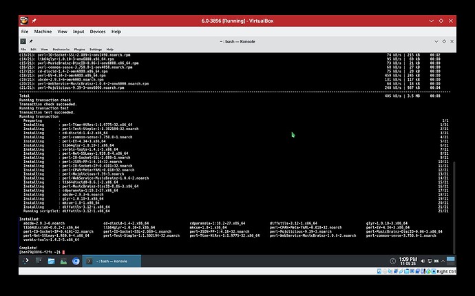

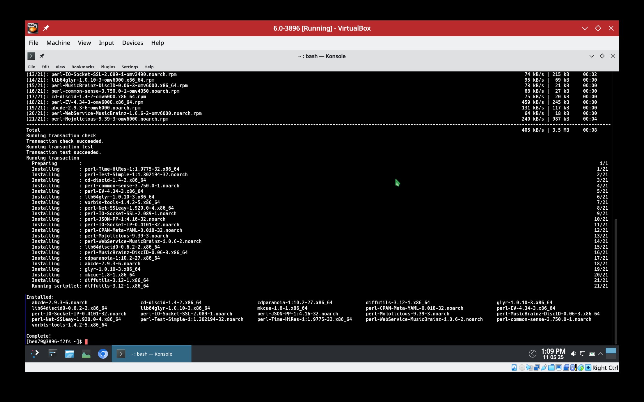

hello, and thank you, now that you backported the app to rock, i have finally updated it :slight_smile: i’ll try how it goes :slight_smile:
ok, tried it, and while i thank you for the update, making the cue file (-1M -o flac) still gives me a
/home/legacychimera247/abcde.0701c002/track1.flac: ERROR: while parsing cuesheet "/home/legacychimera247/abcde.0701c002/cue-0701c002.txt" on line 4: CD-DA TRACK numbers must be sequential
*.flac: ERROR: reading metadata, status = "FLAC__METADATA_CHAIN_STATUS_ERROR_OPENING_FILE"
The FLAC file could not be opened.  Most likely the file does not exist
or is not readable.
