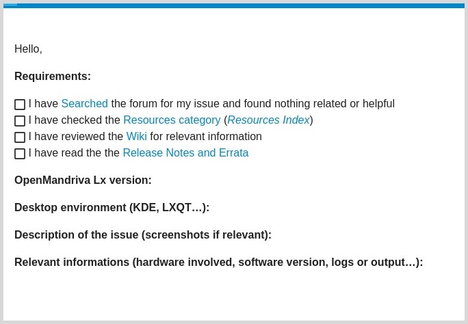

How to get better results when posting about problems
Please fill in the requirements in all your support requests, they are there for a reason :wink:
The most important info are OM version and Desktop. The more you provide, the less boring repetitive questions we’ll ask you (because yes, be sure that good willing people trying to help will ask you them)
Now, if you wish we to guide you on repair the repository mess please post the console output.
If instead you prefer to try by your own (for your fun and/or satisfaction) then do, and tell us what you did step by step.

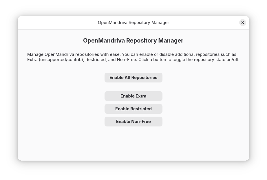

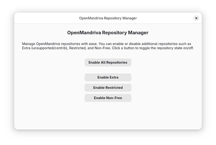

i was just going to check on tears of mandriva, i checked and there you can enable free, restricted and nonfree repositories, i don’t think these have something to do with cooker, unless clicking the “enable all repos” button enable every repos from mandriva, in which case is a bit misleading as one might think it just enables all listed repos in one click (free, non free, restricted)

i enabled those repository via this page in tears of mandriva, which was already provided and i suppose it’s a mandriva official application
i don’t have any repo picker in gnome but since this section of the app has the same things you mentioned in repo picker i assume it’s the same but for gtk
anyway, i have no problem at all having cooker repositories enabled as soon as they are safe to use (as in not conflicting with base repositories too much)
