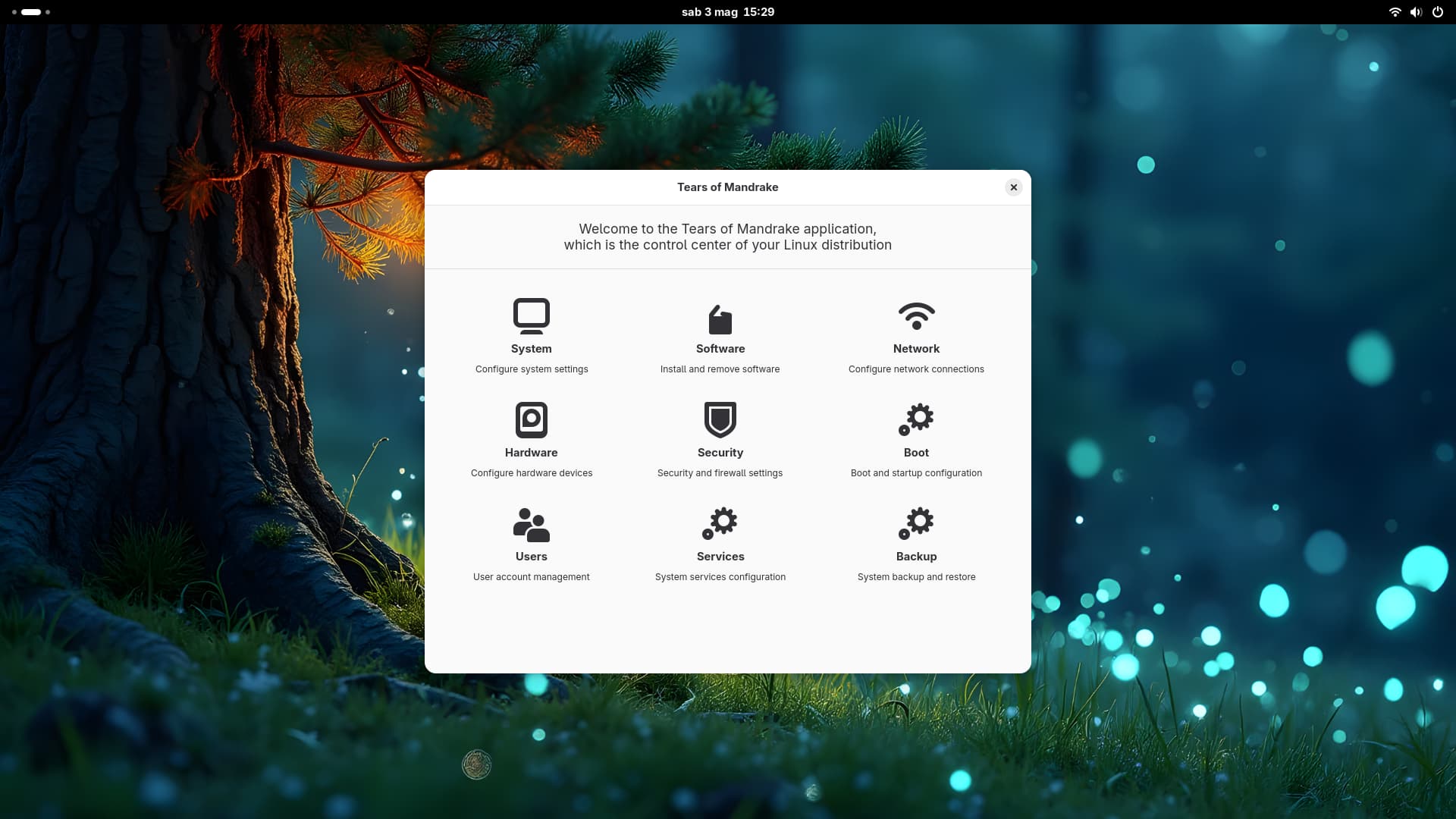

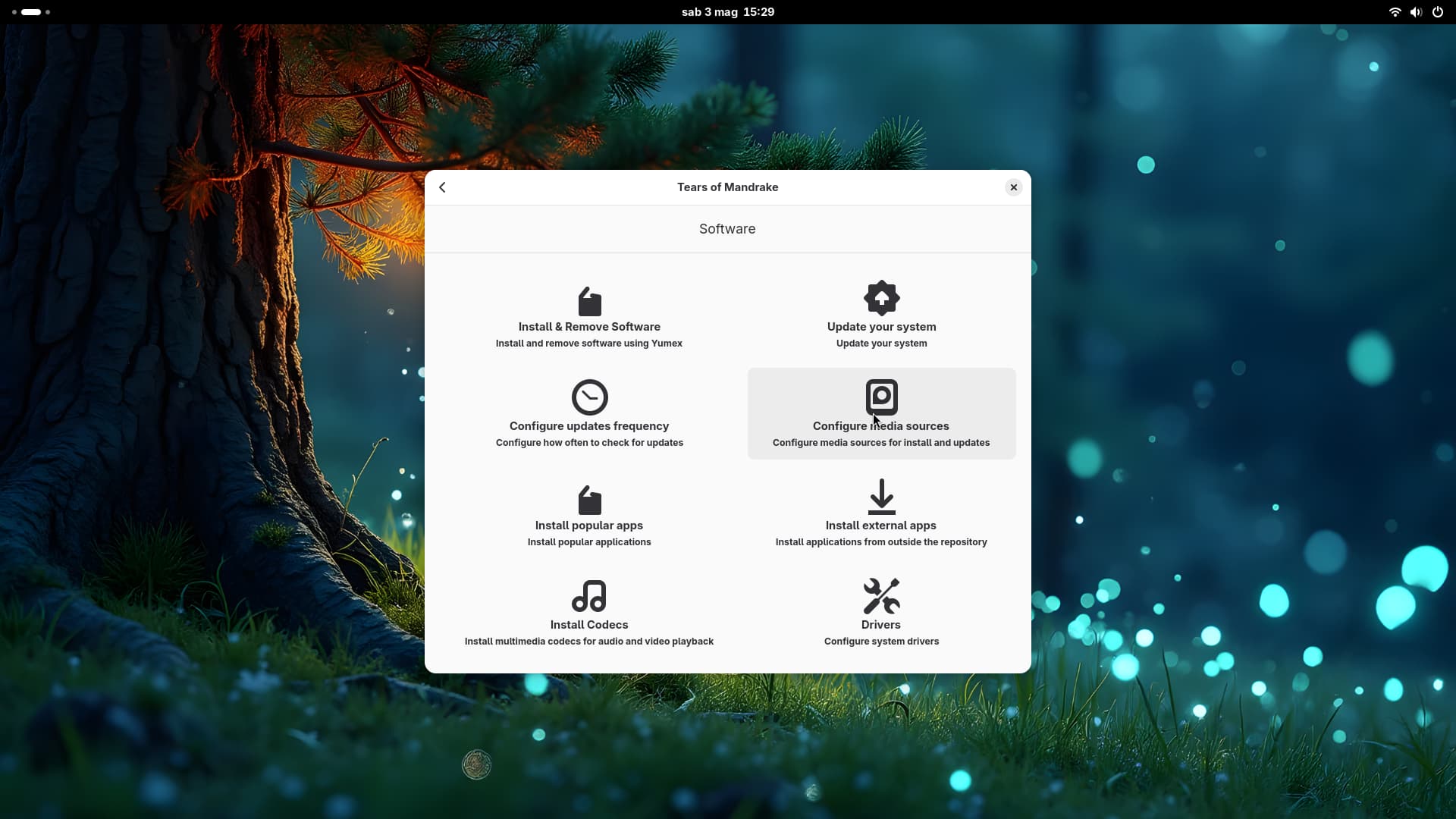

i now see your point but let me clarify that enabling restricted, non-free and extras from the app provided with the gnome spin (tears of mandrake for what it’s worth) enable those repositories but from cooker
this is the icon of the program, and as said it was preinstalled
plus the gui
