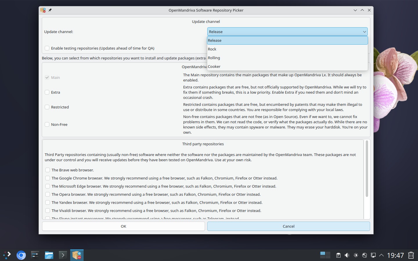

Open Repository Selector
Select Release
Ok to confirm, type your password when required (one or more times)
(Enable Extra if not done already)
Do:
you can copy/paste this command as is, no need to split it.
Then do:
sudo dnf install abcde --refresh --allowerasing 2>&1 | tee abcde-install-log.txt
Upload the abcde-install-log.txt file here

this
installed finally abcde and resulted in
abcde-install-log.txt (6,9 KB)
now, let me ask you, why i needed to change repo to release?wasn’t the "rock"repo enough?and what’s the difference?

You can leave the repositories just as they are now.
Do not use discover/dnfdragora/tears-of-mandrake/whatever any more.
