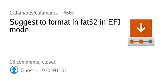

No matter who thinks what should be what, there are a few issues here that explain things:
Particularly:
Where our distro shows up and weighs in… 8 years ago…
Looking over all the closed issues may provide clues.

I provided the link to that Issue upstream so you could get some history behind it. Using fat16is not a bug, and I use it for my 2GB USB stick all the time. There is no reason for something 2GB or smaller to have a fat32 filesystem just because it’s a fat32 filesystem (i.e. bigger number means better). There are no compatibility issues now or in the immediate future that will render anything using fat16 inoperable. I would be curious to hear what you are basing the information on.
See the previous paragraph.

The links in #607 - Suggest to format in fat32 in EFI mode - Calamares/calamares - Codeberg.org I think might be a good jumping-off point for that.
