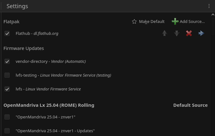

When I was using Arch, it had the same warning - “Don’t use Discover to update your distribution.” I didn’t, at the time, un derstand why. After trashing my system, I totally got it. Then I swtiched to OM. And again, the same warning from various people. So that then begs the question, why does the KDE team spend any time on this app if it doesn’t work? Also, does the OM package maintainer for the KDE discover package (DNF) configure Discover to update OM because I see the default source in discover as OM, with a few items checked. In Arch the distro packages are nowhere to be found in Discover, which is good, I would assume.
It’s also interesting that there is a firmware section that also has two boxes checked by default. Do I keep them checked or uncheck them? I have yet to find any information on this section and how good or bad it would be to uncheck or keep checked those two items.
For Flatpaks, the Discover tools seems to work just fine, so that’s all I use it for. But I still don’t understand underlying issues of using it to update my firmware and/or a distribution.

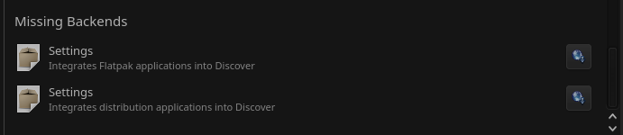

Also, way at the bottom is this section:
I’m not sure what to do about these two. It appears Flatpaks are already integrated into Discover, so why is it saying that it’s missing the backend for them. Very confusing. This bug report seems to have been fixed, yet here it is in OM. Not fixed or rebroken?

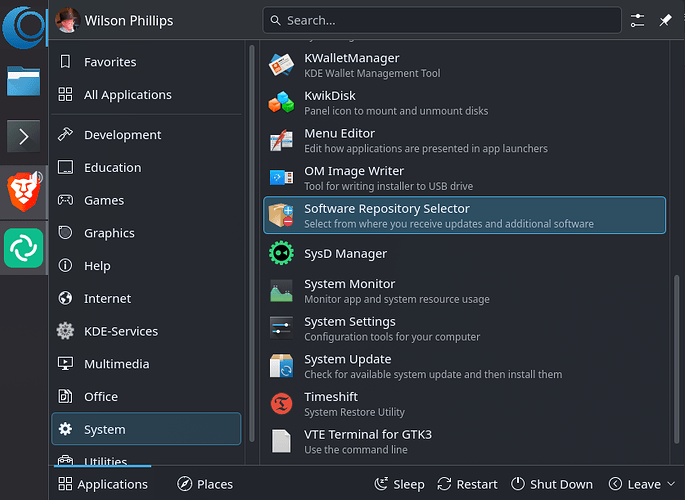

lvfs - Linux Vendor Firmware Service is the one that gives you bios updates. I have that one checked and Flathub checked. That’s it. Ignore the ones below. The only safe way to modify those is in the Software Repository Selector.
When you update Flatpaks and you see things that you know you didn’t install those Flatpaks, you can bet they came from vendor-directory - Vendor (Automatic) I don’t have that one checked, but it won’t hurt.
I think I found a bug in something. I mistakenly unchecked everything in Discovery except flatpaks. I also made flatpaks the default. I then could not update my system and I couldn’t remember what I had unchecked. So I proceeded to the Software Repo Selector and selected the ones I had previously selected using this tool. Oddly enough, the Update Channel was now set to Release and not Rolling like it was the first time I went into it. So I selected Rolling, let things finished, then went to DnfDrake to update. All I got were errors about invalid URLs. I had to manually edit the /etc yum rolling repo file manually to fix the URLs.
