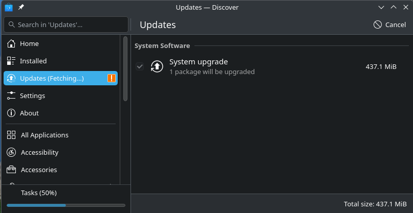

I saw this a month or two ago too & never really saw a resolution for it so I thought I’d post it (see image below). A system update appears with other updates. I allow the update to run but then it freezes & just says Updates (fetching…).
This isn’t a network issue on my side since other updates run and I have a high-speed fiber connection but for some reason this update looks as if it never downloads or installs properly. At one point it even queries for password so it can install.
Is this a known issue?

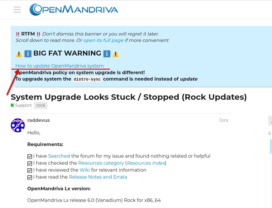

@raddevus Hello,
https://wiki.openmandriva.org/en/distribution/guides/how-tos/howto-update-system

So after I ran that script, I went and clicked the “update” icon again and I see the following again:
It never changes from 50%.
If the command from console won’t show any error or complain then I’d suggest ignore Discover.
Or better don’t use it for update.
The version of Discover that is in the Rock repo uses packagekit, which is not a very good package manager. It can do flatpaks pretty well, but I wouldn’t trust it with distro packages. If you have any flatpaks installed they can be updated from the terminal with flatpak update .

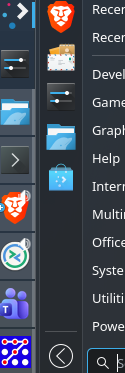

There are two confusing parts to this:
  1. Discover is located right there on the main menu by default (see image 1 below)
  2. Discover is the only app that shows that strange package update (see image 2 below)
I’m not sure why that “System upgrade” item shows up there & nowhere else. Very odd. and, apparently that system upgrade isn’t even actually available.
