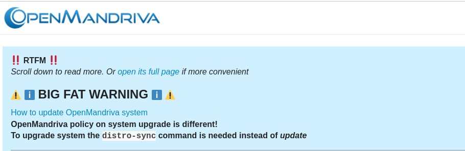

Don’t use Discover.
… I had assumed Discover would be set up to use the correct upgrade command; is this not the case??
[joshua@openmandriva-KP9USMC ~]$ sudo dnf clean all ; dnf clean all ; dnf repolist

No, this is not the case. This is a rolling release and although KDE tries to make Discover do all things, it fails. OpenMandriva is unique and has to be treated as such. Like any other rolling release, it has to be updated in a specific way. Any deviation will cause issues.
sudo dnf clean all ; dnf clean all ; dnf repolist ; sudo dnf distro-sync --refresh --allowerasing 2>&1| tee dsync2-log.txt
Each time. Every time.

The only graphical app that can update the system without breaking it is Dnfdrake.
So, do I have to install Dnfdrake? Because I looked, and apparently I do not have it. At least if I type dnf into the main menu search thingee, it does not come up. Just DNFdragora, which failed to complete an install of various programs (and in the process apparently broke CL-DNF).
Side thought: I am somewhat alarmed that what for average users is perhaps the single most critical subsystem, software and update management, which should be singularly robust, is instead rather… fragile.
From what I was told yesterday or the day before, dnfdrake does install by default now, but flatdrake does not, yet, for some reason. I don’t understand all I know about these things. Anyhow, on an older installation, you do need to install dnfdrake. It is a one click install in OM-Welcome or
sudo dnf install dnfdrake --refresh
I have not seen dnf broken. Mine works fine.
OM package management is very robust not fragile at all. The problem was with Discover and Discover has been problematic for a lot of distros. The historical problem with Discover (and dnfdragora) in OMLx was that it used the wrong command to do system upgrades for Cooker and ROME.
That said today I see do not any problems with installing and removing packages with Discover or dnfdragora. And I am one the tests these things. Also I believe @bero has fixed the problem with system upgrading in Discover so that it uses the correct command. I am just getting ready to upgrade some systems with Discover and I will see how that goes. Edit: To my knowledge dnfdragora still uses the wrong command for system upgrades for Cooker and ROME, There are people working on correcting this.

IMO: No that is a mistake. The problem is not with OpenMandriva package management the problem is the stupidity of including as default package in installs of OMLx systems software that allows users to upgrade their system yet the software does not use the correct command. I have argued against that literally forever. Obviously my view did not carry the day on this. Thus I have been stuck trying to explain about this literally for years. And it does make OpenMandriva look bad. The idea that you include software as default software and then you are going to try to tell users not to use that software as they are used to using it shows a lack of awareness of human behavior, aka: this is stupid.
I will concede that I probably see this differently as someone that actually works with this stuff. And I am bitter because of that part about having to explain this a gazillion times.
I understand how you feel. Discover is a KDE program. It is not written by OpenMandriva. The KDE developers try to make it update different distros. For some, like Fedora, it works fine.
On the other hand, it does not work on rolling distros such as ROME, Tumbleweed, Arch, etc. There is no way they can know what is required to update ROME. They don’t hang out here. It is what it is. They have been breaking updates for years and I don’t see it coming to a halt anywhere but here.
Discover is fixed now. @bero ripped the heart out of it and made it work for us.
Perhaps part of my bitterness about this issue is users that approach this as an OM only problem. It is not and never has been as @WilsonPhillips just described. But I still believe we *&^%$# up by including this as default software. Obviously not everyone share my opinions on this.
Edit: I am in the process of testing system upgrades with Discover. I am not recommending users to do this at this time. I think I may see some things that need to be adjusted but need further testing to confirm.
