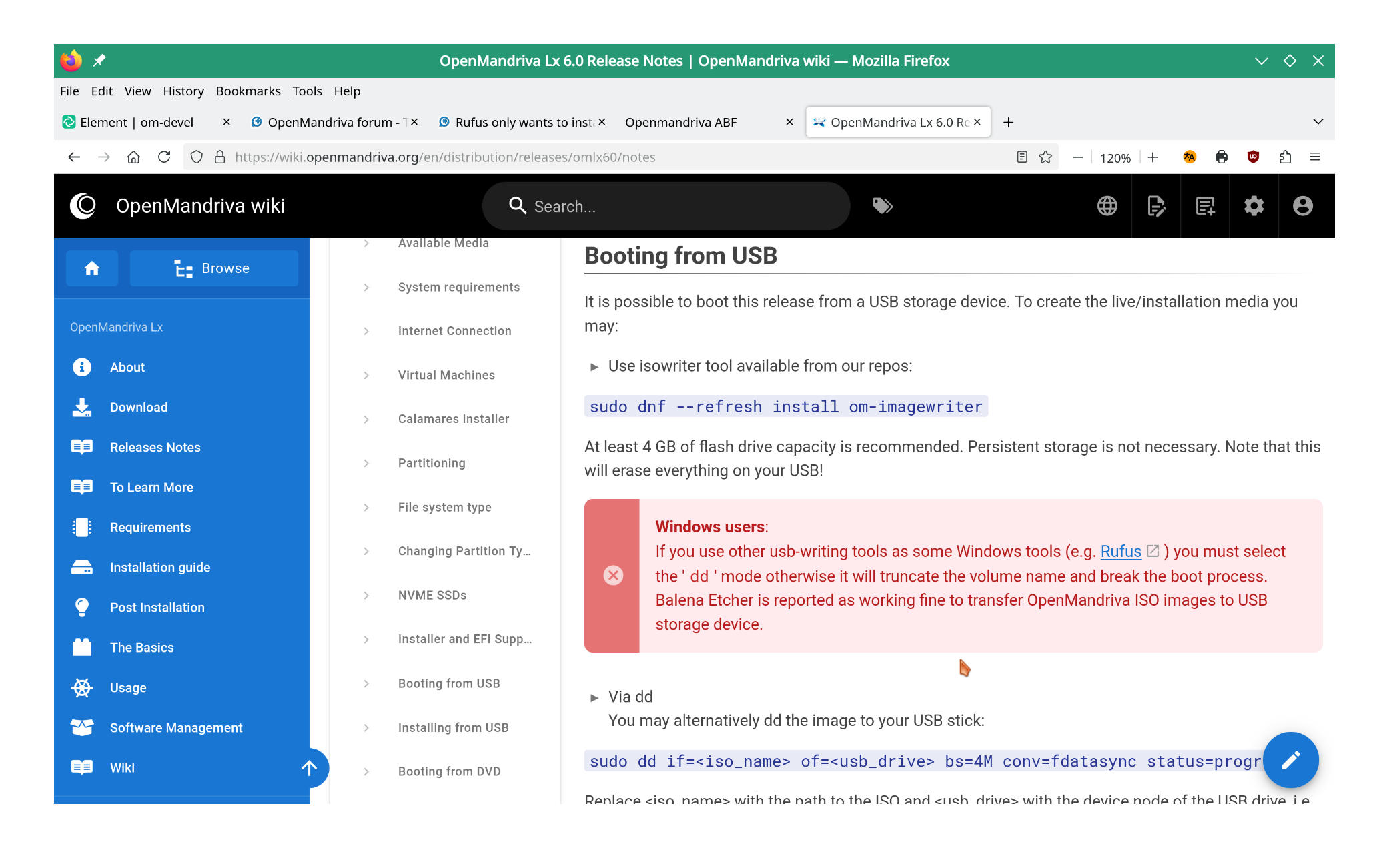

When you use Rufus, you have to specify dd mode like specified here:
By default it uses CSM compatibility and no MBR. I know, because I have a notebook that is only MBR without UEFI and it still uses UEFI with CSM.
Interesting. I only get csm-compatibility with mbr as an option, regardless if I pick DD or ISO later. Which makes it unusable on my UEFI only laptop.
