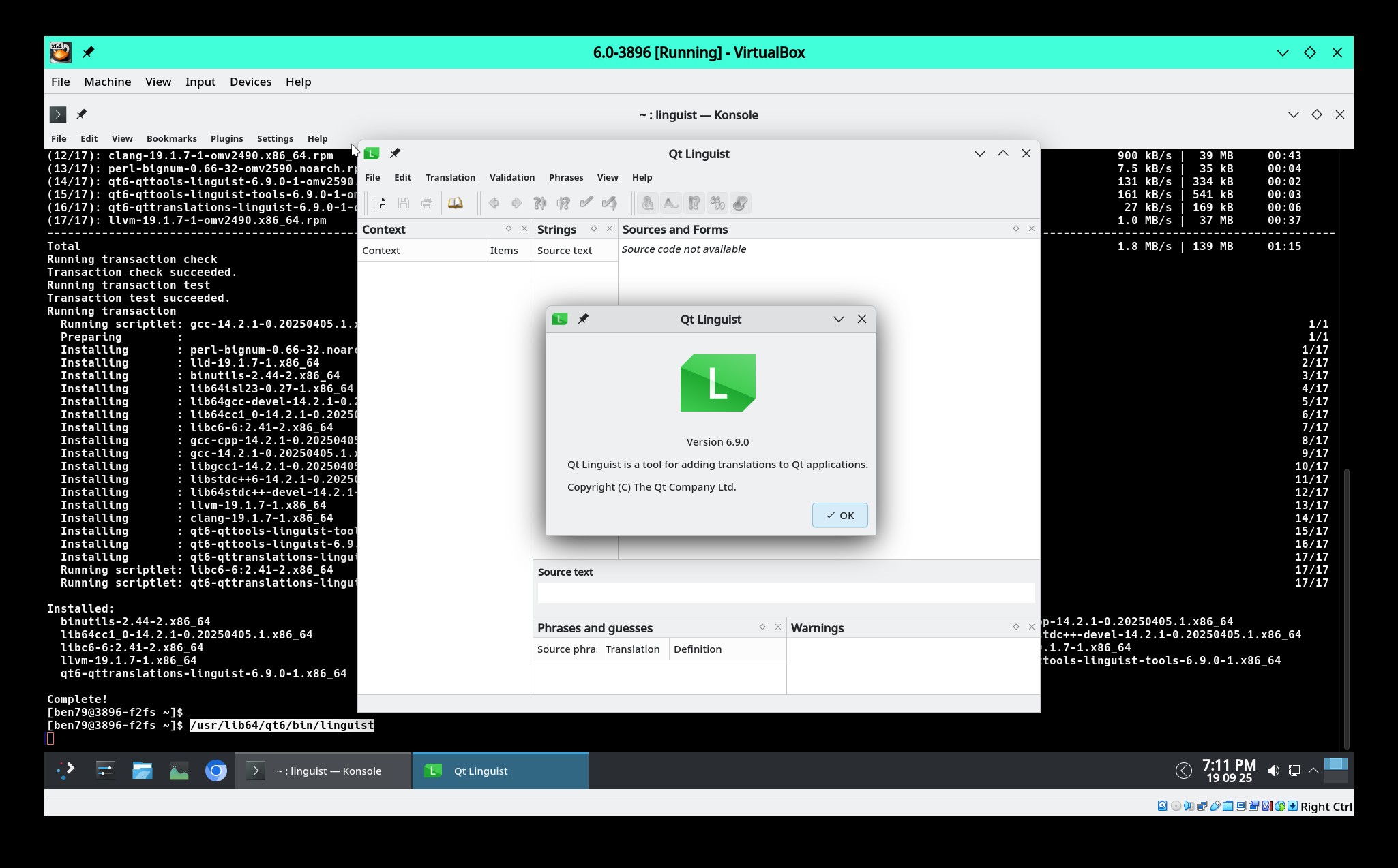

Could you see if this will run from the terminal, please?
seems like this correctly launches the application, so it’s just the icon that isn’t created i suppose…
That’s good to hear. Should be an easy fix then. Just need to make a .desktop file for the binary so you can launch it with one click.

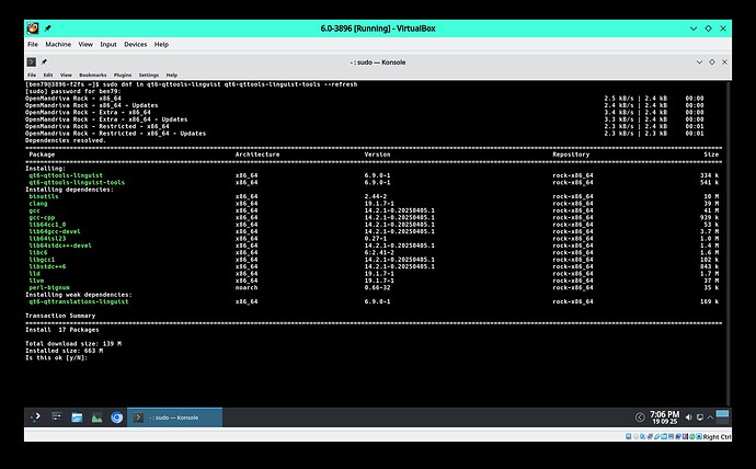

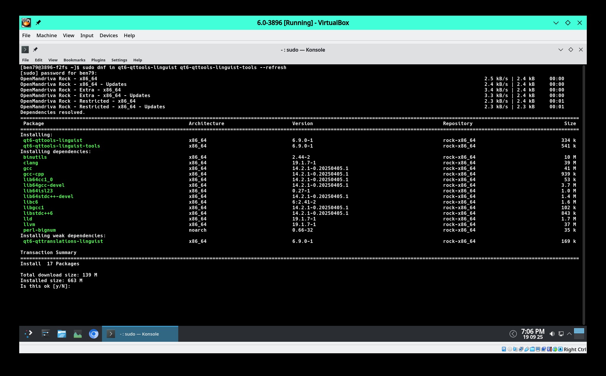

In Rock Plasma6 (should work the same in ROME or Cooker):
Install: sudo dnf in qt6-qttools-linguist qt6-qttools-linguist-tools --refresh
The command installs: qt6-qttools-linguist qt6-qttools-linguist-tools qt6-qttranslations-linguist version 6.9.0-1 plus dependencies.
Executable: /usr/lib64/qt6/bin/linguist
How do you open it? Copy and paste the executable in a terminal as user and hit the enter key.
