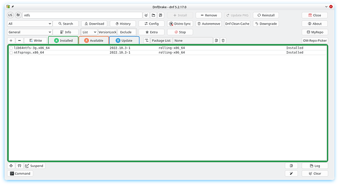

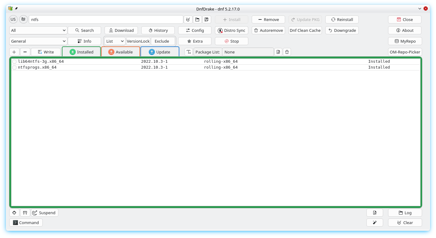

Sono installati lib64ntfs-3g e ntfsprogs?
English:
Are lib64ntfs-3g and ntfsprogs installed?
