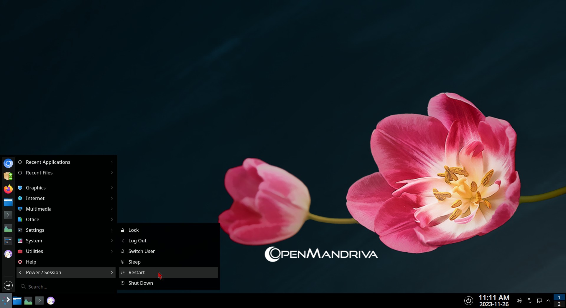

Can you post a screen-shot of the button you are referring to? Is this something you added? I ask that because a default system does not have any button that I recall for logout, shutdown, reboot, ect. There is only this in the Application Menu>Power/Session:

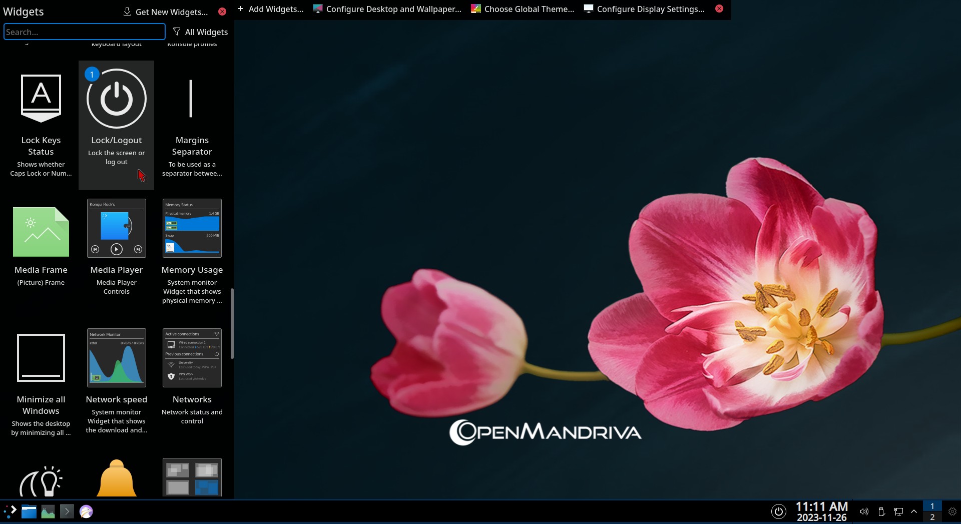

Also if the lockout/logout widget:
was added to menu panel then right click on it and add what you want or remove it and reinstall it.

Note: The second screen-shot above is a lockout/logout widget that a user can add to menu panel if they wish. A “user add”.

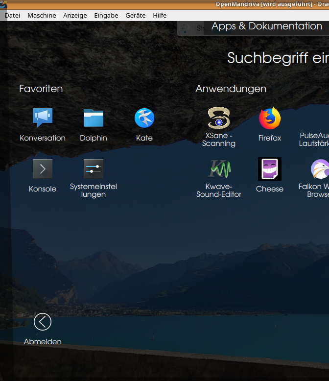

here the ScreenShot:
Only the “Abmelden” is shown on this ScreenShot.
