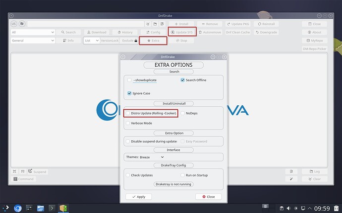

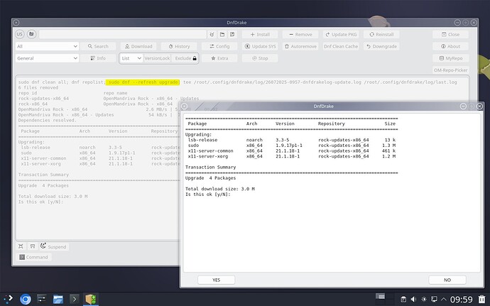

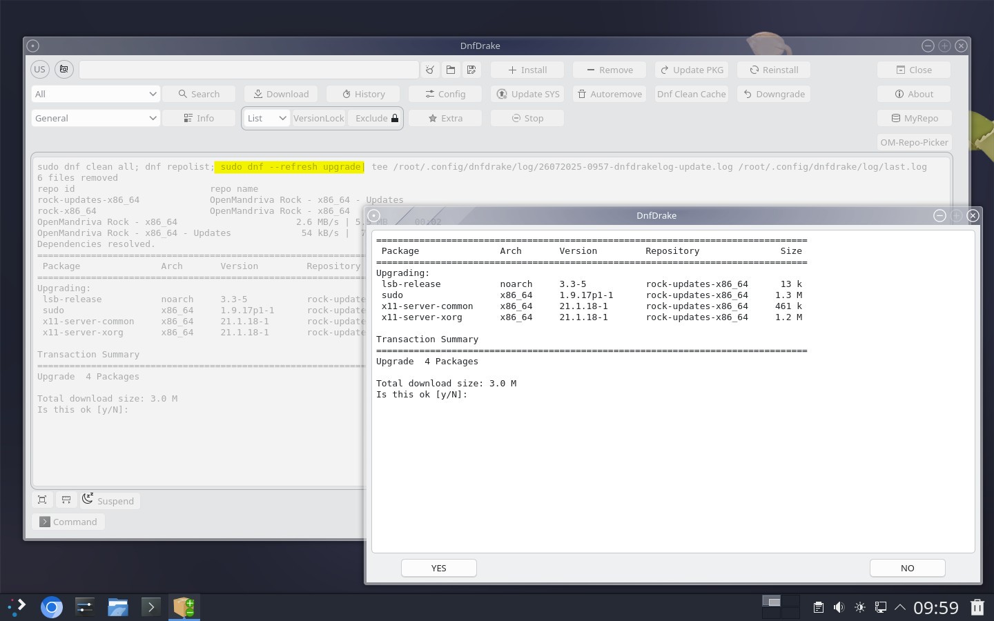

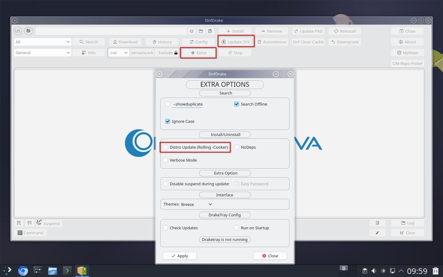

DnfDrake already does the right thing:
Doesn’t using the OML Welcome app for updates do this?
…or the “Update SYS” button in DnfDrake?

The System Update entry in the menu basically covers the required update/grade command for all releases. dnf update | upgrade is not recommended not even for Rock (this is my opinion, anyway). If you think about how someone may use Rock for a year and has learned to use dnf update throughout that time, changing that behavior will require added discipline. Not doing it, will result in a broken system. It would be best to use dnf dsync from the start.
