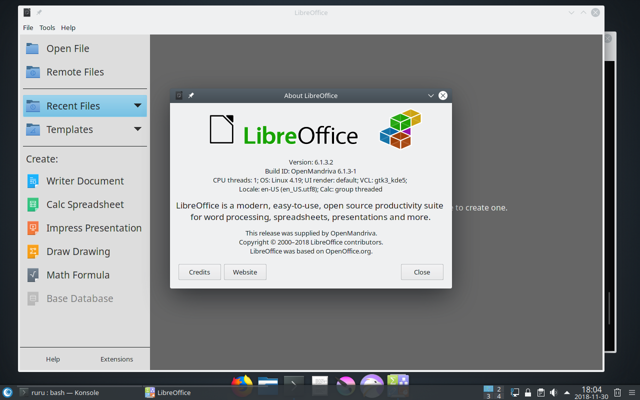

Ok I’ve been told that libreoffice-kde5 currently is optional because it has stability issues, however the users who don’t like the current default ugly look may try and see what happens
$ sudo dnf --refresh install libreoffice-kde5
Yes, that package does improve the look of LibreOffice in Cooker/Lx4.
