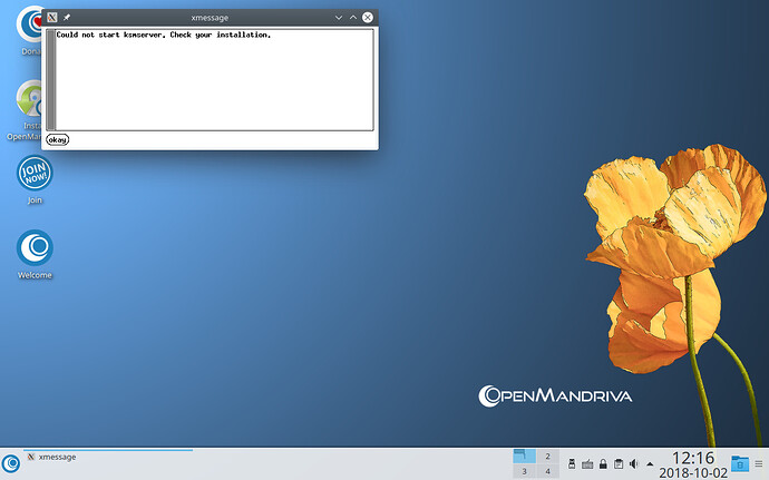

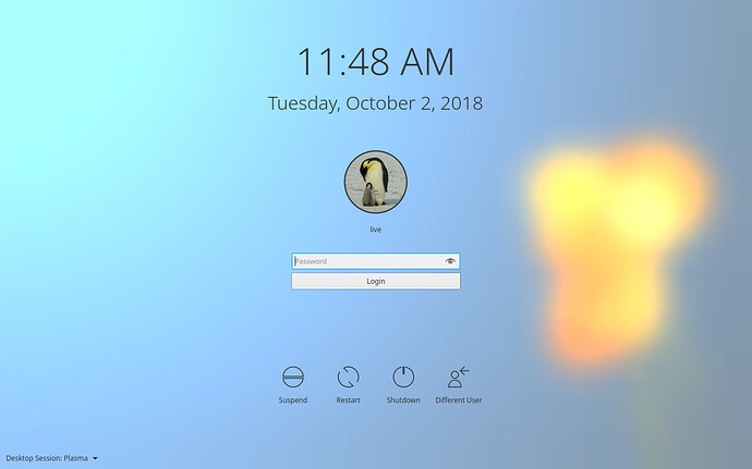

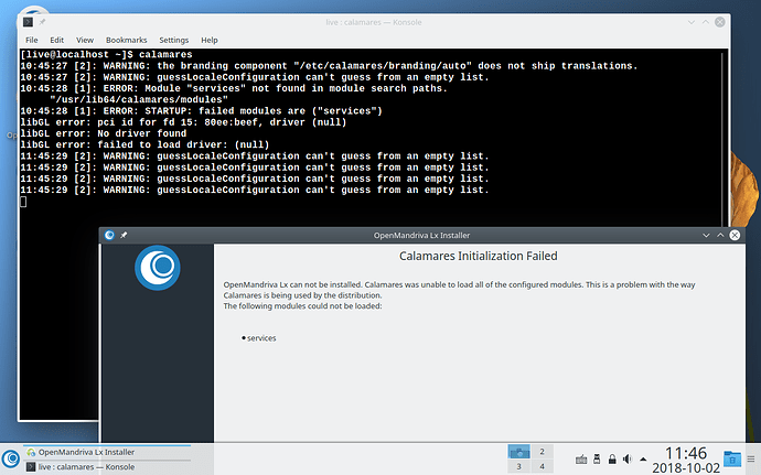

- Build 2232 still showing the “Calamares Initialization Failed" issue;
- Plasma Desktop so far looks mostly usable;
- Still very loooong time before live desktop show up (~5 min.);
- Logout/login working;
- Firefox working;

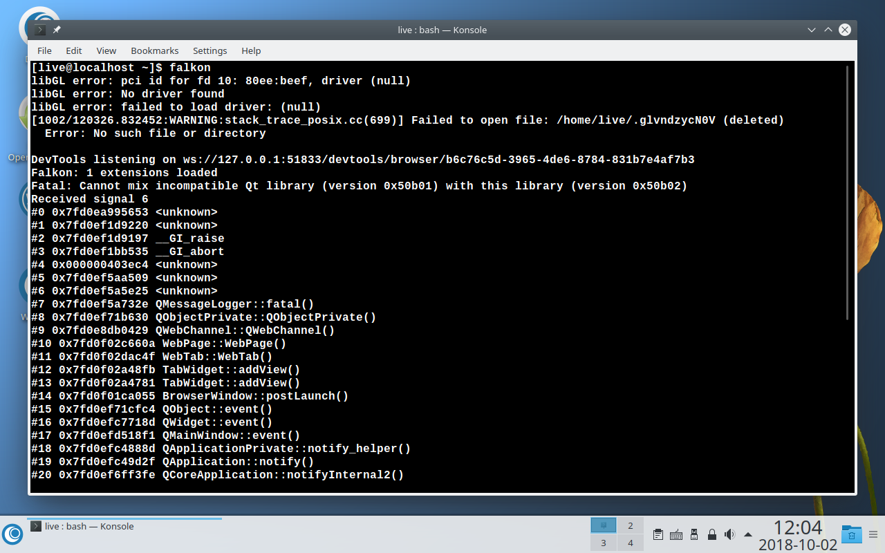

- Falkon not working;

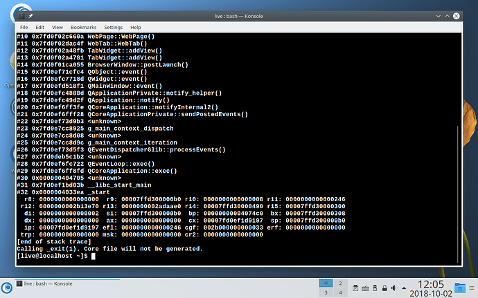

- Leafpad install test: install looks successful (sorry no screenshots) but launching the app made the desktop crash and exit, returning to sddm. Once entered, got a message error “Could not start ksmserver”;
- Libreoffice made the desktop crash and exit too.

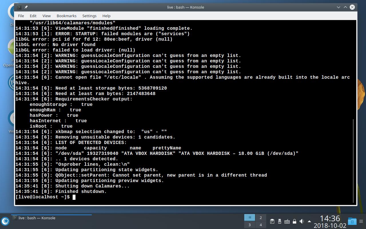

I just did a new build and can confirm the calamares issue; the services module is missing. As for the slow startup something is blocking the X server if you do ctrl+F2 (i.e. try to get a virtual console) the system will startup immediately. Doing this seems to trigger the bootup to continue.
Hi,
yes the report above is for 2232 Plasma ISO.

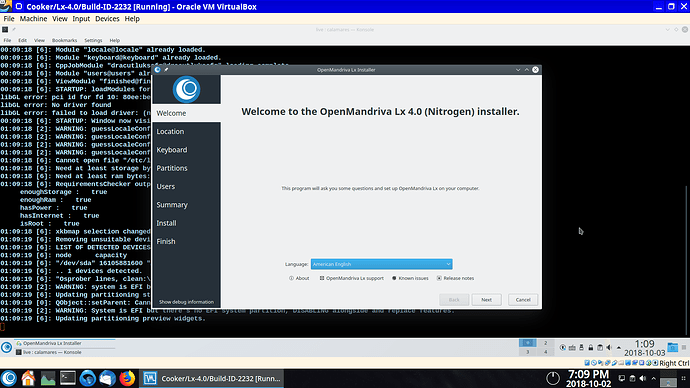

I added just now 3 more screenshots with pkexec /usr/bin/calamares -d command for a verbose output. Hope it helps.
Did not know, will try thanks.
In my opinion the calamares issue need to be solved asap, so we can test the system installed.

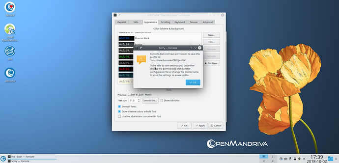

Ummm… Noodling around with it feels like things underneath still aren’t ready. Like the already noted LO crashing desktop. Here’s a little thing that should be fixed soonish.
This is because permissions for /usr/share/konsole/OMV.profile are set to 0644. I believe our users would be happier if we set this to 0744 so user can change look of their konsole. Obviously the work around is:
# chmod 744 /usr/share/konsole/OMV.profile

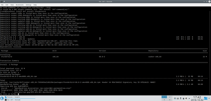

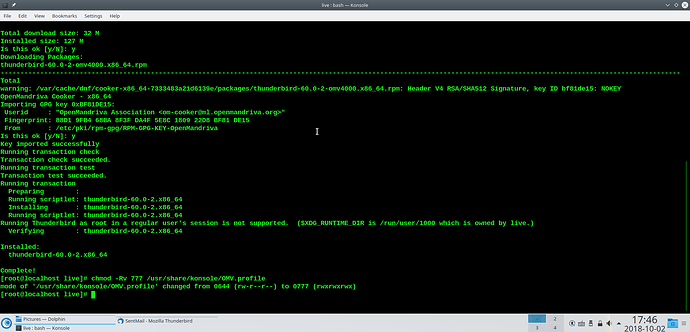

On a more positive note dnf works:
this also shows consequences of workaround for konsole permissions.
On a negative note trying to attach a file to thunderbird cashes it sending user on a search for a workaround.

To change the look of konsole just create a new profile.
Menu Settings > Manage Profiles > New Profile
Why would you want to make a konsole profile executable (644 -> 744: Afterwards executable by owner)?
Also, users certainly shouldn’t be able to write to anything in /usr/share/konsole (because that’s the system wide files used by every user). konsole automatically creates new override files in the user’s home directory when changing settings.
LO doesn’t crash the desktop on real HW (at least not on mine, Threadripper with an AMD GPU).
Alt+F2/Alt+F1 isn’t necessary on real HW either.
Maybe VB needs some fixing.

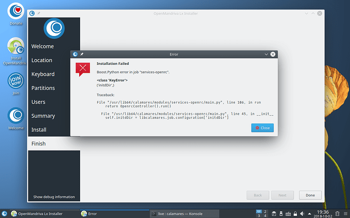

Installed calamares-3.2.2-2 in live mode.
Now better, but installation failed with the error in screenshot
Console log here
This is cause by missing typelib() requires on some g* packages on network-manager-applet, tuned, hplip-systray, firewalld-applet
This is because if broken OpenGL/EGL support.
Please run glxinfo
New calamares -3 is building, with fixed settings. If you like you can edit /etc/calamares/modules/services.conf
and remove line with - services-openrc
then you can start calamares and try to install it

That is not what I want but just what I found. What I want and probably users in general will want is simply to be able to adjust their profile without having to resort to a work around. It should be noted that the very first thing the error message says is to “either change the permissions of the configuration of the profile configuration file”. So I would say that based on what @bero says that error message should be changed.
If I was really smart I would have checked permissions on the same file in Lx 3 which are the same at 0644 as they are on the # 2232 ISO so the problem lies elsewhere. But again the point is more related to users being able to set things to their liking without having to resort to a workaround. If there has been a policy change either in OpenMandriva or upstream then the error message should indicate that. It doesn’t so at the moment at least I’m considering this a bug. Post-edit: All I want is to be able to make settings in Konsole in Lx 4.0 exactly the same as I already can in Lx 3.
And apologies if my knee jerked and I did the first thing the error message suggested as a work around. Setting a new profile is the better and safer workaround.

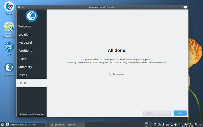

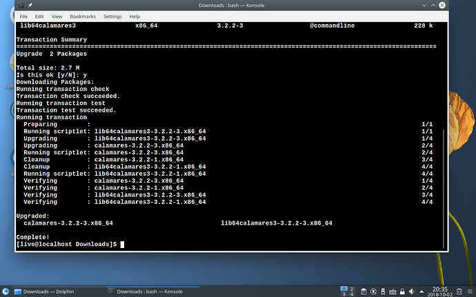

Works!
Console log here

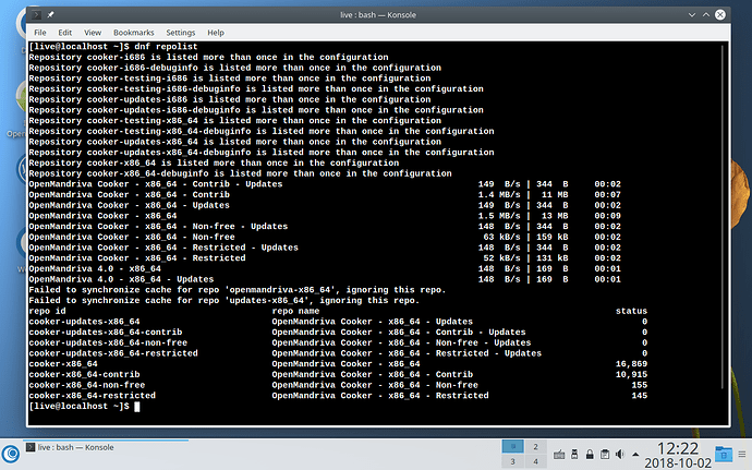

# dnf upgrade calamares
Repository cooker-i686 is listed more than once in the configuration
Repository cooker-i686-debuginfo is listed more than once in the configuration
Repository cooker-testing-i686 is listed more than once in the configuration
Repository cooker-testing-i686-debuginfo is listed more than once in the configuration
Repository cooker-updates-i686 is listed more than once in the configuration
Repository cooker-updates-i686-debuginfo is listed more than once in the configuration
Repository cooker-testing-x86_64 is listed more than once in the configuration
Repository cooker-testing-x86_64-debuginfo is listed more than once in the configuration
Repository cooker-updates-x86_64 is listed more than once in the configuration
Repository cooker-updates-x86_64-debuginfo is listed more than once in the configuration
Repository cooker-x86_64 is listed more than once in the configuration
Repository cooker-x86_64-debuginfo is listed more than once in the configuration
OpenMandriva 4.0 - x86_64                                                                                                                   126  B/s | 169  B     00:01
OpenMandriva 4.0 - x86_64 - Updates                                                                                                         125  B/s | 169  B     00:01
Failed to synchronize cache for repo 'openmandriva-x86_64', ignoring this repo.
Failed to synchronize cache for repo 'updates-x86_64', ignoring this repo.
Last metadata expiration check: 1 day, 1:50:33 ago on Mon 01 Oct 2018 09:47:41 PM UTC.
Dependencies resolved.
Nothing to do.
Complete!
# rpm -qa calamares
calamares-3.2.2-1.x86_64
# dnf repolist
OpenMandriva 4.0 - x86_64 - Updates                                                                                                         126  B/s | 169  B     00:01
Last metadata expiration check: 1 day, 1:53:53 ago on Mon 01 Oct 2018 09:47:41 PM UTC.
repo id                                                                  repo name                                                                                    status
cooker-updates-x86_64                                                    OpenMandriva Cooker - x86_64 - Updates                                                            0
cooker-updates-x86_64-contrib                                            OpenMandriva Cooker - x86_64 - Contrib - Updates                                                  0
cooker-updates-x86_64-non-free                                           OpenMandriva Cooker - x86_64 - Non-free - Updates                                                 0
cooker-updates-x86_64-restricted                                         OpenMandriva Cooker - x86_64 - Restricted - Updates                                               0
cooker-x86_64                                                            OpenMandriva Cooker - x86_64                                                                 16,868
cooker-x86_64-contrib                                                    OpenMandriva Cooker - x86_64 - Contrib                                                       10,915
cooker-x86_64-non-free                                                   OpenMandriva Cooker - x86_64 - Non-free                                                         155
cooker-x86_64-restricted                                                 OpenMandriva Cooker - x86_64 - Restricted                                                       145
You idiot try:
# dnf --refresh upgrade calamares
My brain does not grasp needing to tell dnf to refresh if I’m requesting an upgrade but that appears to be necessary.
Anyway now result:

OK, so here’s latest result with this version of calamares:
$ rpm -qa calamares
calamares-3.2.2-3.x86_64
Here is entire konsole output of ‘pkexec /usr/bin/calamares -d’:
Cooker-calamares-konsole.txt (34.3 KB)

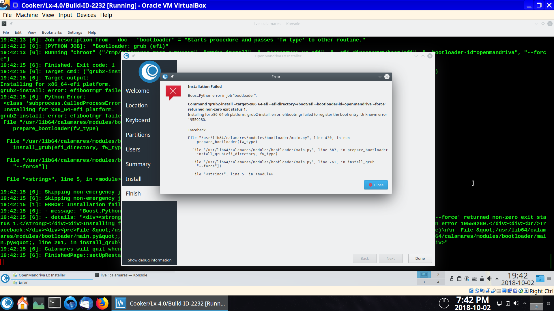

@ben79 This is very strange error:
grub2-install: error: efibootmgr failed to register the boot entry: Unknown error 19559280.
I’ve registered an issue for efibootmgr:
I’m building new efibootmgr-17 so please try with it.
I will try. This seems to be a VBox issue, I was able to install in hardware with calamares-3.2.2-3.x86_64.
