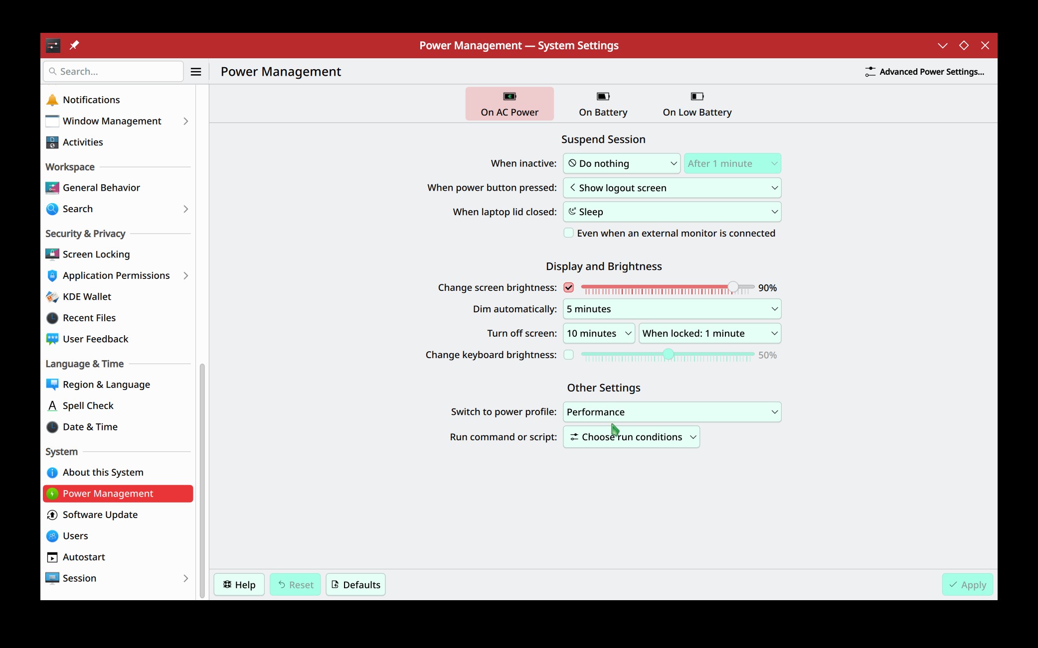

Ok, I have switched that setting to Performance on AC, battery, and low battery. To test, I will need to leave it off for a while as even before making that change it would rarely happen after immediate reboots. If the issue happens again, it may be a while before I can temporarily fix the issue to be able to use the computer and post an update here… But to verify I understand correctly, is the idea that 4 year old graphics are too new to be correctly supported in linux? Anything from 2021, 2022, 2023, 2024, or 2025 is incompatible? Or is it just this particular graphics setup from intel on that year only?

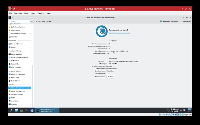

Another “next” thing to try is: We have seem some users get better results by using kernel-server-6.14.2-3 to install that:
Open terminal (Konsole) and type:
sudo dnf in kernel-server
When installed reboot and at grub2 menu go to the Advanced Options line and look for the first entry for kernel-server.

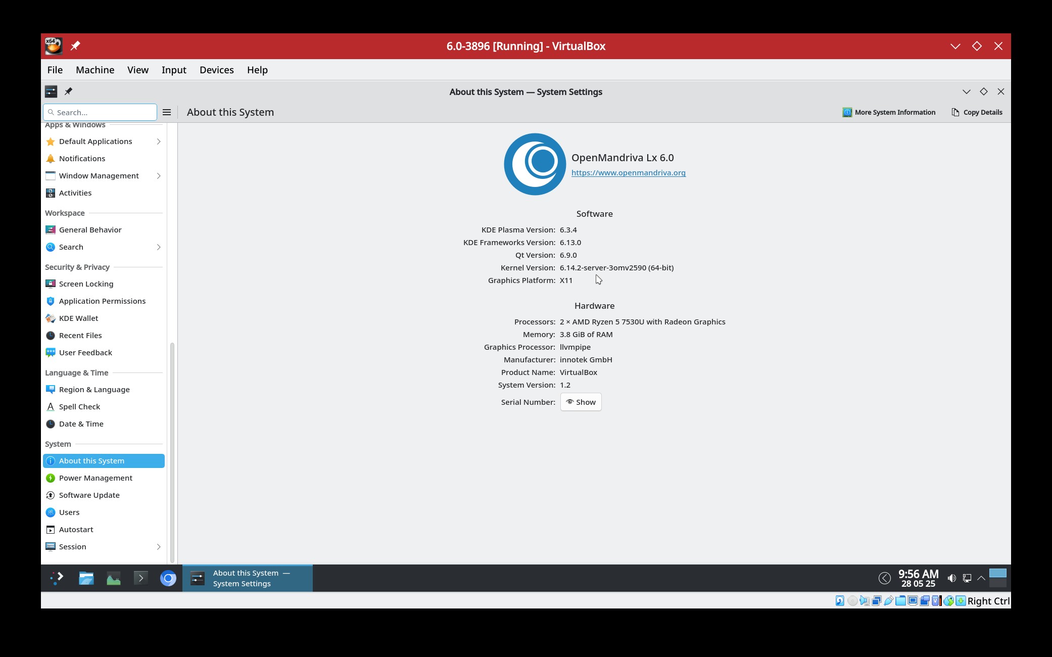

If you are referring to sudo dnf in kernel-server I just tested this in a Rock/6.0 system and it does become the default. Further you can check after booting in SystemSettings>System>About this System:

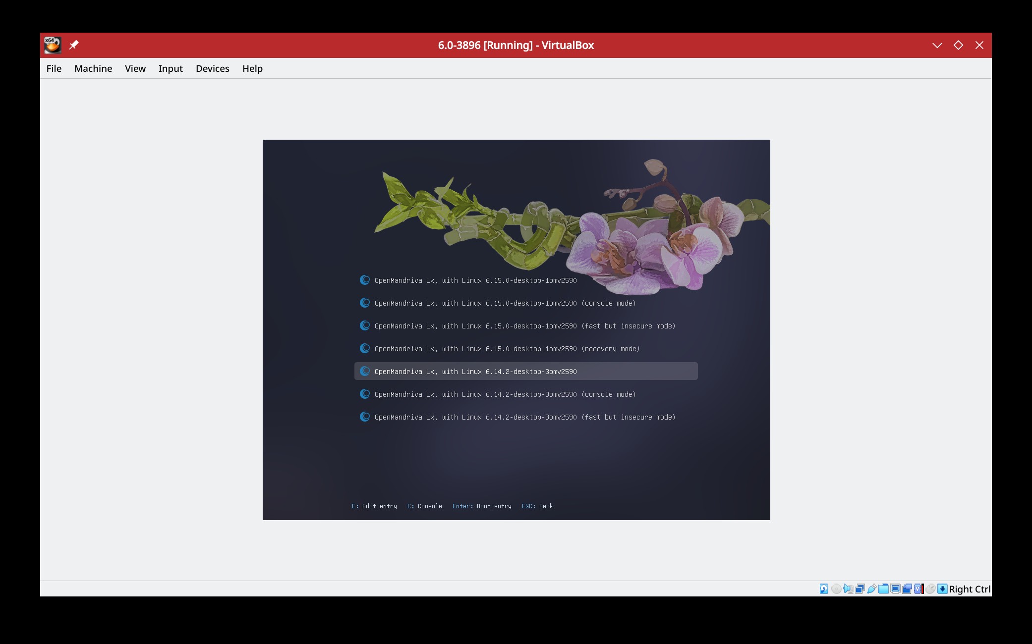

While I am explaining to find other kernel versions than the default one:
Use the up/down arrows on keyboard to highlight the one you want to boot. Note that each kernel version has 4 choices: default (graphical), console mode, fast but insecure mode, and recovery mode. It might be useful sometime to try them all so you can see how the work on your computer.
Console mode should boot to a terminal where you have a command prompt where you can login as user or root (administrator or super user) to repair a broken system.

Confirming that I did install the server version using the terminal command and that it did make that selection the new default that loads without having to be manually selected every time verified by checking the About system section. The issue did seem to happen after that though. I’m up for trying additional options.

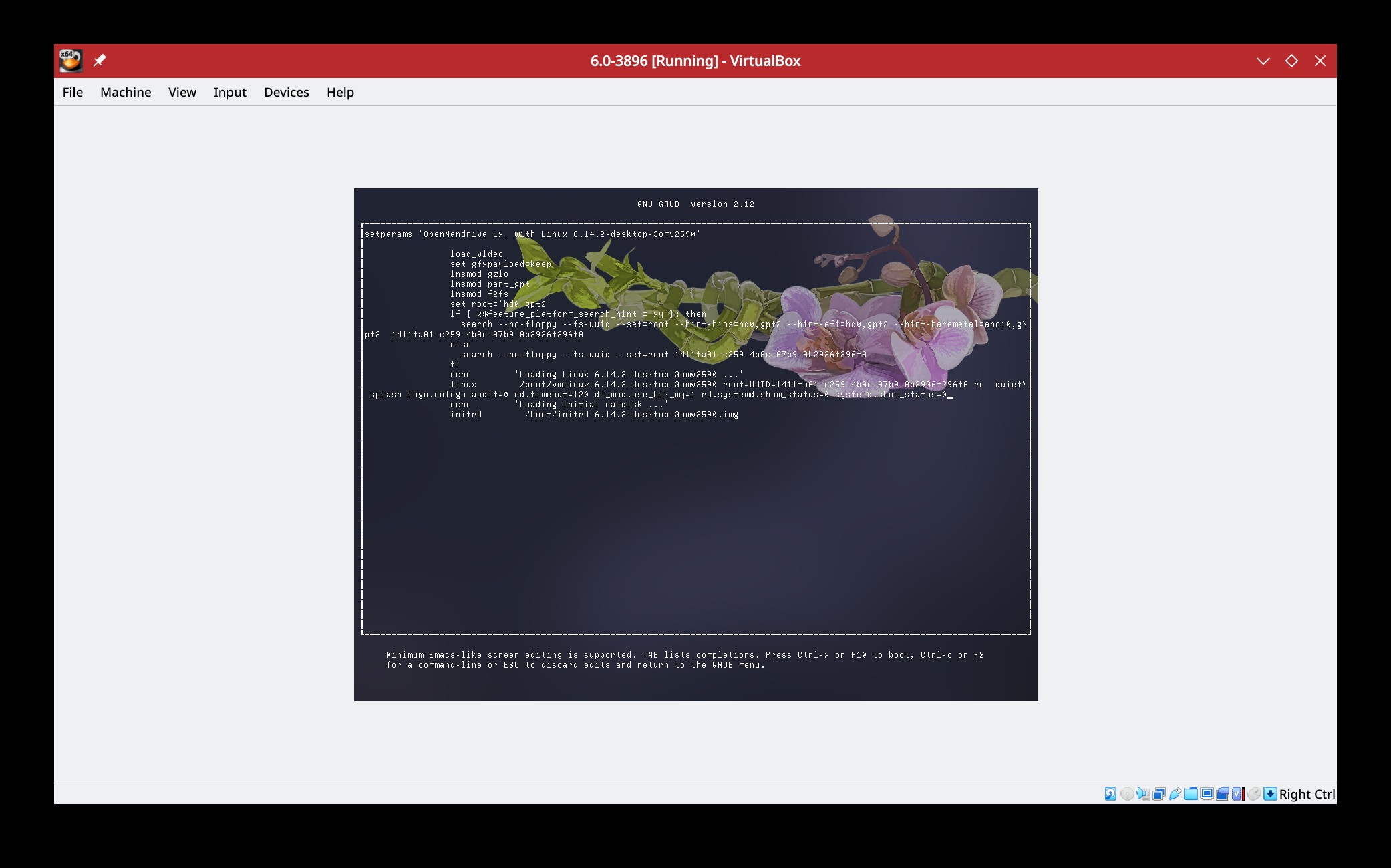

To do that we add i915.force_probe=!9a49 xe.force_probe=9a49 as a kernel parameter to whatever kernel version we wish to test boot. How do you do that? At the grub2 menu we highlight the entry we wish to test boot,
select ‘e’ for edit,
use the down arrow key to navigate to the line that begins with linux,
use the ‘end’ key to go to the end of that line,
type space followed by i915.force_probe=!9a49 xe.force_probe=9a49
Finally select F10 key to boot the edited entry.
Note that this edit applies only to the current boot so no permenent change to users system, if this actually helps we can make this permenent. To check that the XE driver is actually being used after booting type in terminal (Konsole) inxi -G. This is easier to do than it is to explain it, but do note that what you type must be exact.

First when you say shutdown to me that means power off. It is possible that with this hardware users should not use hibernate, sleep, or suspend at all. I wonder if this might apply to screen locking as well. This is unfortunate but users need to understand that we have manufactuers making hardware for the Windows and Apple where Linux, even if they claim to support it, is an afterthought. So users with this hardware using OMLx Plasma desktop may need to adjust settings in SystemSettings>System>Power Management to this:
When inactive: Do nothing
When laptop lid is closed: Do nothing
Dim automatically: Never
Maybe:
Turn off screen: Never
Another 2 maybe:
Under SystemSettings>Security and Privacy>Screen locking
Lock screen automatically: Never
And deselect "Lock after waking from sleep
I hate even making these suggestions but is seems possible that this is necessary for this Iris Xe Graphics hardware. I would prefer to be proved wrong about this…
