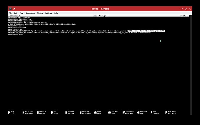

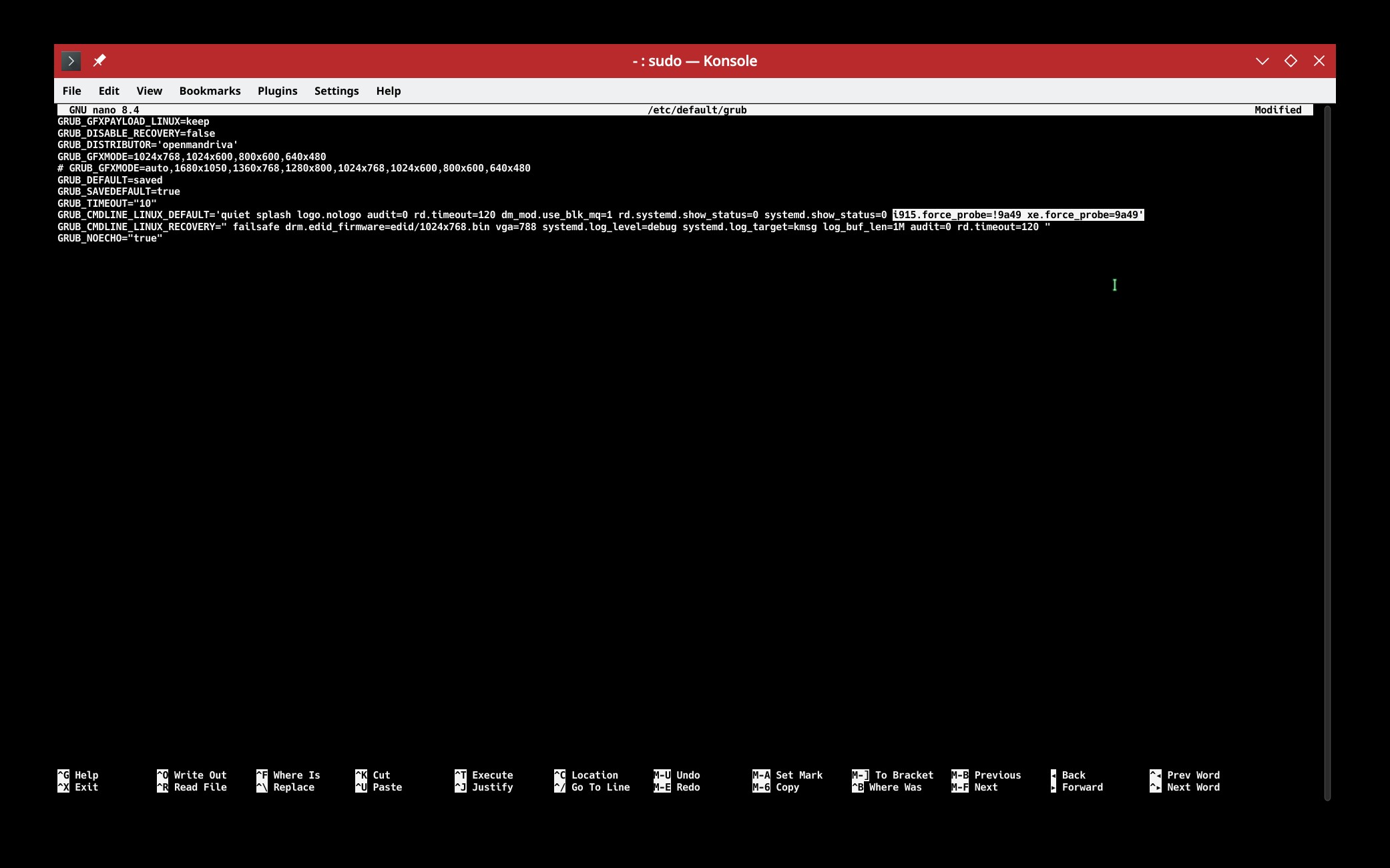

This is how to add kernel parameters globally or permanently. To make the attempt to use the XE driver permanent (nano is a simple command line text editor):
sudo nano /etc/default/grub
Find the line that begins with GRUB_CMDLINE_LINUX_DEFAULT go to the end of that line and type space followed by ‘i915.force_probe=!9a49 xe.force_probe=9a49’ so that line looks exactly like this:
GRUB_CMDLINE_LINUX_DEFAULT='quiet splash logo.nologo audit=0 rd.timeout=120 dm_mod.use_blk_mq=1 rd.systemd.show_status=0 systemd.show_status=0 i915.force_probe=!9a49 xe.force_probe=9a49'
Note where the ’ marks are that is important. Edit: Then while nano is still open type Ctrl>o to write the changes and Ctrl>x to close nano. You can run sudo nano /etc/default/grub again to be sure the changes were written to that file. Then run:
sudo update-grub2
and reboot. To revert again use nano and simply remove what you added. If something goes wrong you can do this by booting in to Console Mode. To check that the XE driver is actually being used after booting type in terminal (Konsole) inxi -G. This is easier to do than it is to explain it, but do note that what you type must be exact.
This type of change is easy enough to do and also easy to revert if something goes wrong.
Edit-2: The instructions for nano are at the bottom of the window as you can see.
I tried the temporary XE driver setting and it didn’t seem to cause an issue loading into the desktop environment. It seemed a little faster, but I can’t tell if that’s actually the case. I will try the permanent setting next.

Ok, I tried deleting the ’ after the show_status=0 and then leaving the ’ at the end after 9a49 and that seemed to work.
I rebooted and launched the default option, which is the server kernel still. I saw a brief flash or artifacting that I’ve never seen before, less than a second. But it loaded in as hoped. It looks like the experimental driver setting did stick after the reboot. When there is an OpenMandriva update, will running the software center update change the kernel back to the desktop kernel? Would I have to enter a command in terminal to change the kernel back to the server version? If this fix works, can the OpenMandriva team incorporate it into the default Rock version that gets installed from the software update center?
