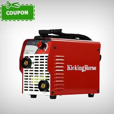

You can buy small inverter welders that run on 120v. You can’t plug them into standard 15A circuits. In much of the rest of the world, you can run a big heater or a small welder from ANY outlet in your home. That simply is not the case in North America, and that is an inconvenience for many people. We have the Suzy Homemaker of electrical service compared to Europe.

What would you weld with a small welder? Every welder that I ever used required 60 amps, 240 volts, single phase.

https://kickinghorsewelders.ca/index.php?main_page=product_machines_info&cPath=128&products_id=419
So, basically anything 3/16" or smaller. Very handy thing to have around.
