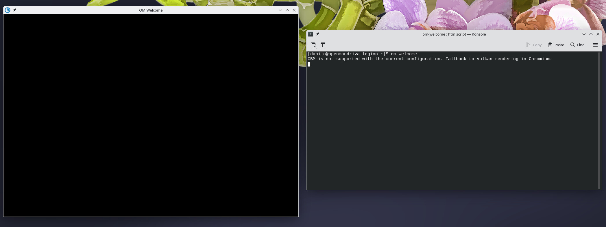

After installin nvidia drivers, OM-welcome stopped working and terminal output is “GBM is not supported with the current configuration. Fallback to Vulkan rendering in Chromium.”. Chromium also crashed while I was typing this

nouveau is terrible, especially with Wayland. You will have a better experience with X11. om-welcome is how you install conveniences like non-free software in the easiest way. Since you have a 4070, I would also recommend using the open driver. How to enable that is pinned in the Support section.

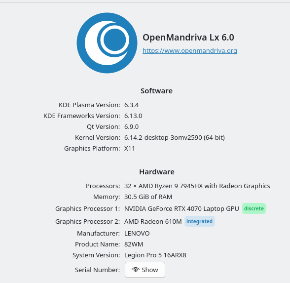

The problem is the dual graphics cards. nvidia-prime is being tested in Cooker right now but is not in Rock. If there is no way to specify in your BIOS that you want to disable the integrated card, then it can cause issues. My guess is you may be using a notebook PC and possibly more than one monitor. This can have issues in a number of configurations, and most notably if you are using HDMI to connect to your external monitor. A simple search of the forum could provide you with this information. We are also aware there are other issues with the Legion Pro line, specifically the touch screen.
I dont have a touchscreen, I do have bios mux/switch. I will disable integrated graphic now in bios, and let you know of results

Saw that topic already, thanks. Okay, so Chromium still crashes, but OM-Welcome is back.
Can we get an error log for Chromium, please?
Sorry, I nuked it already. Will try again probably.
