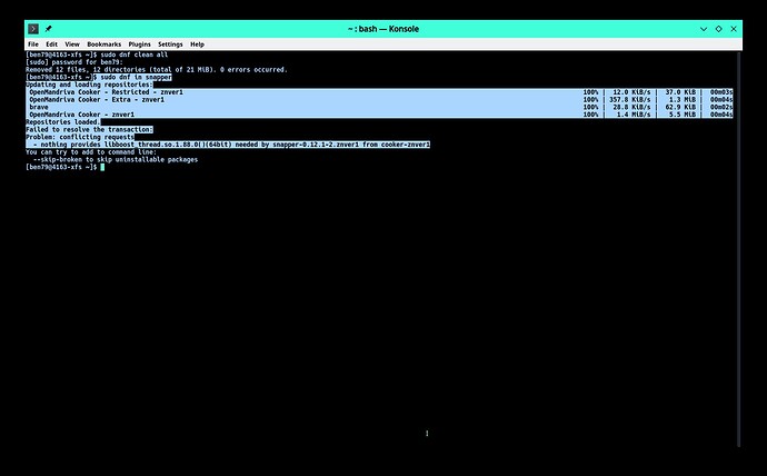

I cannot install ‘snapper’ because of a dependency for ‘libboost_thread’ that cannot be installed. Should I go ahead and use the ‘–skip-broken’ option? I am not sure if that would be wise for something I need to work for btrfs snapshots.
sudo dnf install snapper
Repositories loaded.
Failed to resolve the transaction:
Problem: conflicting requests
  - nothing provides libboost_thread.so.1.88.0()(64bit) needed by snapper-0.12.1-2.x86_64 from rolling-x86_64
You can try to add to command line:
  --skip-broken to skip uninstallable packages
I’d be cautious about using --skip-broken in this case. Since snapper depends on that package, skipping the dependency could leave you with an incomplete or non-functional installation. It’s probably worth identifying why libboost_thread can’t be installed first.

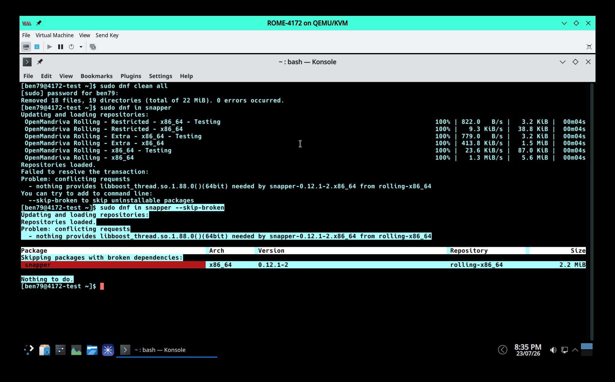

If you use --skip-broken then snapper would not install because of a missing dependency for libboost_thread.so.1.88.0.
The message says “You can try to add to command line” that does not override the requires in the .spec file for whatever package you are trying to install. As I remember dnf can not do that.
Edit: It is possible, maybe even likely, that snapper needs a simple rebuild for new version of boost which in ROME is at 1.90.0-02. I started a build we’ll see if it is successful.
That snapper build failed so I passed this along to folks at OpenMandriva Cooker channel.
Not for me :frowning:
<============================= DnfDrake Execution! =============================>
sudo dnf install  snapper.x86_64 | tee
[Dnfdrake Works For You]
It can’t work because the designated .so file libboost_thread.so.1.88.0()(64bit) is not available. The package has to be rebuilt for a newer version of boost 1.90.0 or possibly 1.91.0. But there are other problems with snapper and this needs a real developer. Anyone interested can real the script_output.log here.
