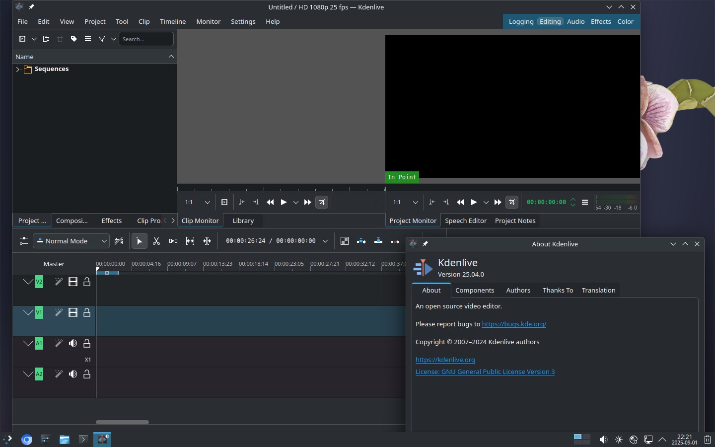

Ive recently ran into this myself installing it from the terminal and there are 2 different packages. The first is just kdenlive, and it wouldnt launch for me. The second package is plasma6-kdenlive and it worked for me without issue. I dont know if this might help you but its worth a shot.
I installed plasma6, logged in and launched it, yet the output remains the same.
Okay, so, this package works. Wild!
I’m scratching my head as to why there are two Kdenlive packages; what are the quantitative differences between kdenlive and plasma6-kdenlive?
From what little I understand, Plasma 6 uses different file and directory names, so things made for plasma 5 can’t find the necessary files.
Does sound reasonable.
Yep, kdenlive is a Plasma5 package and plasma6-kdenlive is the one for Plasma6. And also yes the dependencies for each would be different.
