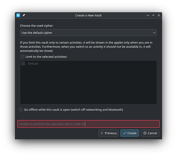

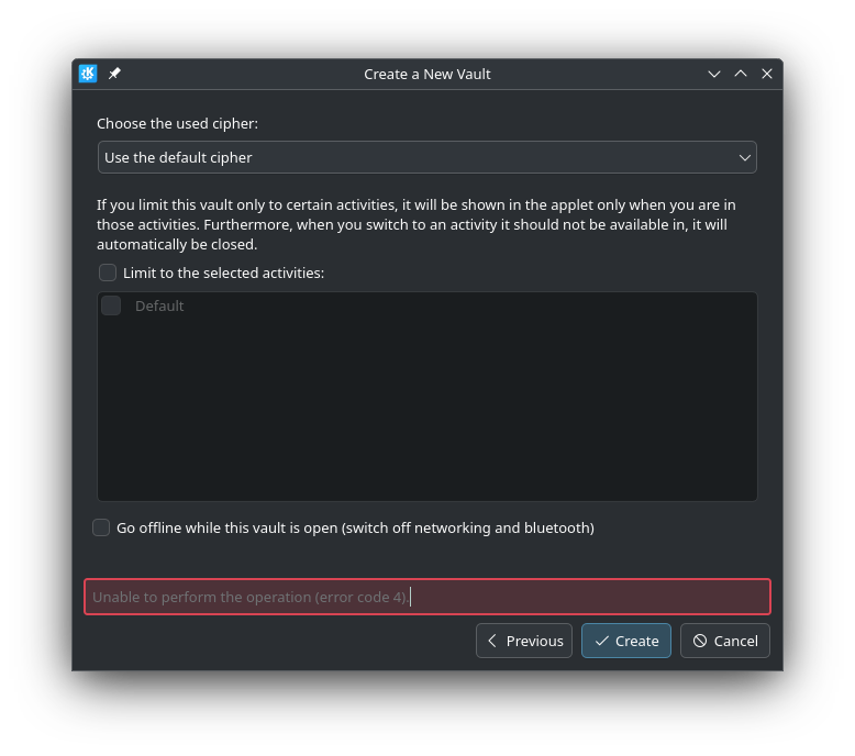

Fails to create KDE vault with cryfs.
This is the stack trace i get from journalctl

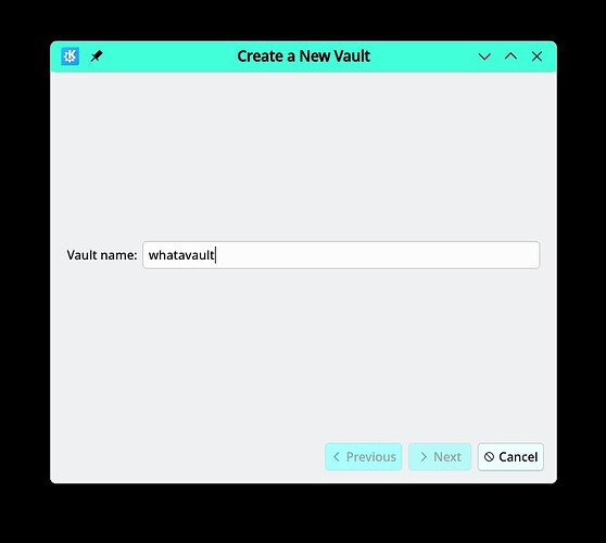

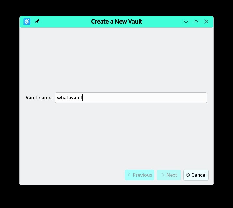

I checked in a ROME VBox VM and was able to create a Vault there and it seems to be working. In Cooker VBox VM I get same results as in Cooker hw system as shown above. Will check in ROME hw system soon.
