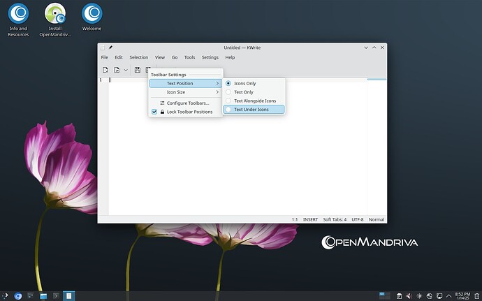

Triple checked with my Arch installation. Kwrite had the same issue, and the same work-around I mentioned earlier worked again. This is not important to me, but if it is a big enough issue for you then I suggest making a bug report with KDE directly.

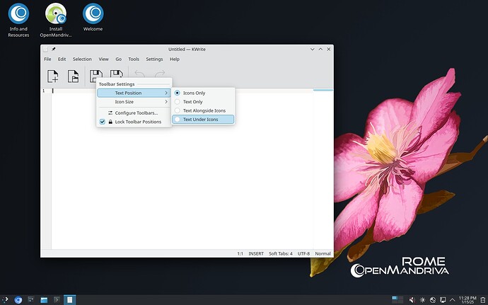

To answer everything being posted, I’m on X11, tried everything enabling the tolbars, disabling, deleting buttons, and adding them again, nothing works. Tried it on other distros in VM, works without problems.
So this is specific for OM.

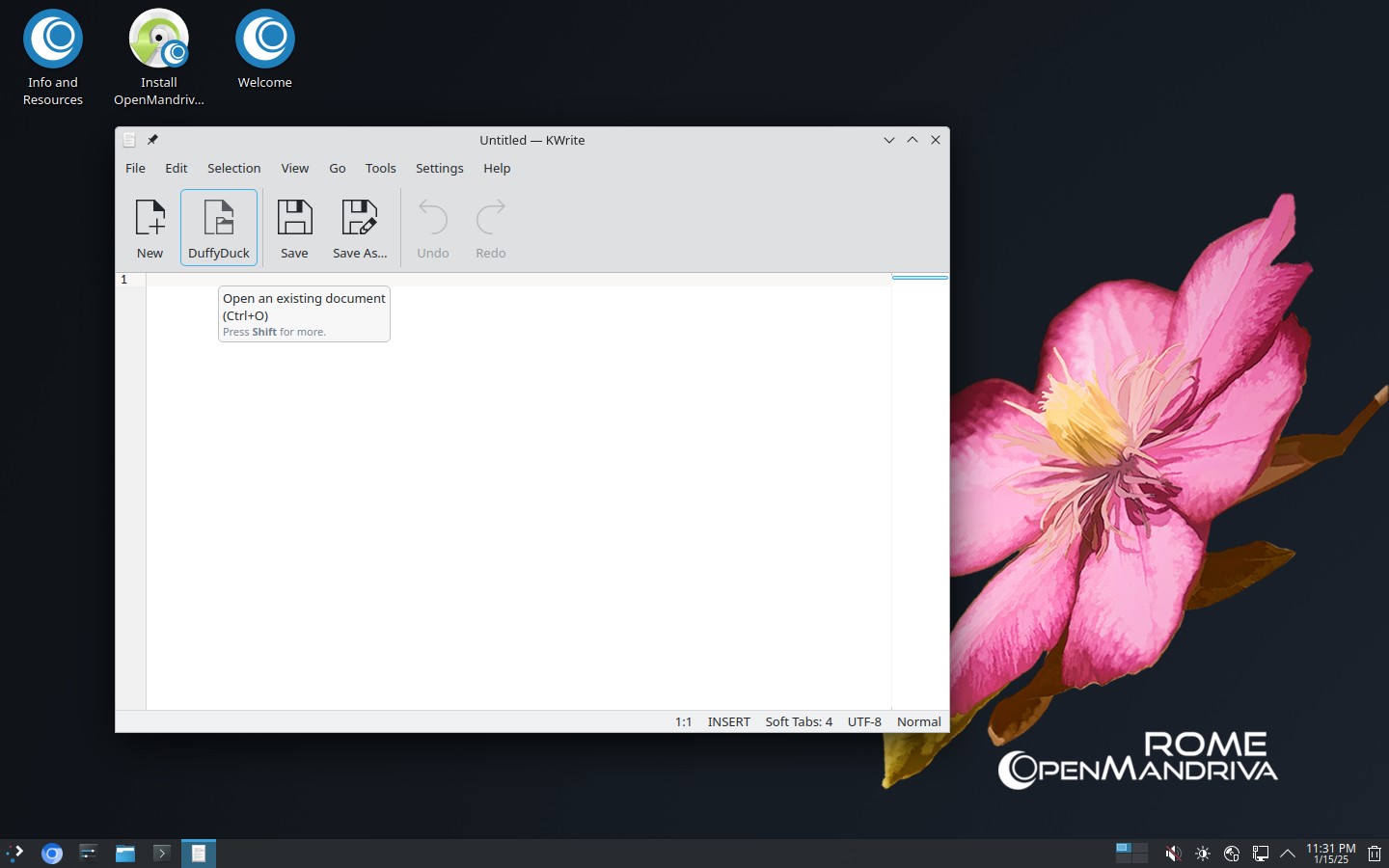

I hate that you had though all this troueel, but things that you put on screenshots don’t work for me.
Whis ISO are you using?
I downloaded the one that is that green button on download page :slight_smile:
This is cooker iso, in live mode to be sure to start with a clean environment.

You can see the build ID number in the last screenshot, done on purpose.
Now, if you have correctly distro-sync -ed your system it should be the same as this nightly build.
