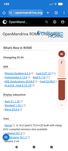

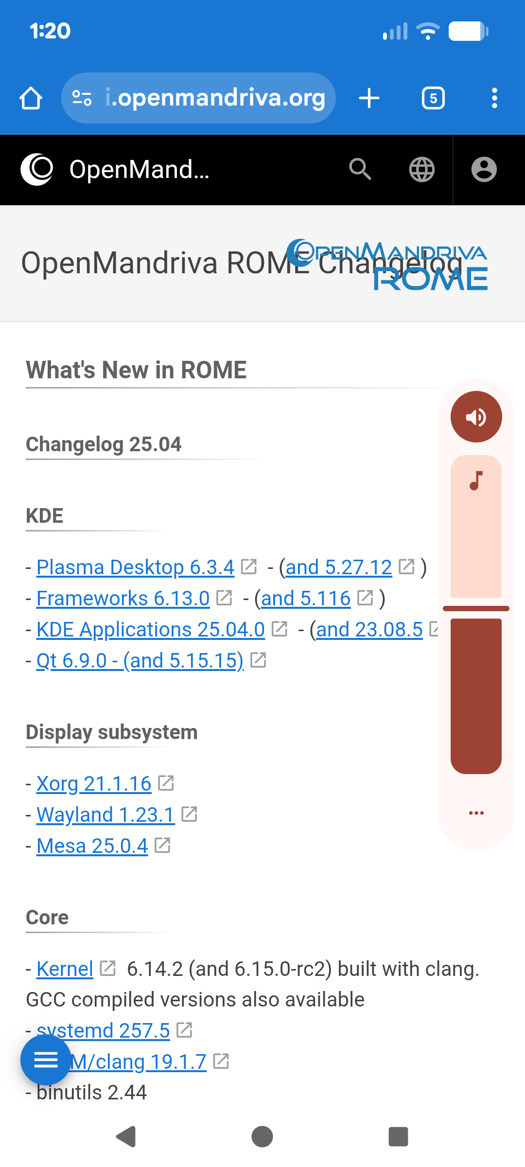

In the above image, it shows “Java 24”. I was assuming it’s a part of the distro, along with the make utility. Neither were present on my system after installation.

The changelog only provides changes that are made from version to version. It’s not indicative of what may be installed by default. Otherwise, we would have to make an asset list of every install scenario that we offer (X11, Wayland, Plasma, GNOME, server, etc…). It’s usually better to review what packages are available using the resources I provided in the first reply.
As a general rule, we favor debloating our packages and installs. Meaning we don’t try to overburden someone’s default or development experience with things they may or may not need.

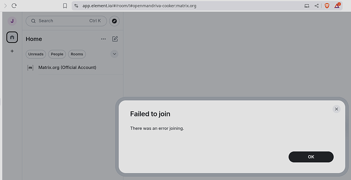

HI @zeroability , I was trying to join, but getting an error. See screenshot below. Admittedly, this is the first time I’m using Matrix.
See if you are able to join the space and find it there:
