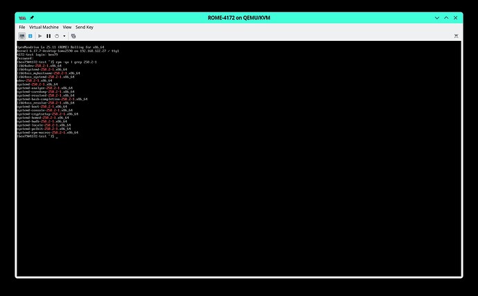

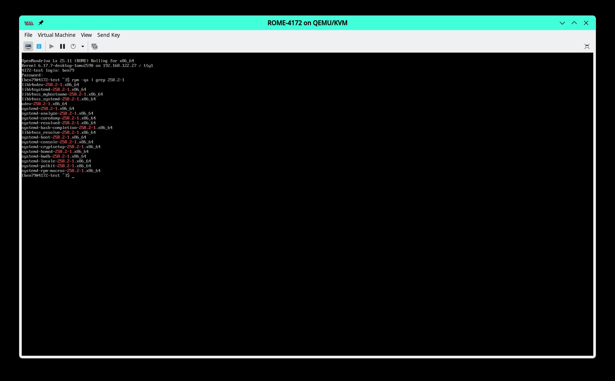

Check that you do have the new systemd stack:
rpm -qa | grep 258.2-1
Should look like this, I believe 19 packages total:
