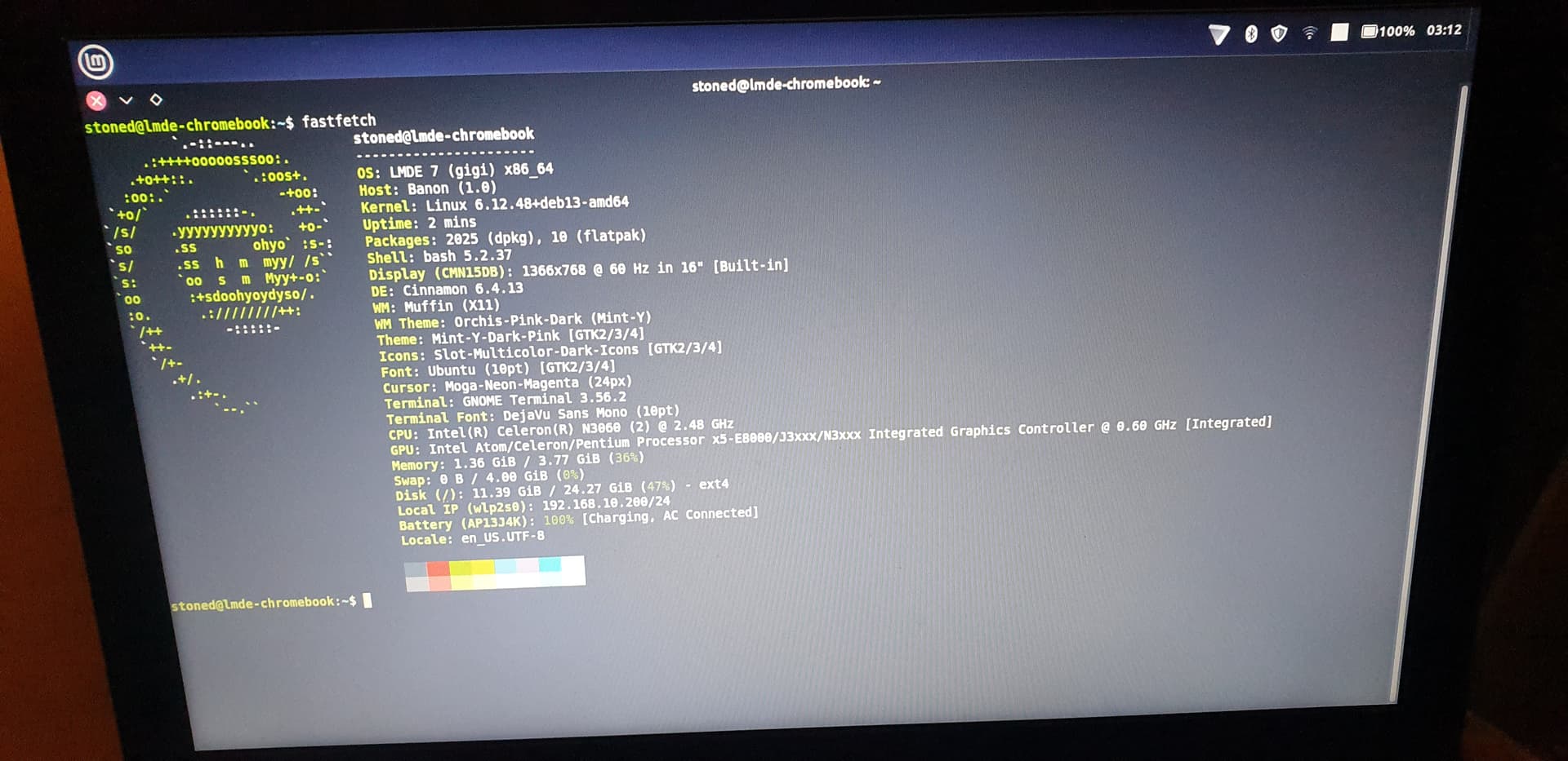

One picture from Openmandriva live and one from Lmde 7 that’s installed at the moment.
I hope I have provided something usefull.
20251117_021431
20251117_031239

lsmod Lmde:
Module                  Size  Used by
snd_seq_dummy          12288  0
snd_hrtimer            12288  1
snd_seq               110592  7 snd_seq_dummy
snd_seq_device         16384  1 snd_seq
ccm                    20480  6
rfcomm                102400  6
cmac                   12288  3
intel_rapl_msr         20480  0
algif_hash             12288  1
algif_skcipher         12288  1
af_alg                 36864  6 algif_hash,algif_skcipher
bnep                   36864  2
intel_rapl_common      53248  1 intel_rapl_msr
intel_powerclamp       16384  0
coretemp               16384  0
qrtr                   57344  2
snd_soc_sst_cht_bsw_rt5645    28672  4
kvm_intel             413696  0
kvm                  1396736  1 kvm_intel
joydev                 24576  0
ip6t_REJECT            12288  1
nf_reject_ipv6         20480  1 ip6t_REJECT
iwlmvm                647168  0
xt_hl                  12288  22
ip6t_rt                16384  3
mac80211             1449984  1 iwlmvm
libarc4                12288  1 mac80211
ipt_REJECT             12288  1
uvcvideo              155648  0
nf_reject_ipv4         16384  1 ipt_REJECT
irqbypass              12288  1 kvm
xt_LOG                 16384  10
intel_cstate           20480  0
nf_log_syslog          24576  10
iwlwifi               581632  1 iwlmvm
videobuf2_vmalloc      20480  1 uvcvideo
btusb                  81920  0
memconsole_coreboot    12288  0
vpd_sysfs              12288  0
uvc                    12288  1 uvcvideo
snd_soc_rt5645        188416  2 snd_soc_sst_cht_bsw_rt5645
memconsole             12288  1 memconsole_coreboot
nft_limit              16384  13
btrtl                  32768  1 btusb
btintel                69632  1 btusb
xt_limit               12288  0
btbcm                  24576  1 btusb
btmtk                  32768  1 btusb
xt_addrtype            12288  4
snd_intel_sst_acpi     16384  1
videobuf2_memops       16384  1 videobuf2_vmalloc
snd_intel_sst_core     77824  1 snd_intel_sst_acpi
videobuf2_v4l2         36864  1 uvcvideo
xt_tcpudp              16384  60
snd_soc_sst_atom_hifi2_platform   122880  2 snd_intel_sst_core
pcspkr                 12288  0
videodev              368640  2 videobuf2_v4l2,uvcvideo
xt_conntrack           12288  16
bluetooth            1081344  34 btrtl,btmtk,btintel,btbcm,bnep,btusb,rfcomm
nf_conntrack          204800  1 xt_conntrack
snd_soc_acpi_intel_match   126976  1 snd_intel_sst_acpi
snd_soc_rt5640        151552  0
snd_hda_codec_hdmi     98304  1
cfg80211             1392640  3 iwlmvm,iwlwifi,mac80211
snd_soc_acpi           16384  3 snd_soc_acpi_intel_match,snd_intel_sst_acpi,snd_soc_sst_cht_bsw_rt5645
snd_hda_intel          61440  1
nf_defrag_ipv6         24576  1 nf_conntrack
snd_intel_dspcfg       40960  2 snd_hda_intel,snd_intel_sst_acpi
nf_defrag_ipv4         12288  1 nf_conntrack
snd_hda_codec         217088  2 snd_hda_codec_hdmi,snd_hda_intel
cros_ec_hwmon          12288  0
snd_soc_rl6231         16384  2 snd_soc_rt5640,snd_soc_rt5645
leds_cros_ec           12288  0
nft_compat             20480  117
snd_intel_sdw_acpi     16384  1 snd_intel_dspcfg
videobuf2_common       81920  4 videobuf2_vmalloc,videobuf2_v4l2,uvcvideo,videobuf2_memops
mc                     94208  4 videodev,videobuf2_v4l2,uvcvideo,videobuf2_common
led_class_multicolor    16384  1 leds_cros_ec
nf_tables             380928  594 nft_compat,nft_limit
snd_soc_core          421888  4 snd_soc_rt5640,snd_soc_sst_atom_hifi2_platform,snd_soc_rt5645,snd_soc_sst_cht_bsw_rt5645
binfmt_misc            28672  1
snd_compress           28672  1 snd_soc_core
rfkill                 40960  8 iwlmvm,bluetooth,cfg80211
snd_hda_core          143360  3 snd_hda_codec_hdmi,snd_hda_intel,snd_hda_codec
snd_pcm_dmaengine      16384  1 snd_soc_core
snd_hwdep              20480  1 snd_hda_codec
nls_ascii              12288  1
nls_cp437              16384  1
snd_pcm               188416  11 snd_hda_codec_hdmi,snd_hda_intel,snd_hda_codec,snd_soc_rt5640,snd_compress,snd_soc_sst_atom_hifi2_platform,snd_soc_core,snd_soc_rt5645,snd_hda_core,snd_soc_sst_cht_bsw_rt5645,snd_pcm_dmaengine
intel_xhci_usb_role_switch    12288  0
vfat                   24576  1
fat                   102400  1 vfat
roles                  16384  1 intel_xhci_usb_role_switch
ac                     16384  0
elan_i2c               61440  0
snd_timer              53248  3 snd_seq,snd_hrtimer,snd_pcm
snd                   151552  23 snd_seq,snd_seq_device,snd_hda_codec_hdmi,snd_hwdep,snd_hda_intel,snd_hda_codec,snd_timer,snd_compress,snd_soc_sst_atom_hifi2_platform,snd_soc_core,snd_pcm
soundcore              16384  1 snd
evdev                  28672  16
msr                    12288  0
ecryptfs              147456  0
parport_pc             40960  0
configfs               69632  1
efi_pstore             12288  0
ppdev                  24576  0
dm_mod                221184  0
lp                     20480  0
parport                81920  3 parport_pc,lp,ppdev
nfnetlink              20480  3 nft_compat,nf_tables
ip_tables              28672  0
x_tables               53248  11 xt_conntrack,nft_compat,xt_LOG,xt_tcpudp,xt_addrtype,ip6t_rt,ipt_REJECT,ip_tables,xt_limit,xt_hl,ip6t_REJECT
autofs4                57344  2
ext4                 1142784  1
crc16                  12288  2 bluetooth,ext4
mbcache                16384  1 ext4
jbd2                  200704  1 ext4
btrfs                2158592  0
raid10                 77824  0
raid456               200704  0
async_raid6_recov      20480  1 raid456
async_memcpy           16384  2 raid456,async_raid6_recov
async_pq               16384  2 raid456,async_raid6_recov
async_xor              16384  3 async_pq,raid456,async_raid6_recov
async_tx               16384  5 async_pq,async_memcpy,async_xor,raid456,async_raid6_recov
xor                    20480  2 async_xor,btrfs
raid6_pq              122880  4 async_pq,btrfs,raid456,async_raid6_recov
libcrc32c              12288  4 nf_conntrack,btrfs,nf_tables,raid456
crc32c_generic         12288  0
raid1                  61440  0
raid0                  28672  0
md_mod                229376  4 raid1,raid10,raid0,raid456
i915                 4386816  12
hid_generic            12288  0
usbhid                 77824  0
hid                   262144  2 usbhid,hid_generic
crct10dif_pclmul       12288  1
crc32_pclmul           12288  0
cros_ec_debugfs        16384  0
crc32c_intel           16384  3
cros_ec_chardev        12288  0
cros_ec_sysfs          12288  0
ghash_clmulni_intel    16384  0
cros_charge_control    16384  0
mmc_block              57344  3
drm_buddy              24576  1 i915
sha512_ssse3           53248  0
sha256_ssse3           32768  0
cros_ec_dev            12288  0
i2c_algo_bit           16384  1 i915
sha1_ssse3             32768  0
iTCO_wdt               16384  0
xhci_pci               24576  0
aesni_intel           122880  8
xhci_hcd              364544  1 xhci_pci
intel_pmc_bxt          16384  1 iTCO_wdt
drm_display_helper    274432  1 i915
iTCO_vendor_support    12288  1 iTCO_wdt
usbcore               409600  6 xhci_hcd,usbhid,btmtk,uvcvideo,btusb,xhci_pci
sdhci_pci              98304  0
gf128mul               16384  1 aesni_intel
cqhci                  32768  1 sdhci_pci
watchdog               49152  1 iTCO_wdt
crypto_simd            16384  1 aesni_intel
sdhci                  86016  1 sdhci_pci
cec                    69632  2 drm_display_helper,i915
rc_core                73728  1 cec
ttm                   106496  1 i915
drm_kms_helper        253952  2 drm_display_helper,i915
cryptd                 28672  3 crypto_simd,ghash_clmulni_intel
drm                   774144  8 drm_kms_helper,drm_display_helper,drm_buddy,i915,ttm
mmc_core              253952  4 sdhci,cqhci,mmc_block,sdhci_pci
serio_raw              16384  0
video                  81920  1 i915
usb_common             16384  3 xhci_hcd,usbcore,uvcvideo
cros_ec_lpcs           20480  0
dw_dmac                12288  0
battery                28672  1 cros_charge_control
cros_ec                20480  1 cros_ec_lpcs
lpc_ich                28672  0
dw_dmac_core           40960  1 dw_dmac
wmi                    28672  1 video
button                 24576  0
efivarfs               28672  1
