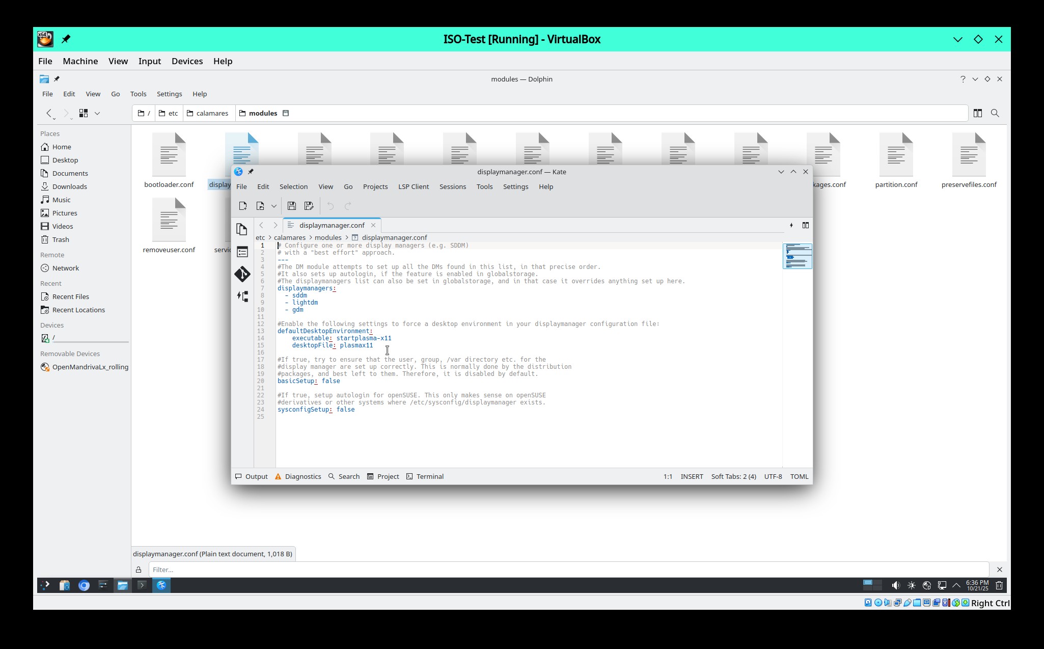

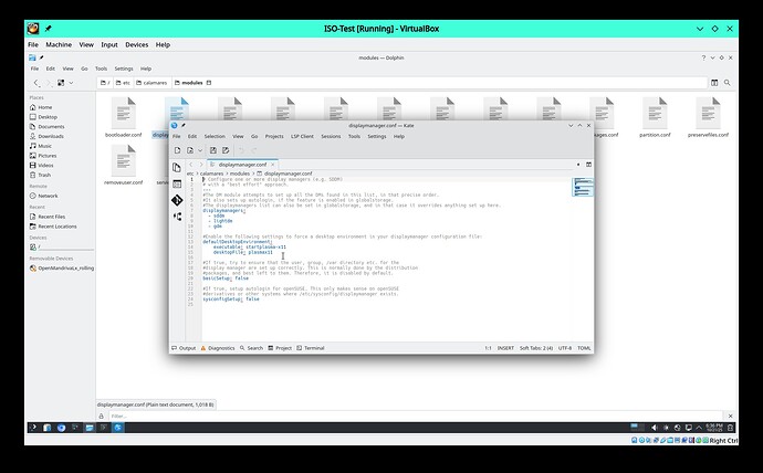

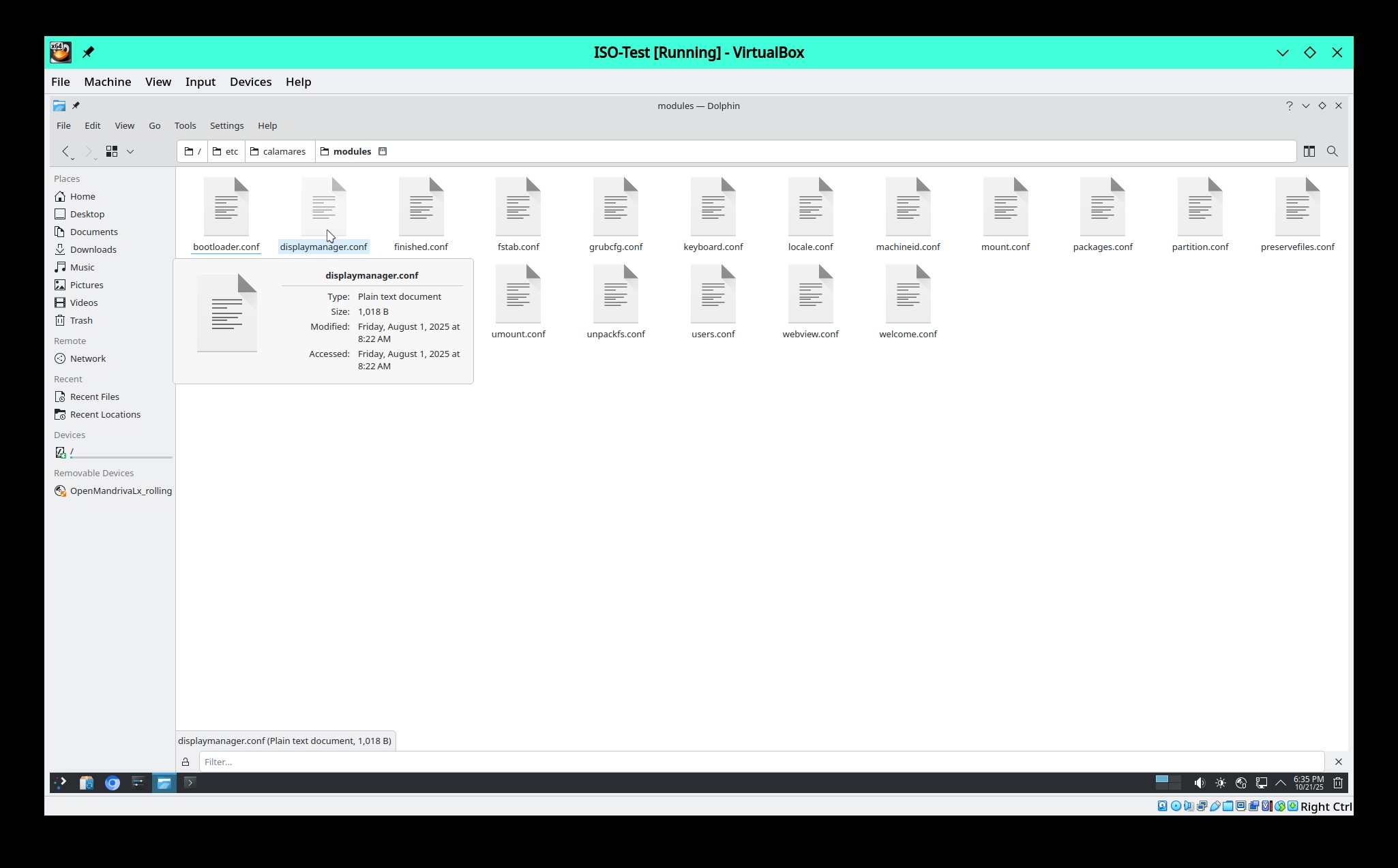

Thank you for posting this! I had this exact same issue but couldn’t figure out a decent solution. Where exactly is the displaymanager.conf that needs this change to be made located?
Welcome @sluke0 to the OpenMandriva forum and OpenMandriva Linux.
/etc/calamares/modules/displaymanager.conf
An easy way to edit would be to use the simple test editor nano thus:
sudo nano /etc/calamares/modules/displaymanager.conf
For these kind of quick one off edits I usually open the file from Dolphin and use Kate (or KWrite) myself. (This assumes user is using one of the Plasma isos)
I can’t remember exactly, I am back on opensuse atm. Look through the file and find a section where it tries to give you a selection of desktops and force it to pick plasma. If you are really stuck let me know and I’ll put openMandriva back on the machine and post the file
Mal
Thank you for the super detailed response, very much appreciated :slight_smile:
