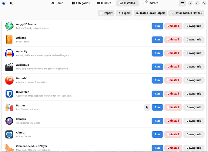

You should now see “Easy Flatpak” in the UTILITIES menu. If not, either log out or reboot your machine, and it should appear there when you log back in. Once you have it, open it, and you will see this (mine has apps I have installed):
I think most users are familiar with Software Centers so I won’t waste our time going over every feature of Easy Flatpak. I will point out that there is a Search Glass at the top left you would click on to search for apps. You can also see the main list of some of the apps I have installed. As you install apps, their launchers will show up in the KDE Start Menu. If not, run kbuildsycoca6in Terminal to update the launcher lists in the Start Menu.

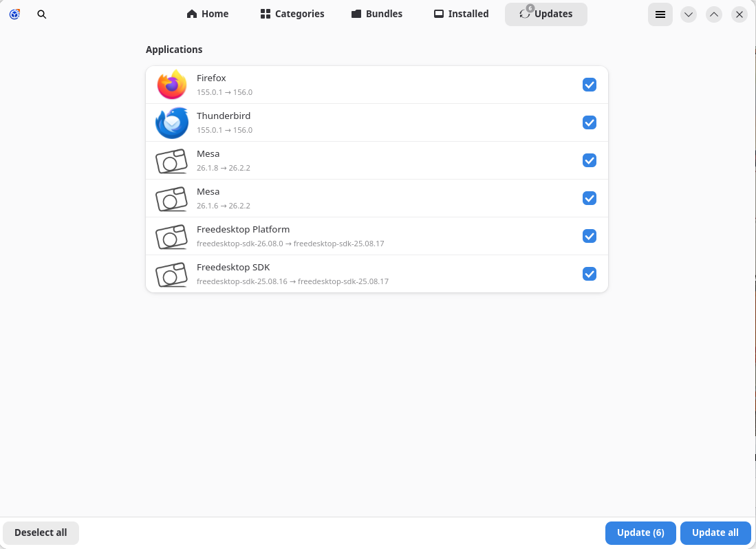

As you can see at almost the top right, I have 6 updates to get. If I click UPDATES, all I have to do to get them is click the UPDATE ALL button at the bottom right of the UPDATES window:
Pretty easy to update isn’t it? If you prefer the Terminal instead, you can run:

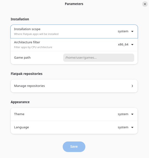

The only other thing I will point out is the “hamburger”/3 line button at the top right. Click on it. I install ALL of my Flatpaks as SYSTEM, not USER. I have had ZERO issues doing it this way, and it makes Flatpaks apps available for other users as well:

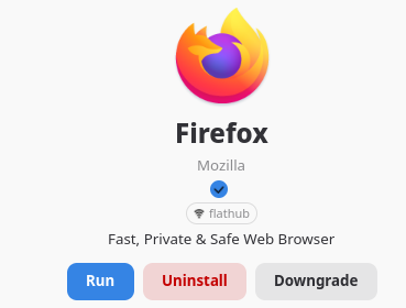

Using Firefox as an example once again, you can see in Easy Flatpak that the app is verified via the blue-circled check mark:
So I have made it a habit to look for this prior to installing a Flatpak.
