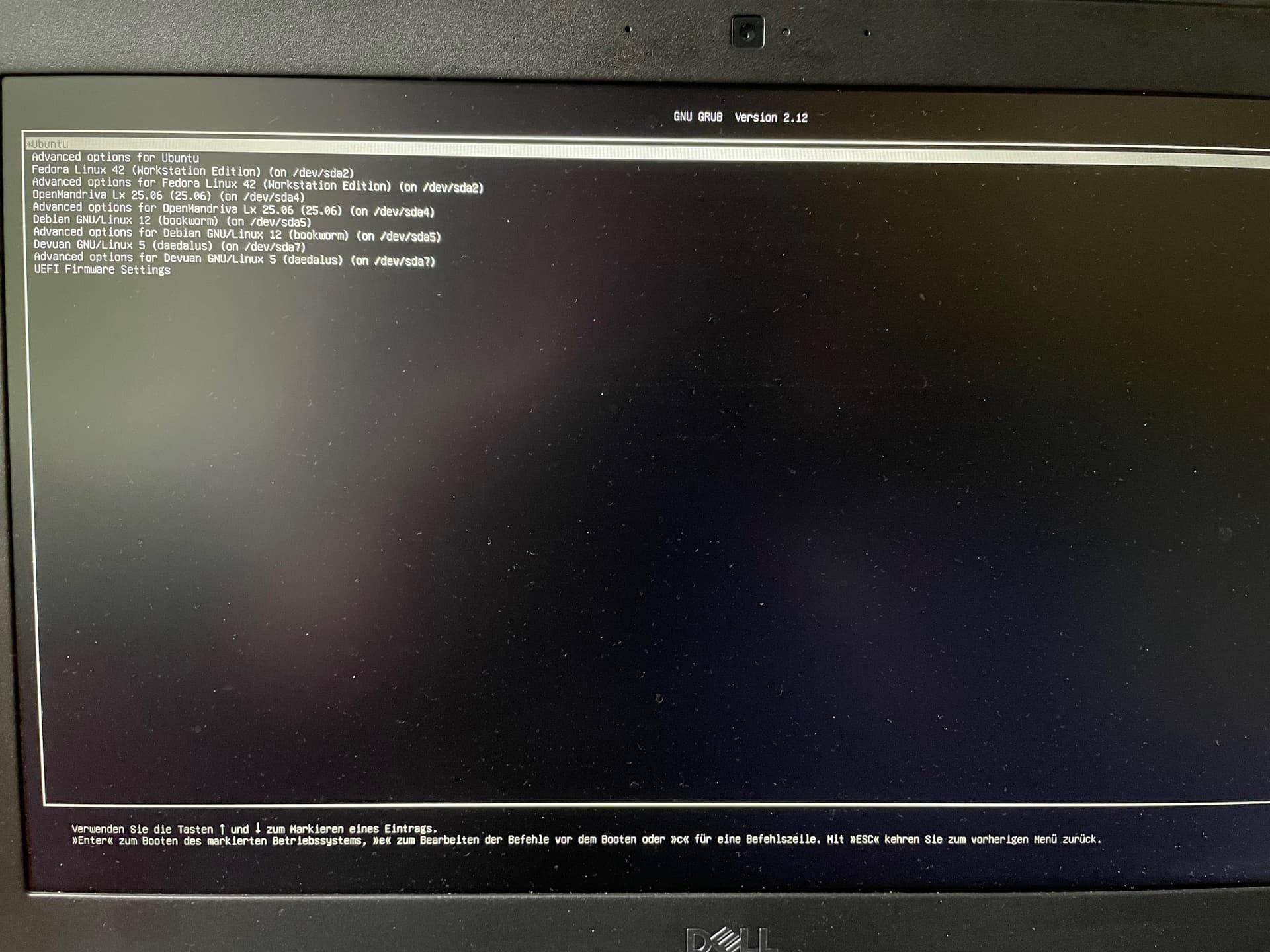

Hello everyone,
I have different distributions installed on my computer. Lately Linux Mint made a huge update and now my bootloader look like this. Everything is working, but I want the old bootloader back with the flower and icons for every distribution.
Any ideas how to fix it? sudo update-grub2 didnt helped.
Usually what is at the top of the list is the operating system that is doing the boot loading. That appears to be Ubuntu, and I do not see Linux Mint in the list at all,

So this was not a broken boot loader but a change in boot order. Anytime a Linux distro runs it’s grub or grub2 script that system will become the boot loader system. For example whenever a new kernel is installed you will see the grub or grub2 script run. This is normal behavior as far as I know.
You can or course use efibootmgr to change this anytime this happens.
