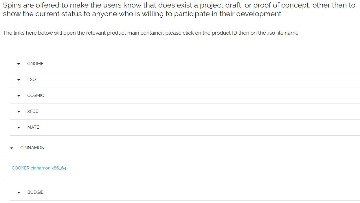

I am trying to reproduce what you and some other users are seeing. I agree that our pages are seen as to complicated. I am not the right person to design such pages though, that is better left to @rugyada.

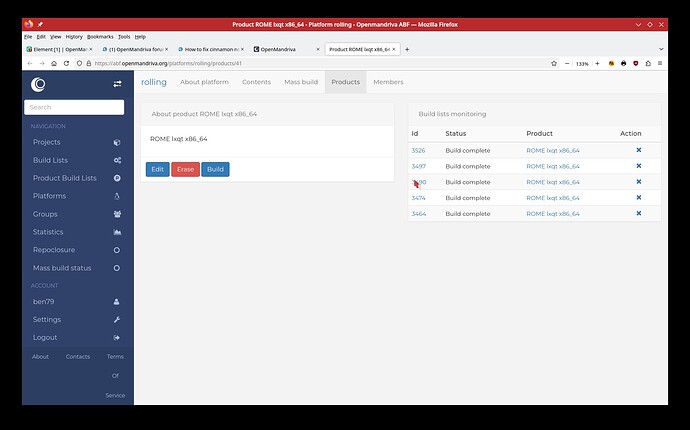

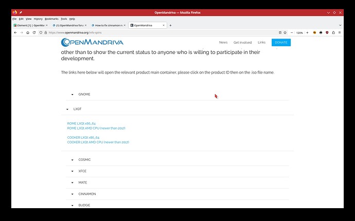

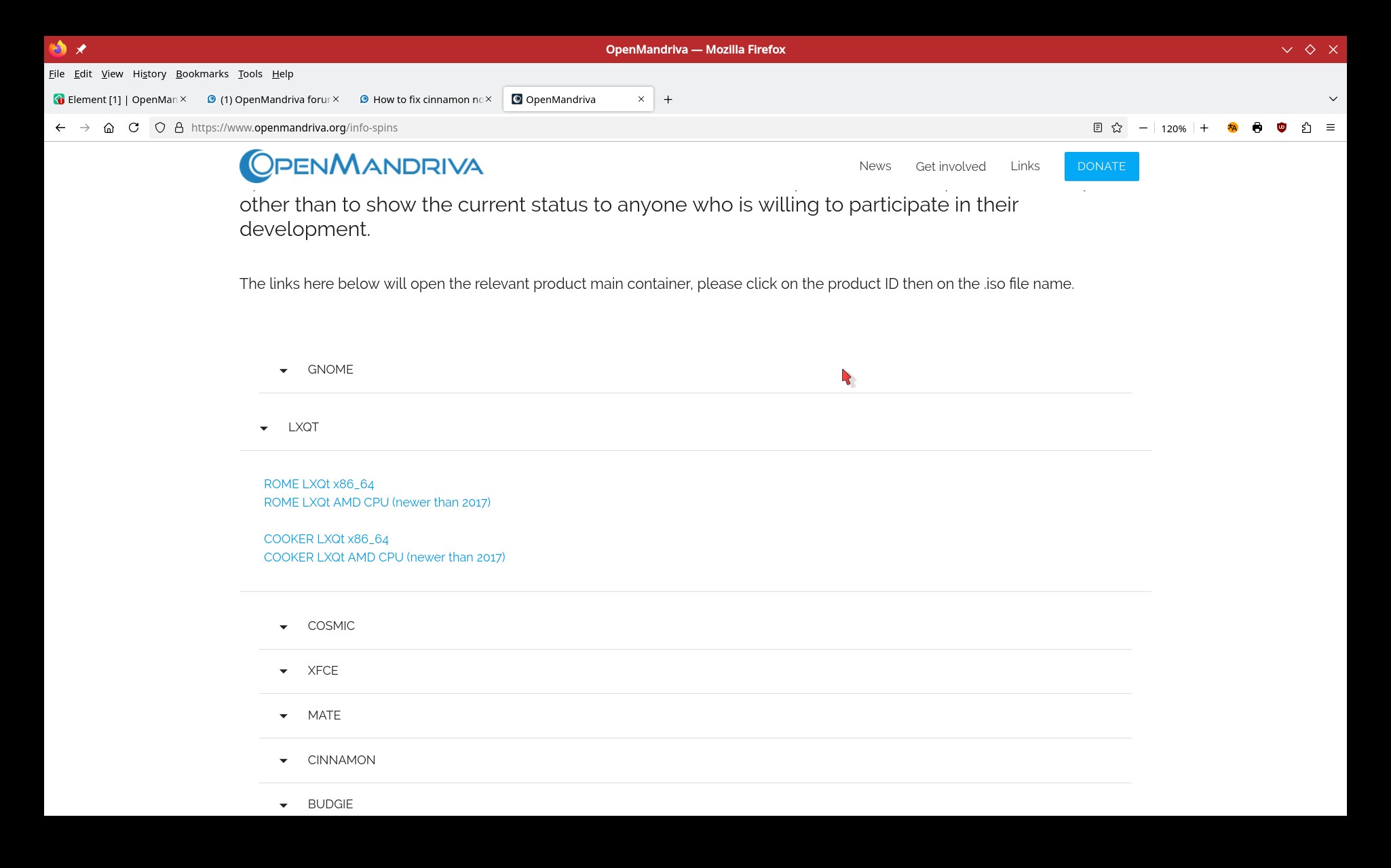

I click on ROME LXQt x86_64

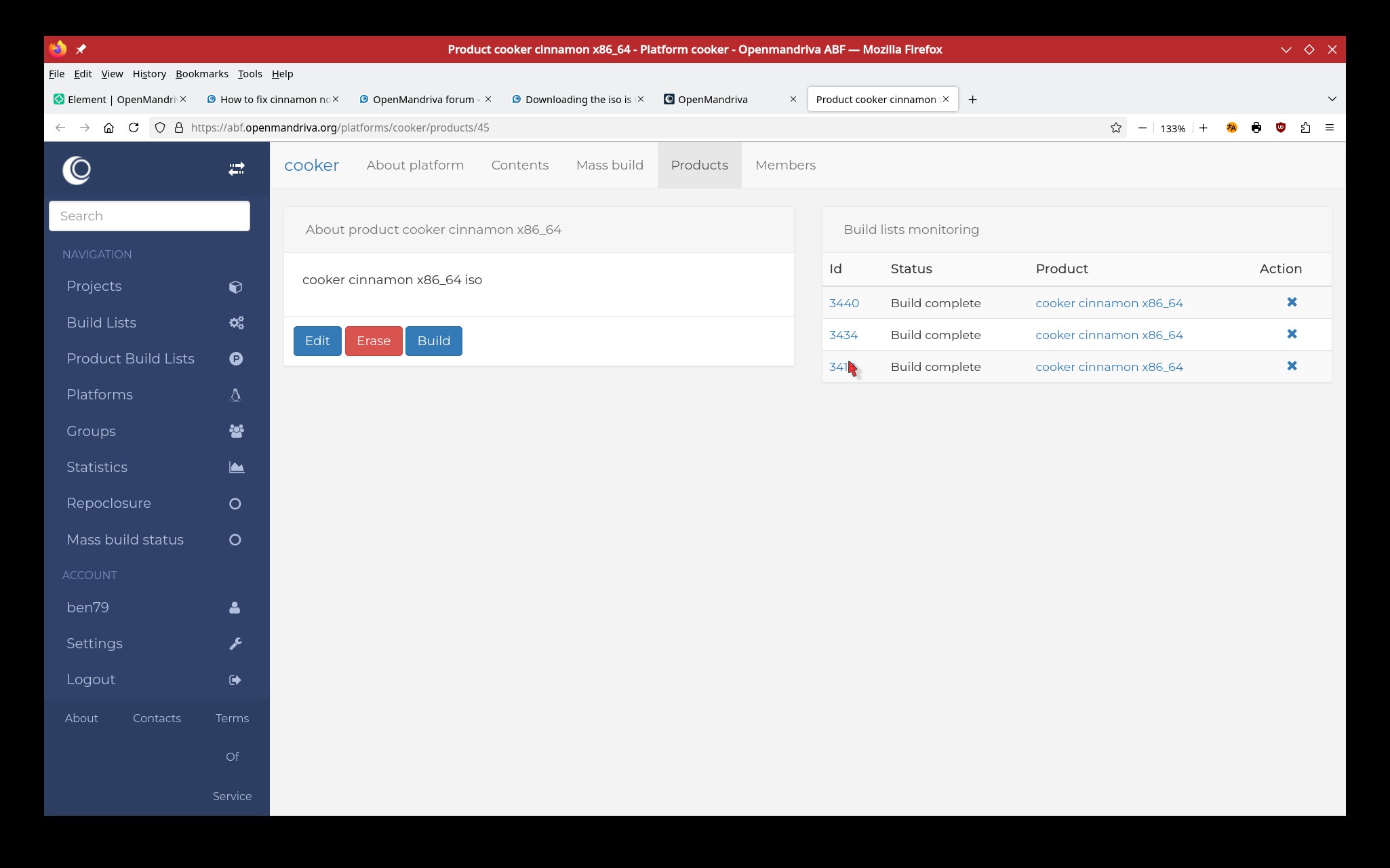

Click on the most recent entry at the top:

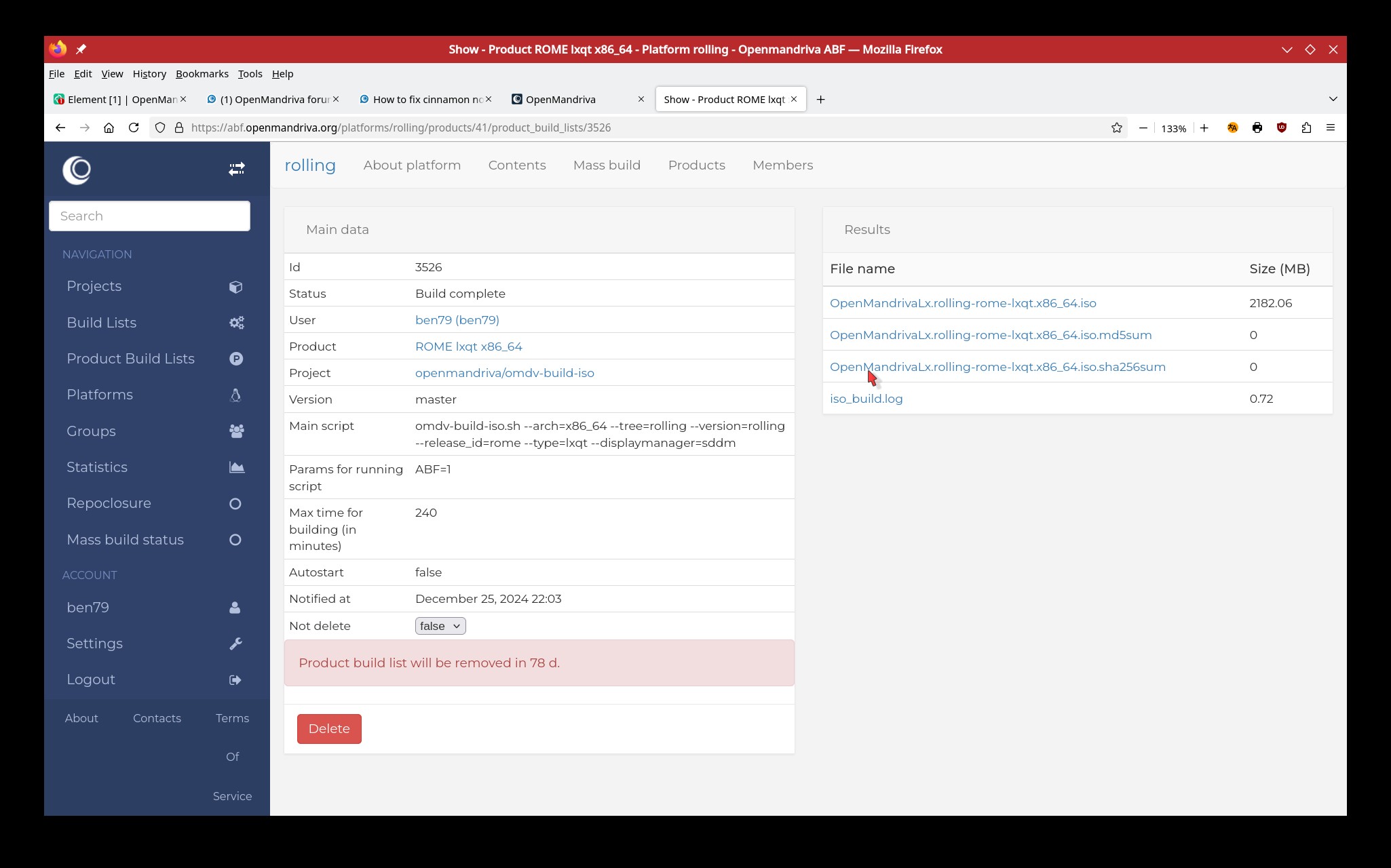

Those links will download here because I have done it and tested that .iso.
So what am I missing in trying to reproduce your results? Perhaps how you are downloading vs. how I do it. They will download from Firefox but not Brave I know that. (Unless Firefox has changed something in recent weeks)

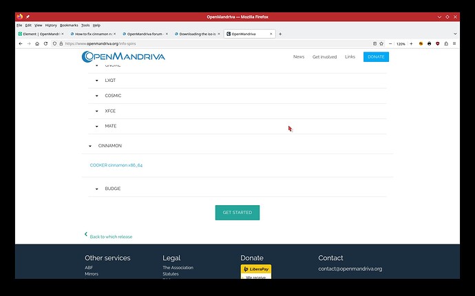

This is one approach to downloading OMLx iso.
@rugyada

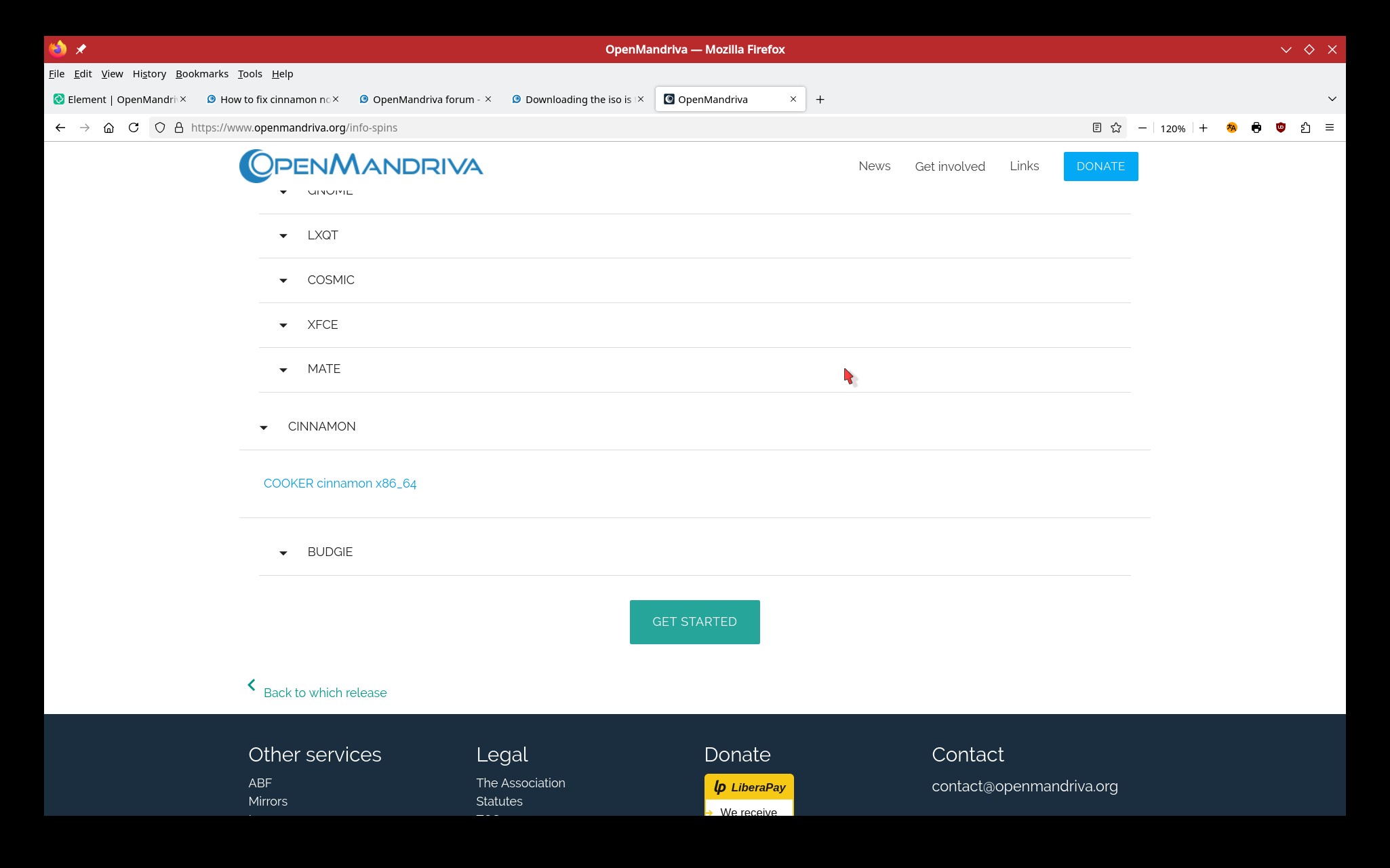

Basically one of these three, but the links don’t do anything

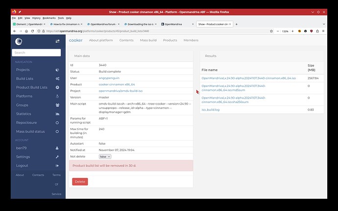

If you are in Firefox or Firefox based browser click on the .iso link and download. That won’t work in Chromium, Brave, or Chrome based browsers. There you would right click on the .iso file, select copy link, open terminal and use one of these curl, wget, or aria2c like this.
aria2c http://file-store.openmandriva.org/api/v1/file_stores/4ee954a8408291040e004a7fbe62199a35db857c
or
wget http://file-store.openmandriva.org/api/v1/file_stores/4ee954a8408291040e004a7fbe62199a35db857c
I am guessing that our links in ABF do not work in Chrome based stuff is because the links are http instead of https. I have asked OM devs about this and am awaiting an answerl
Hope this helps.

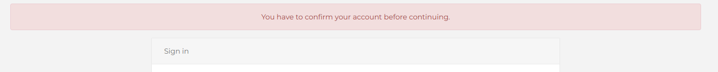

I tried logging in but it isn’t sending a confirmation email
No need to login to download the iso files.
abf account is just for developers.

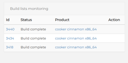

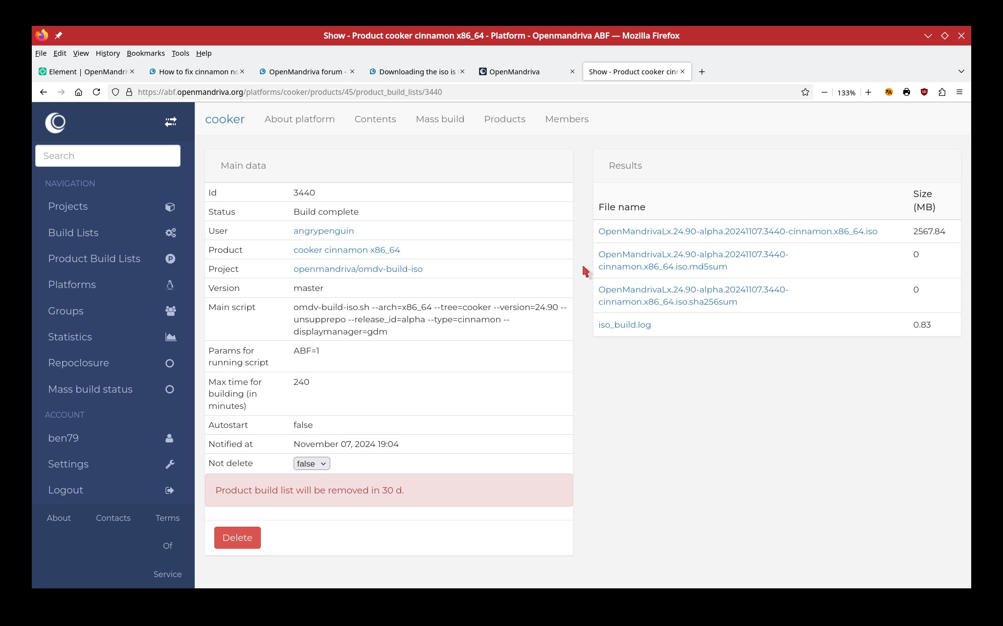

Copy/paste command in console:
3440
$ aria2c http://file-store.openmandriva.org/api/v1/file_stores/4ee954a8408291040e004a7fbe62199a35db857c
3434
$ aria2c http://file-store.openmandriva.org/api/v1/file_stores/87a574e3e892a55a60c6de08e0c02964e5c76866
3418
$ aria2c http://file-store.openmandriva.org/api/v1/file_stores/aa4831aa1e5a6b2e44909af8cbc0e43bca53b99e
or replace aria2c by wget if you prefer.
