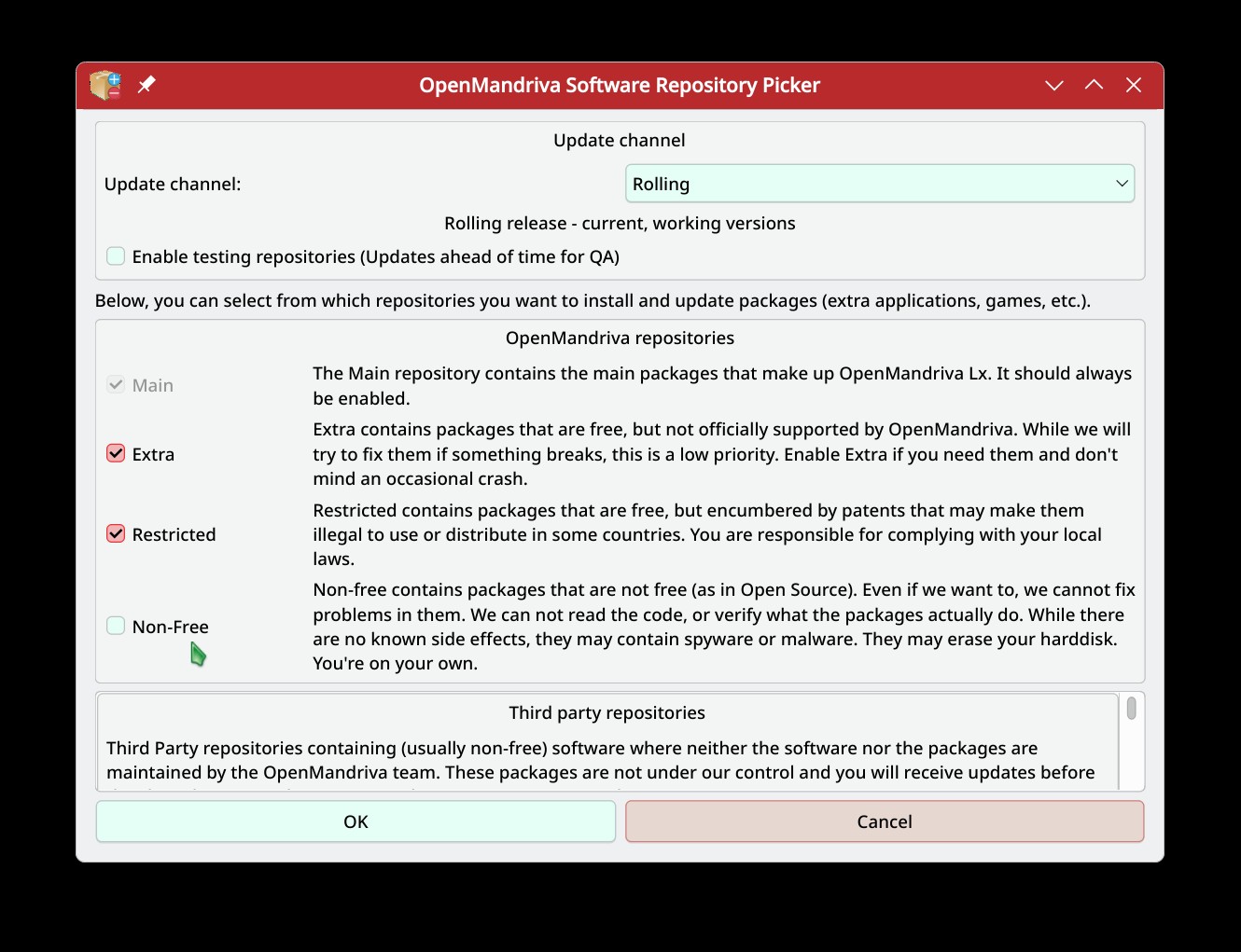

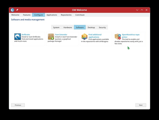

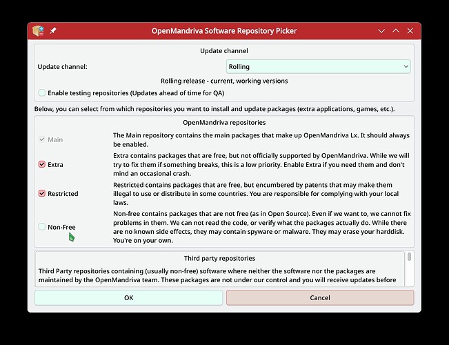

Do you have all the repos enabled? Only the “main” repo is enabled by default. Additional repos are extra, restricted, and non-free. Look for Software Repository Selector aka om-repo-picker.

Could this possibly be an issued of not having the proper repos?
Can you please post the output of
dnf repolist

Live boot is not a persistent image, anyway. You will still need to install and enable the rest of the repos you want. Then you can just dnf search <package_name> --refresh (even as a regular user) and see if the package you want is there.

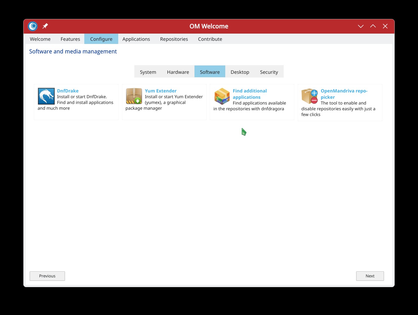

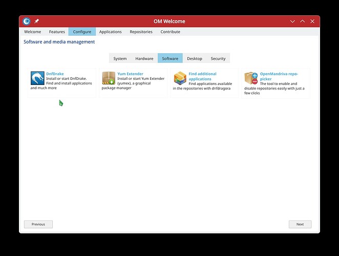

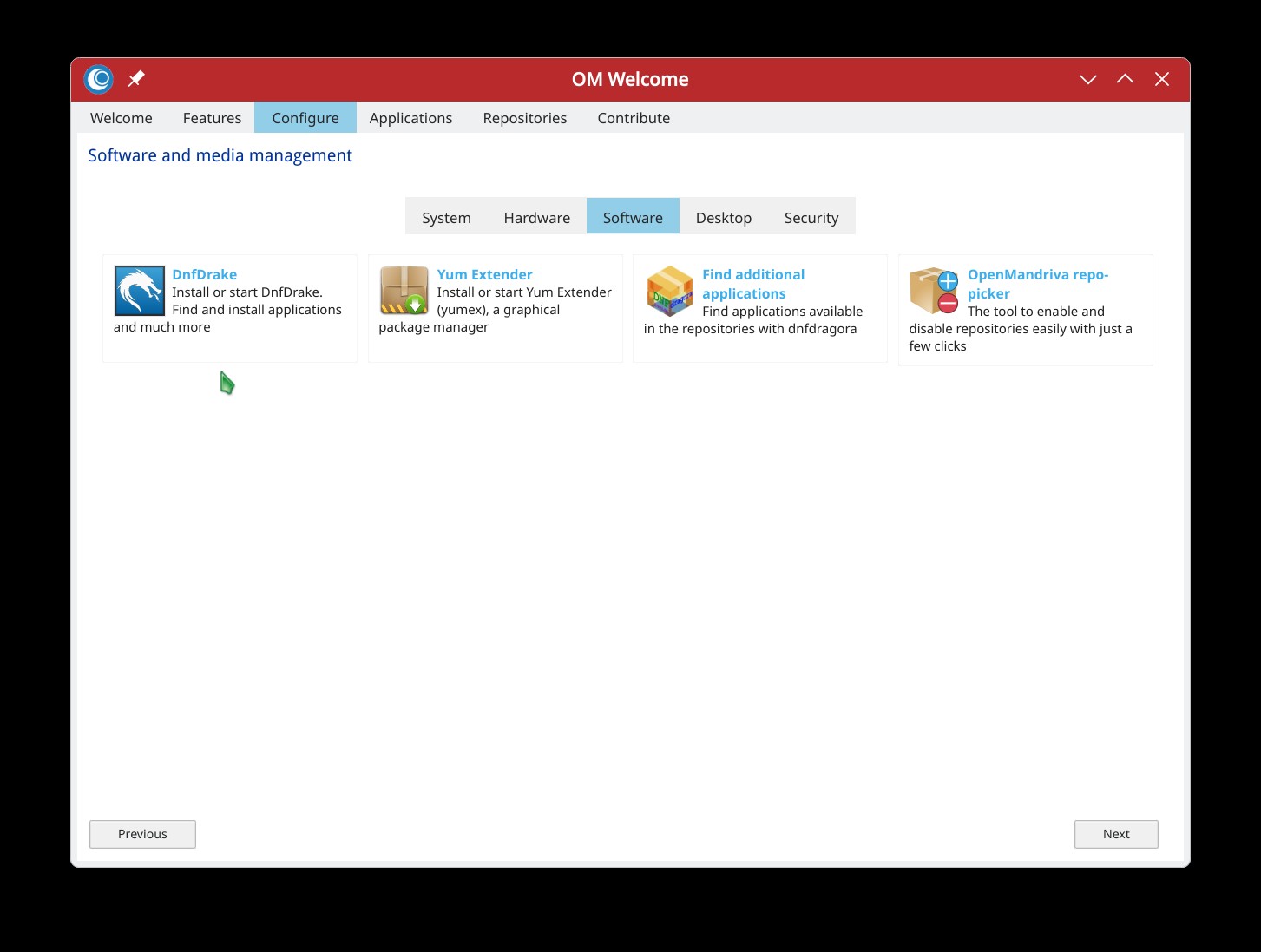

You can also search for software in dnfdragora, Discover, or dnfdrake. dnfdrake is not installed by default.
