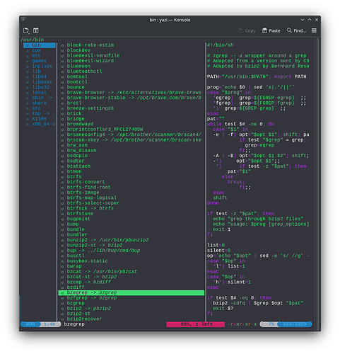

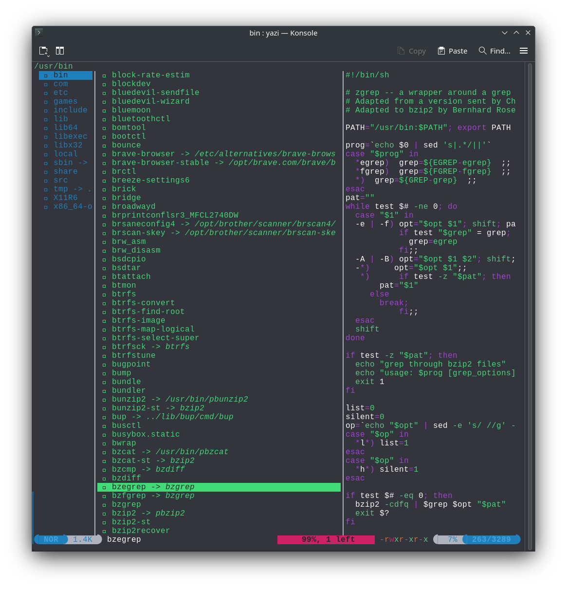

Are you on x86_64 or znver1 ? If you want yazi and are willing to test it, you can grab it with a one time enable of the repo. It doesn’t add the repo and put you into cooker.
sudo dnf install --enablerepo=cooker-znver1 yazi --refresh
or
sudo dnf install --enablerepo=cooker-x86_64 yazi --refresh
I have it running on mine and I am still on ROME. I have to admit. It looks really good with our OMDark color scheme.
You don’t have to switch when you use the command I showed. It enables the one time shot to grab the files from the cooker repos.
