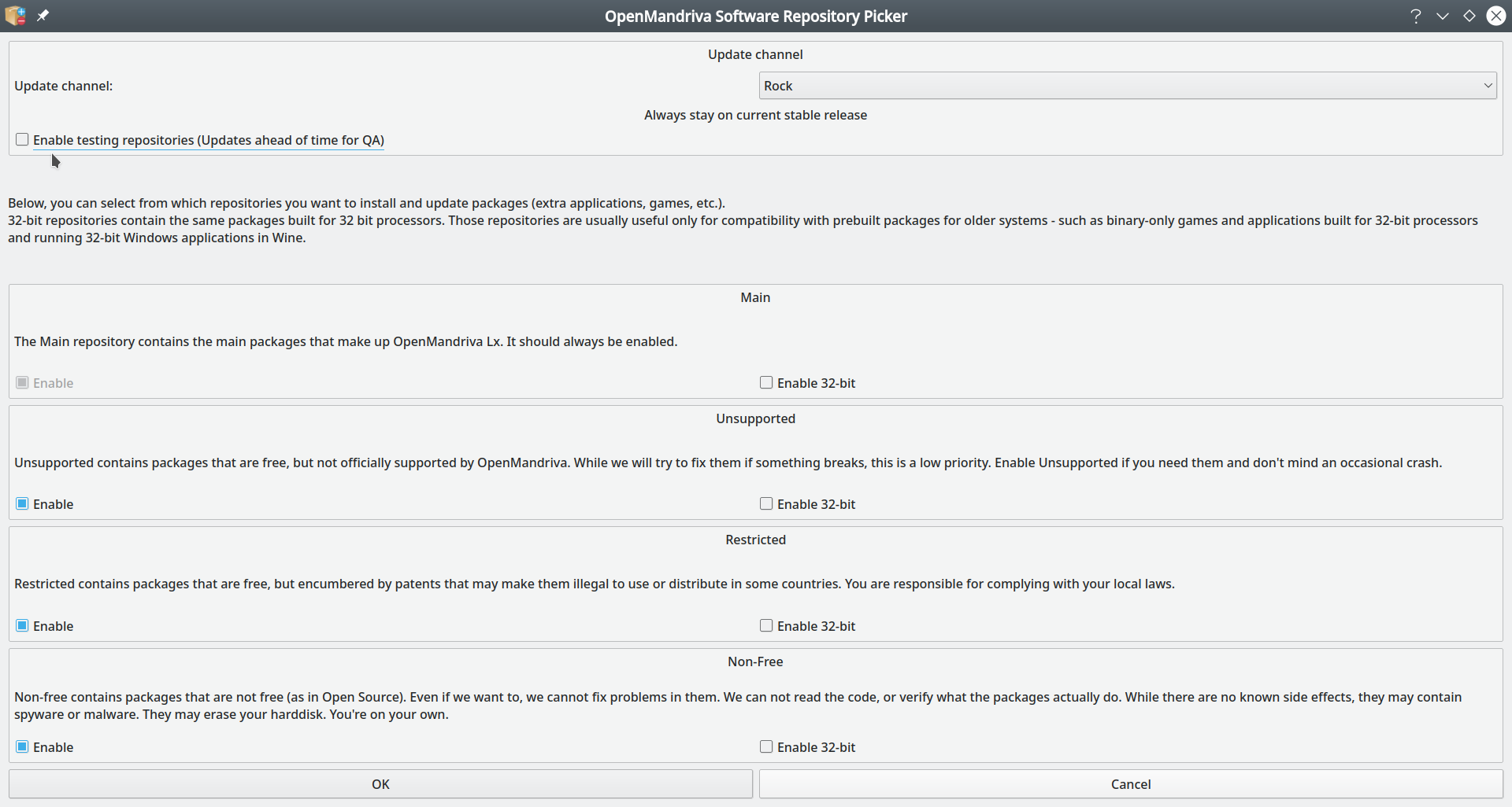

Ok thank you, some questions now… i guess i must disable the testing repositories via command line how can i do that?
second question, i remember when i update my system on lx4.1 the default update app was the dnfdragora now is the apper may i return back to dnfdragora as the default updater?
No there is “Software Repository Selector” in Application Launcher>System.
