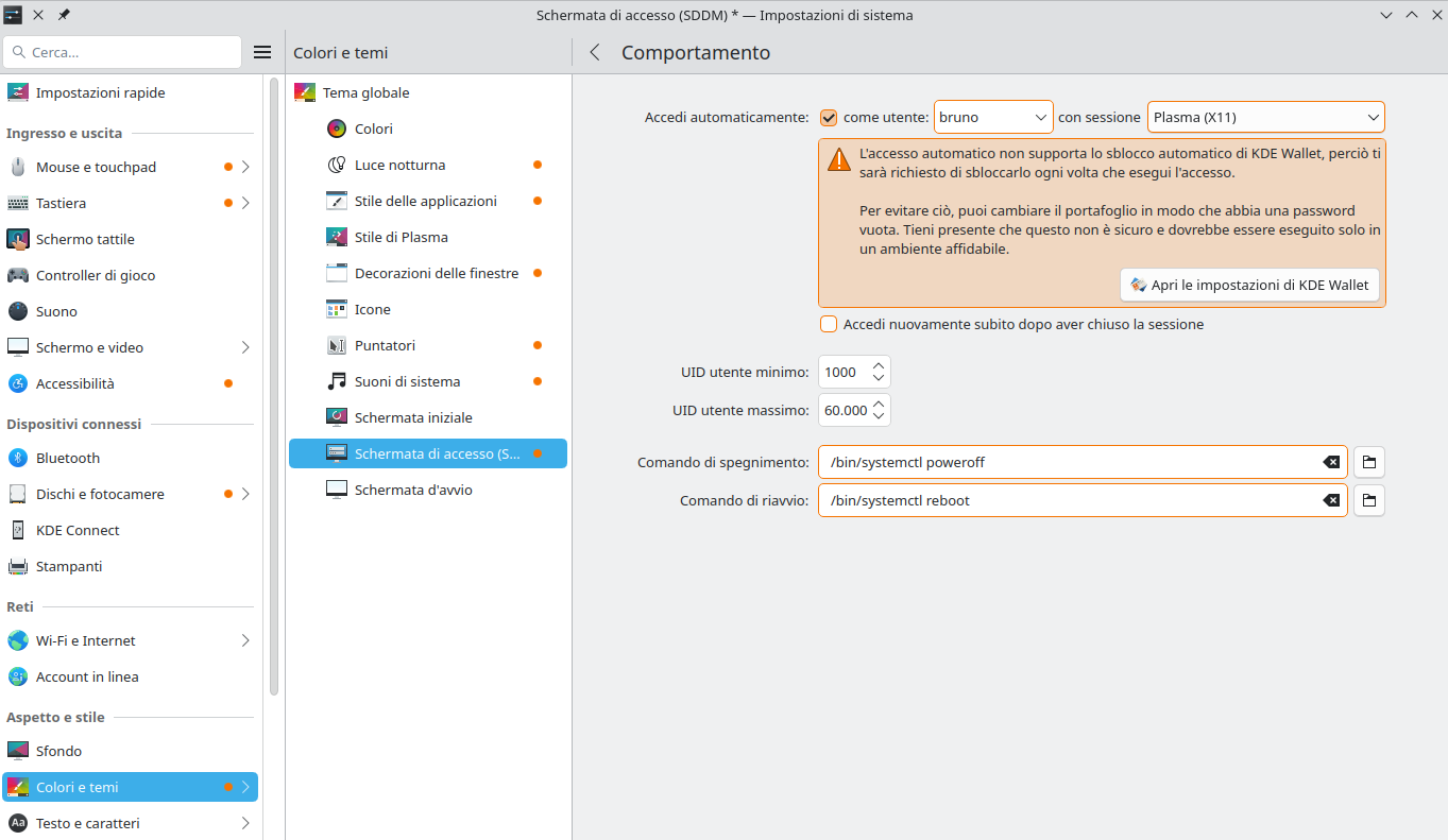

Maybe it is the same problem as mine… you can try my solution…

Setting sddm to autologin as in your example worked, but still need to find out why. It’s not a good workaround from a security view.

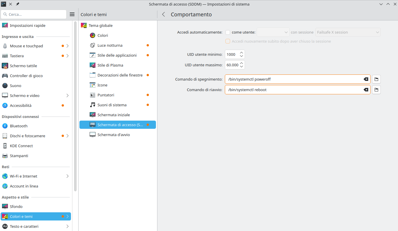

Just to check that it wasn’t just a matter of sddm having to run correctly once, I disabled autologon. And it returned to the prior state of not loading the UI.
