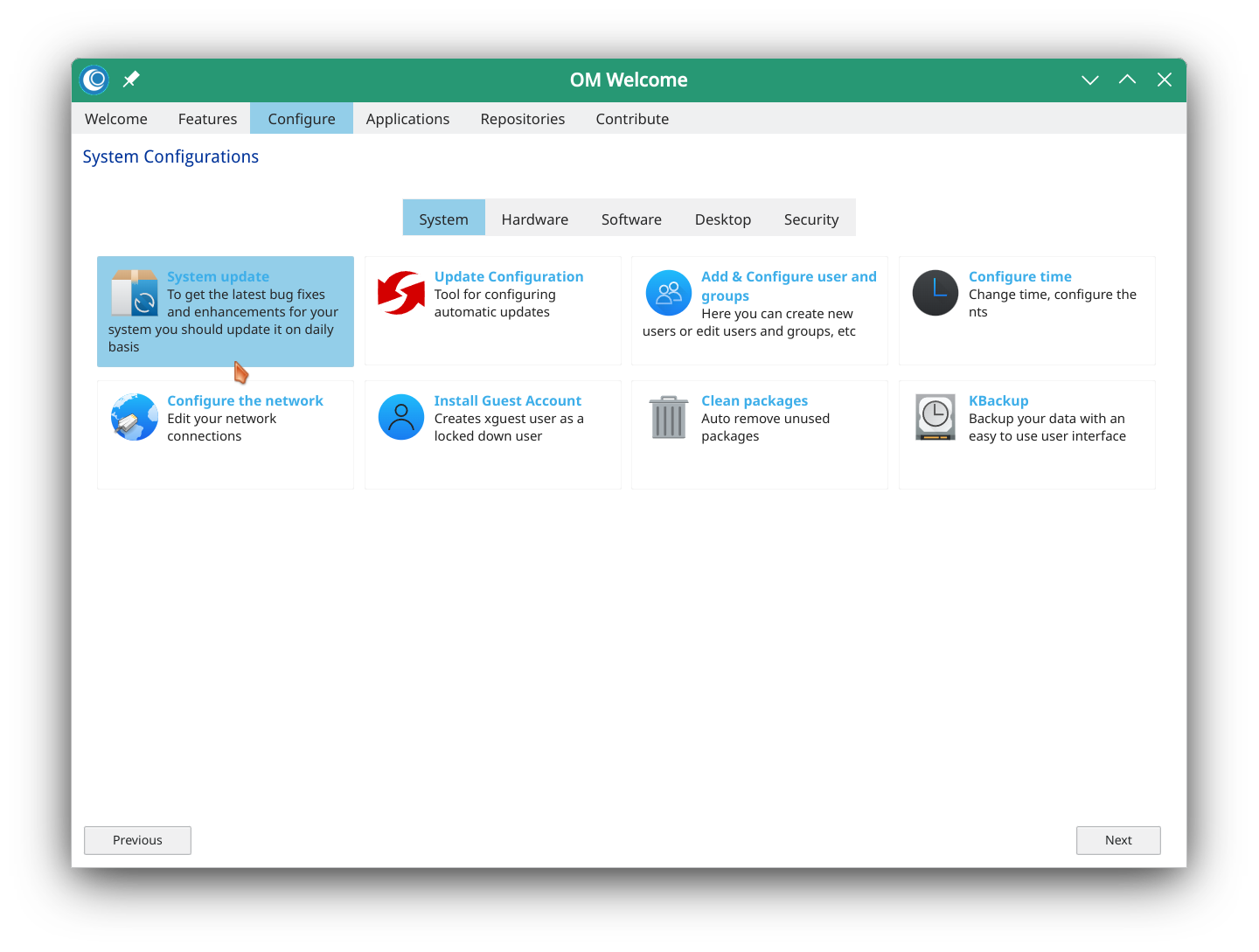

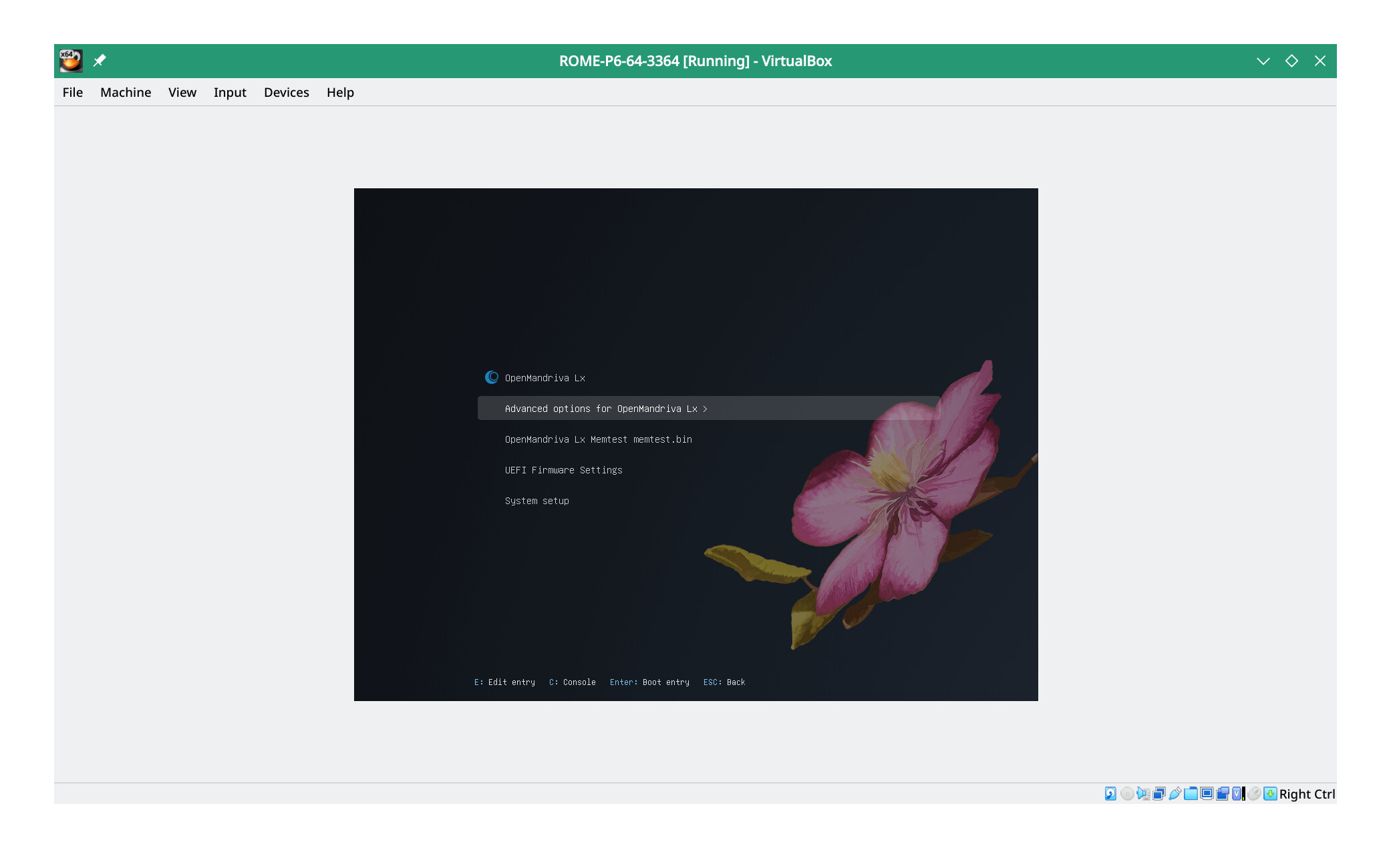

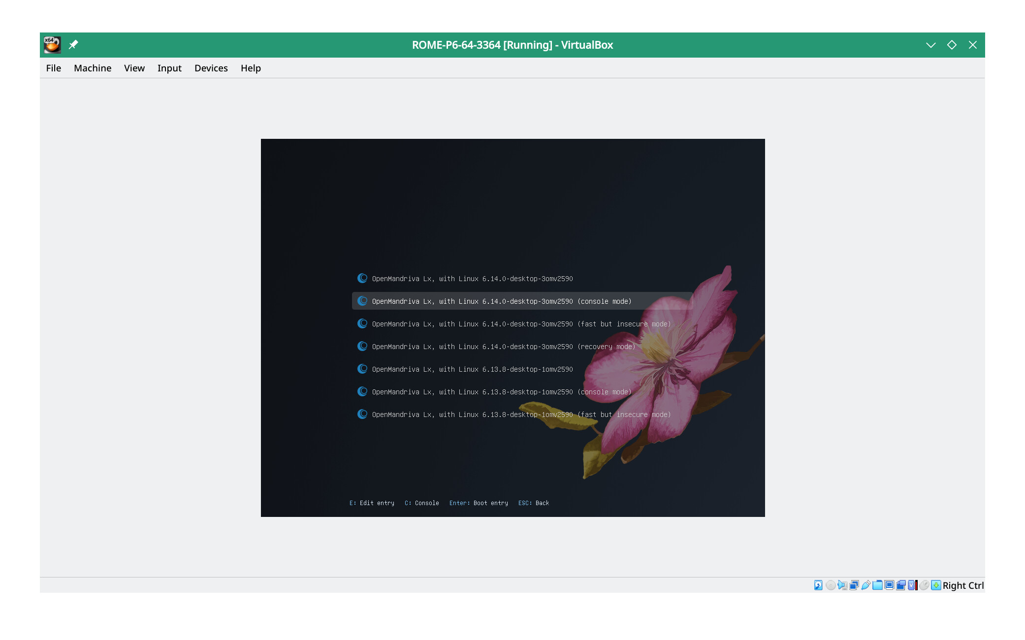

@GarrettJ37 first try this, see if you can boot in to Console Mode in the installed system.
You want the option that has (console mode) at the end of the line. See if that boots. If it does you will see prompt to login. Type your user name and password and press enter to login.
  1. If that all works we will first try installing a newer kernel, to do that type sudo dnf up kernel-desktop, you will be asked for root or administrator password. Enter that and press enter to upgrade your kernel. When the kernel upgrade is complete type reboot and press enter to reboot. Let’s hope this works.
Explanation: sudo gives user administrator or root privileges for tasks that require admin privileges, dnf is the package manager OMLx uses, up is an abbreviation for upgrade and kernel-desktop tells dnf to upgrade to the most recent kernel-desktop for ROME. The kernel install will take a little bit of time.
I have another possibility that may work if that does not. Also we can ask OM developers for a solution if we need to.
If the new kernel does not work we can try one of the solutions listed here.
Edit: We can also try doing a full system upgrade from Console Mode.
Alrighty, here goes:
  • I restarted the computer while in live mode so that it would boot into the regular install
  • Once at the main page, I selected the advanced options line item
  • I selected to boot into Console
  • It did then present my Linux Kernel version, the popped up the error on top of that 1-3 seconds later
  • After about 10 seconds, it prompted me to log in. I entered my username and PW.
  • I entered the command you suggested, then entered my PW.
  • It only took about 10 seconds before it told me “Nothing to do. Complete!” then is now waiting for more of my input.

Edit: @GarrettJ37 if you get your system to boot properly first thing to do is open Konsole (terminal) and upgrade it with the following:
sudo dnf --refresh --allowerasing dsync
OR open OM-Welcome and use this:
