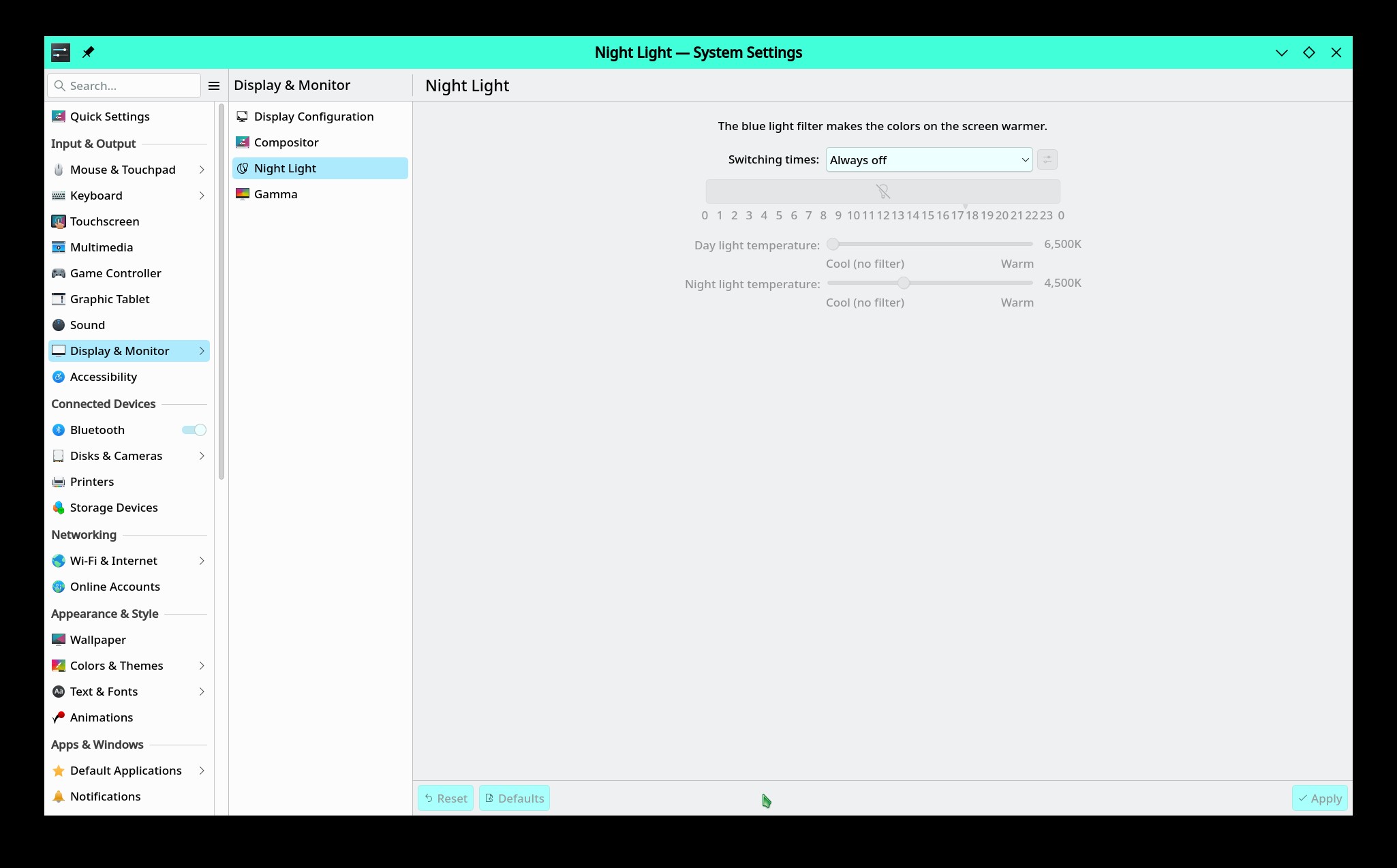

You did not fill out the template asking for information, we do that for multiple reasons, please do not ignore that. When asking questions it is helpful to tell us what version of OMLx you are using.
If you are using Plasma6 version of OMLx look in SystemSettings under Display and Monitor.

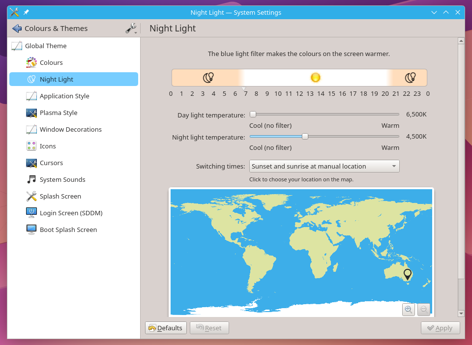

I just wanted to add to this, for anyone looking up this topic later: I’m using OpenMandriva Lx 6.0 (Vanadium) Rock with KDE Plasma 6.3.4.
In my System Settings menu, the Night Light settings are not in the “Display & Monitor” tab, but for some reason they are actually in the “Colors & Themes” tab. FYI

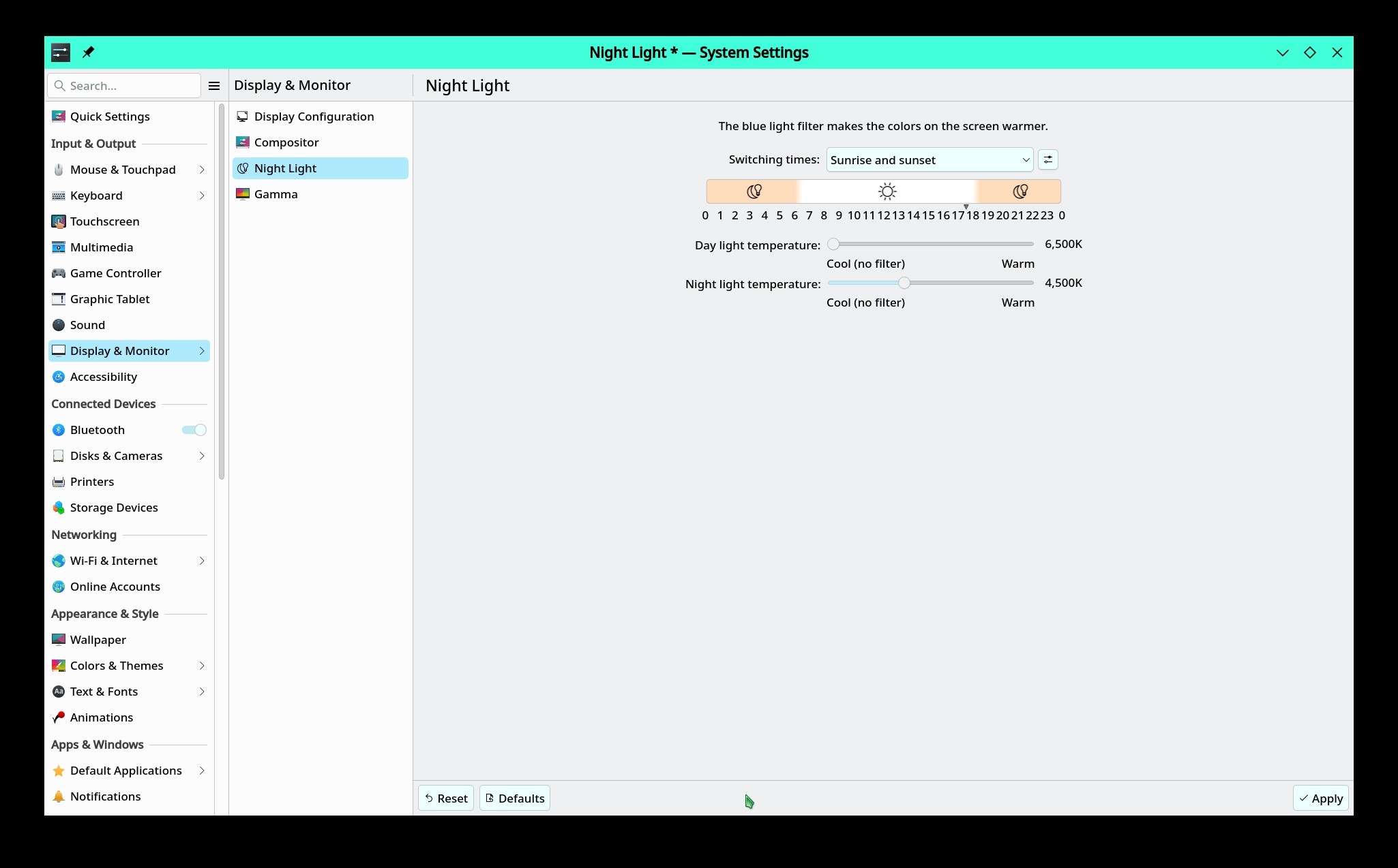

Thanks @Froozle I was reporting from a Cooker system using Plasma 6.5.5. In ROME with Plasma 6.5.3 it is also under Display and Monitor. In Rock it is exactly as @Froozle said.
The more accurate question is, “Do the desktop environments in OM have Night Mode?” The answer is yes. Both Plasma and GNOME have night mode. There may also be others, but those are the more familiar ones. There may also be utilities that will adjust your monitor colors based on your specific needs.
One more thing to add. Night mode doesn’t currently work properly with Wayland. It does work properly with X11 when using Plasma 6 as the desktop environment.
