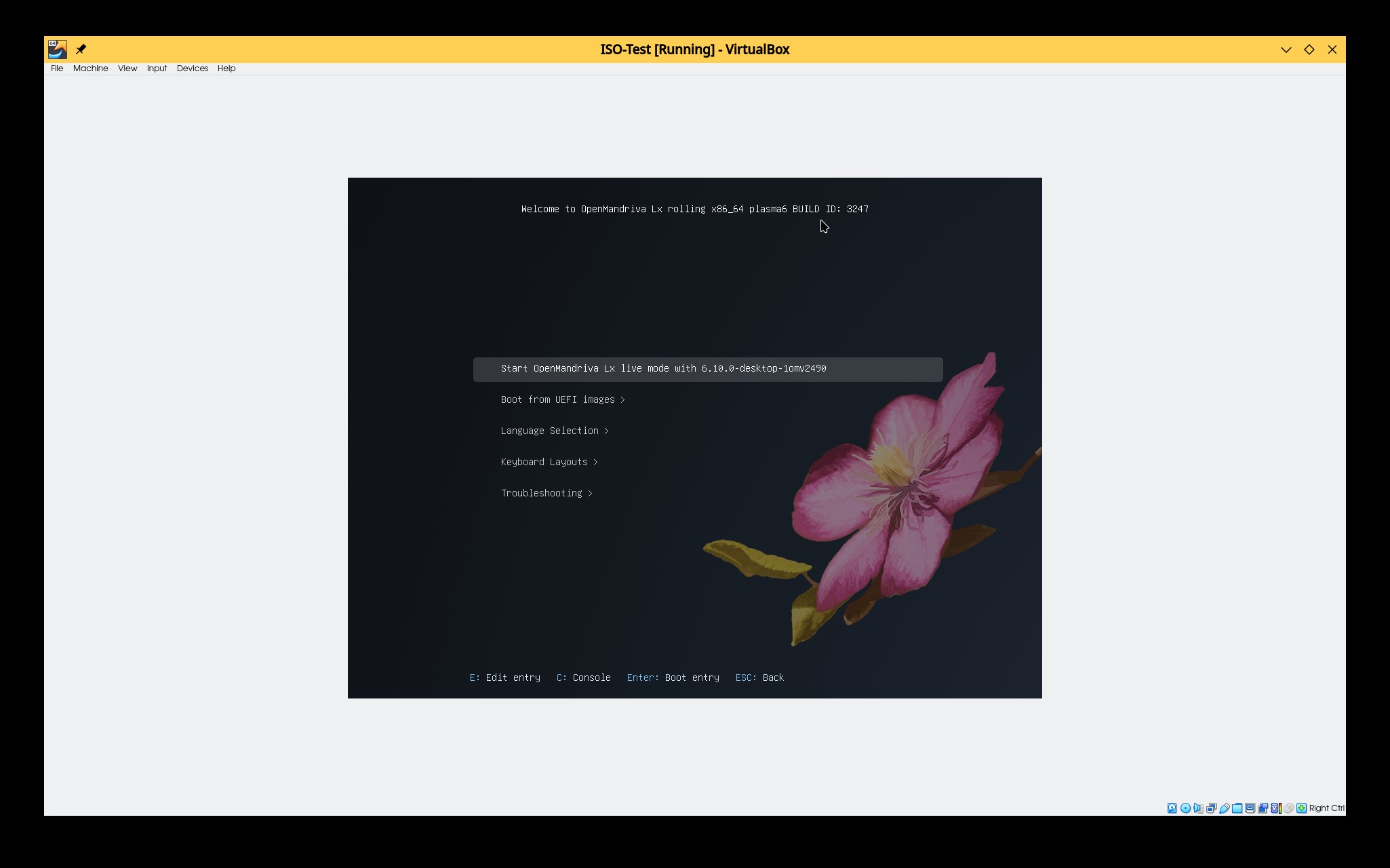

The problem looks more like a corrupted download or bad copy to flash drive. To check if the iso or kernel are corrupted we need to know the exact iso including Build ID. In this screen-shot you can see that the Build ID is a number in the line a top of grub2 menu page.

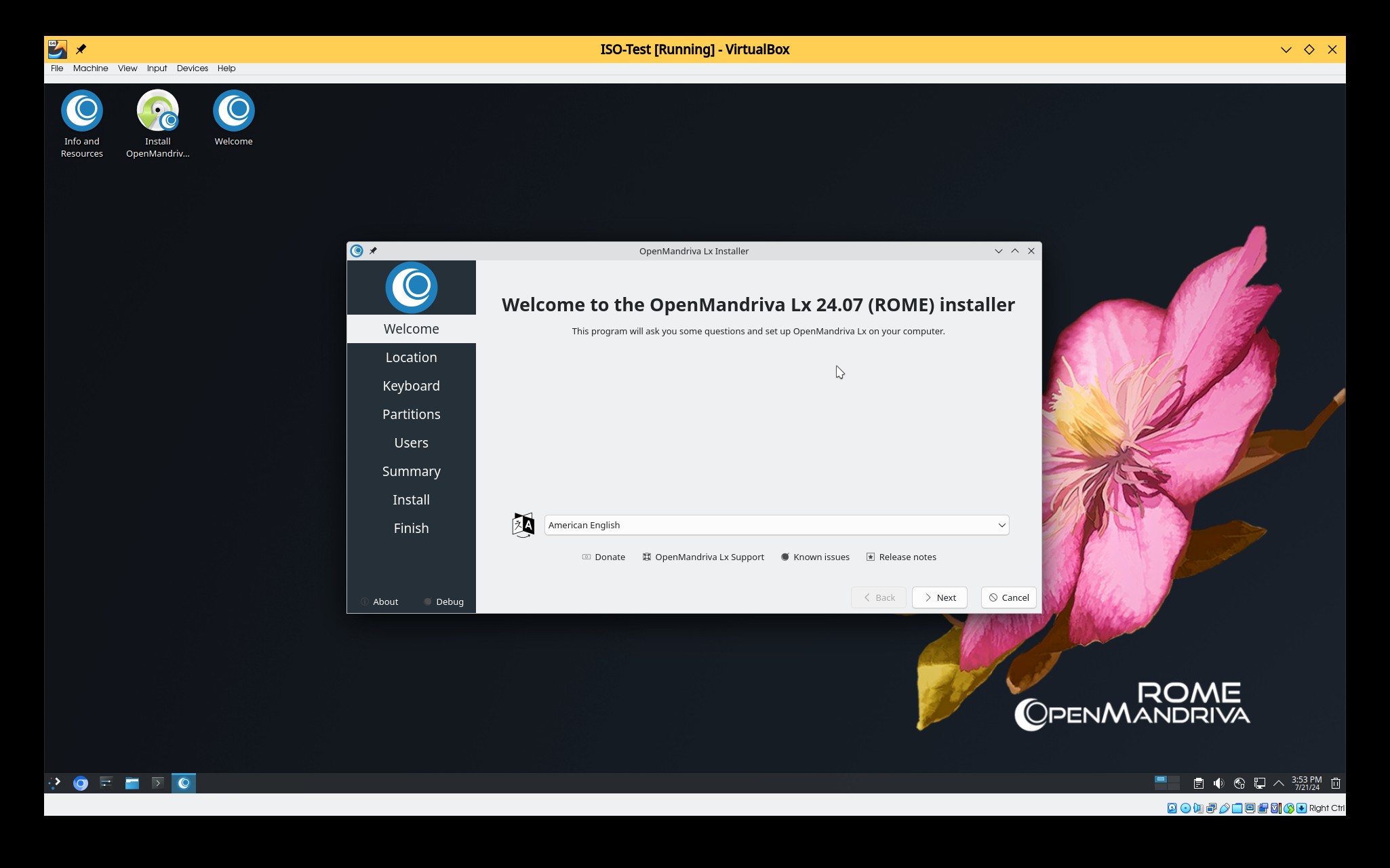

This is shows the installer in the ROME Plasma6 Wayland iso Build ID 3247
I have used this iso on hardware and in VirtualBox and do not see any evidence of iso or kernel corruption on this iso.
Edit: This is the journal log for that iso booted β€˜Live’ in VirtualBox showing no evidence of iso or kernel corruption that I can tell.
journal-iso-3247.txt (54.0 KB)
I know others in OM Contributor group have tested all the x86_64 isos but am downloading the ROME Plasma5 iso to test for myself. Already have the Plasma6 X11 x86_64 and Plasma6 Wayland x86_64. The Plasma6 isos work for me.
