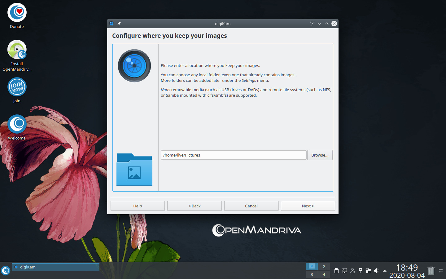

DigiKam is in ISO packages list, and should be installed in default installation. It is for sure available (and working afaik) in live mode.
Live mode:
Installed system:
OM Lx 4.1 Zen Rock KDE install here. I hadn’t used digiKam (or even thought about it) before now, but out of curiosity I looked for it in the menu. I launched it and did the setup. All seems to be working.
