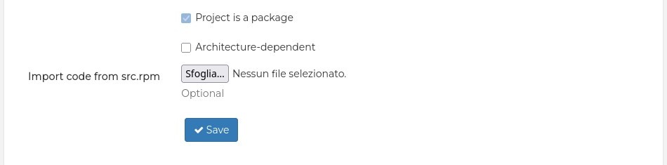

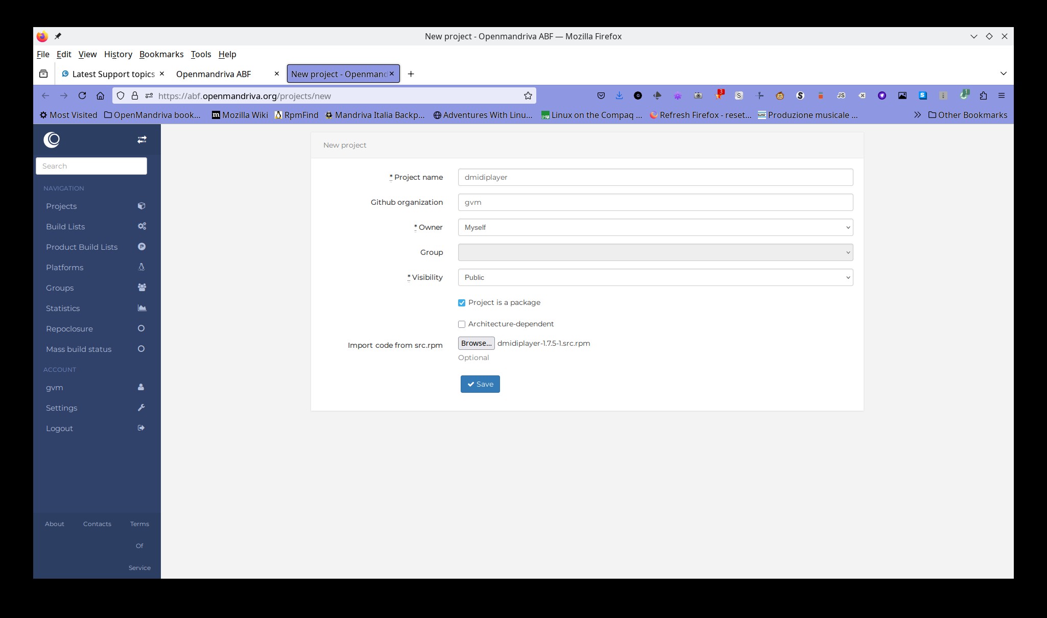

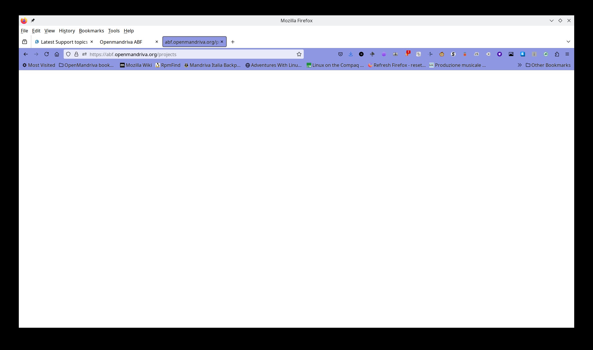

Now I would like to try to create and build the package with the OMV’s ABF, but I did not manage to do it successfully: in the browser, after filling the form for a new package (abf.openmandriva.org/projects/new) from the ABF starting page
How may I solve this issue and start building stuff on OMV’s ABF?
Account nickname: gvm (enabled a couple of weeks ago by Rugyada).
Browser used: firefox 136.0.4 (firefox-136.0.4-1.znver1) with NoScript 12.1.1 (the whole domain openmandriva.org is marked as “trusted” so NoScript should not be the culprit).
Nope.

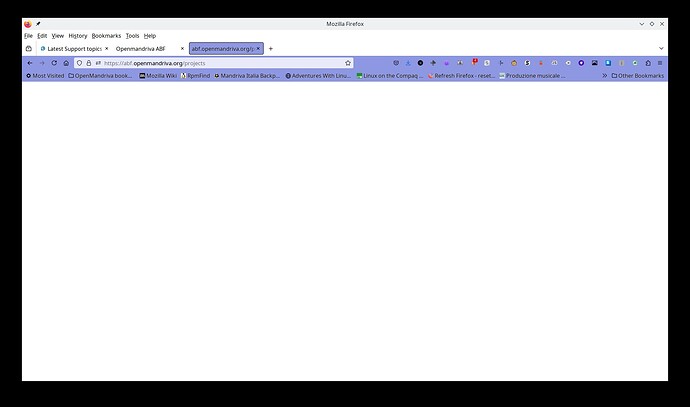

Using Chromium with the same data as in Firefox and clicking “Save” only makes the page hanging forever with the button saying “working…”.

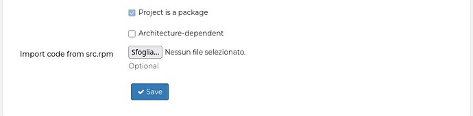

The culprit seems to be the optional srpm loading: if I don’t specify a srpm, the project is actually created both on firefox and chromium… but is obviously empty.
Has someone any clue about what is going wrong when telling ABF to load a srpm?
