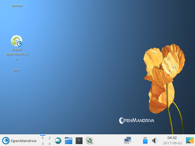

The good new is that kernel 4.11.3-2 (I think it’s due to the kernel) improved display window in virtualbox. The ISO menu starts at 1024x768 and Plymouth screen as well.
The so-so is that subsequent windows resize again to 800x600 :worried:
Install “standalone” in virtualbox keep on working for me as before.
But window is still small.
Then Plymouth as above in live mode.
Then calamares:
I’ve run out of real hardware available for testing. ATM I can not confirm or deny whether or not new calamares version fixed the Install on hardware issue.
The above testing have been made using LXQt ISO 1090, which is supposed to include new kernel and new calamares versions.
Hope it helps.
