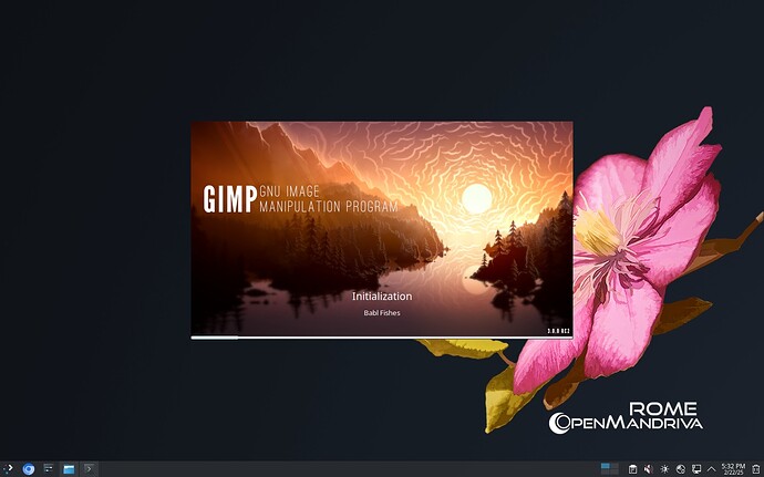

Confermo che accenna a partire e poi.. puff… sparisce:
$ gimp
set device 'ImExPS/2 Generic Explorer Mouse' to mode: disabled
set device 'Virtual core XTEST pointer' to mode: disabled
set device 'VirtualBox USB Tablet' to mode: disabled
set device 'VirtualBox mouse integration' to mode: disabled
[script-fu-test-sphere-v3] The catalog directory does not exist: /usr/lib64/gimp/3.0/plug-ins/test-sphere-v3/locale
[script-fu-test-sphere-v3] Override method set_i18n() for the plug-in to customize or disable localization.
[script-fu-test-sphere-v3] Localization disabled
(gimp:31818): GLib-GIO-ERROR **: 17:24:03.860: Settings schema 'org.gtk.Settings.FileChooser' is not installed
/usr/lib64/gimp/3.0/plug-ins/script-fu/script-fu: fatal error: GIMP crashed
(script-fu:31970): LibGimp-WARNING **: 17:24:04.519: script-fu: gimp_flush(): error: Broken pipe
Trace/breakpoint trap (core dumped)

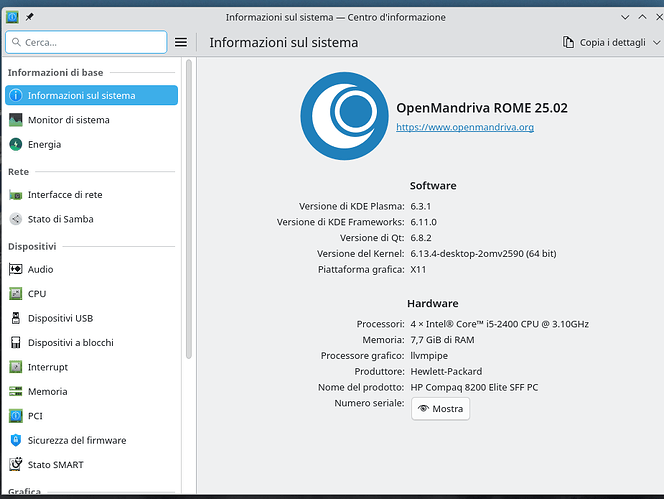

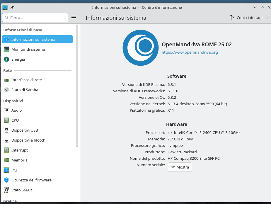

Operating System: OpenMandriva ROME 25.02
KDE Plasma Version: 6.3.1
KDE Frameworks Version: 6.11.0
Qt Version: 6.8.2
Kernel Version: 6.13.4-desktop-2omv2590 (64-bit)
Graphics Platform: Wayland
Processors: 12 × 12th Gen Intel® Core™ i7-1255U
Memory: 15.3 GiB of RAM
Graphics Processor: Intel® Graphics
Manufacturer: Notebook
Product Name: NJx0PU
