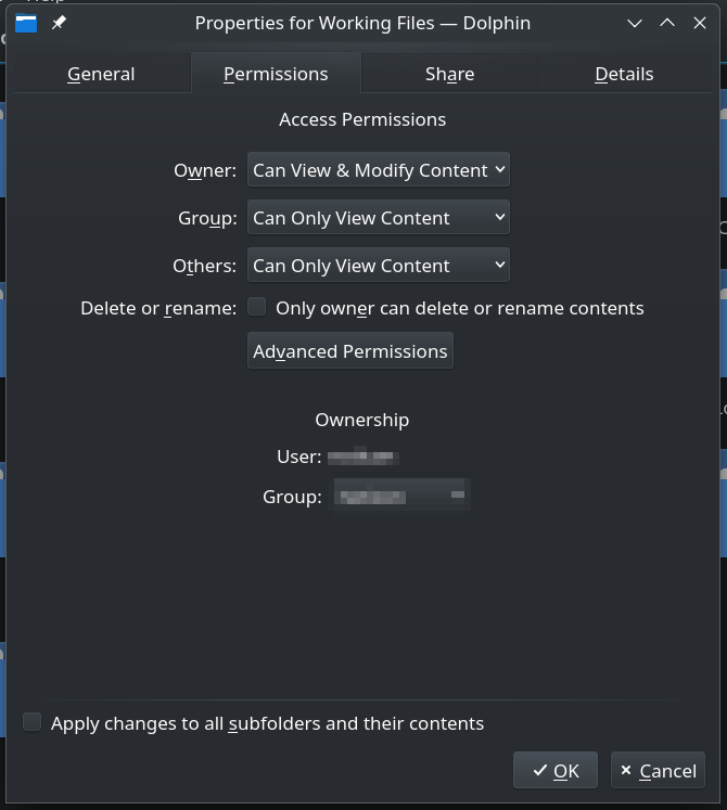

Sorry, I forgot to respond to this. If you want to do it in Dolphin, just right click the folder that has is the mounted drive, press Properties. A window will come up with four tabs on top. The second tab from the left is Permissions. In the Permissions tab, It shows ownership in the bottom portion. User and Group.

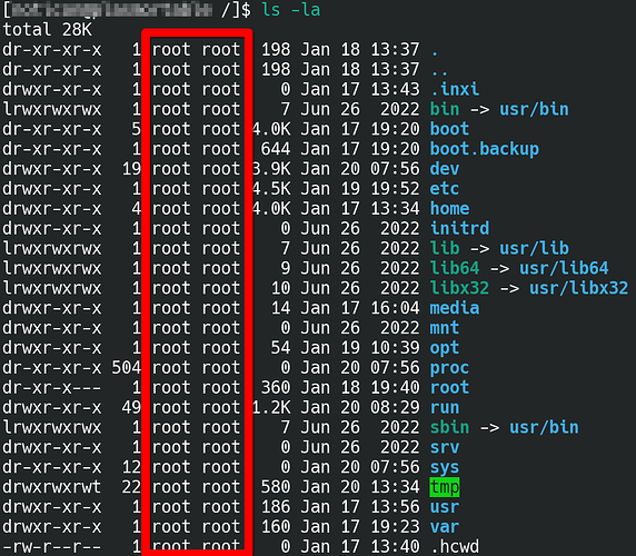

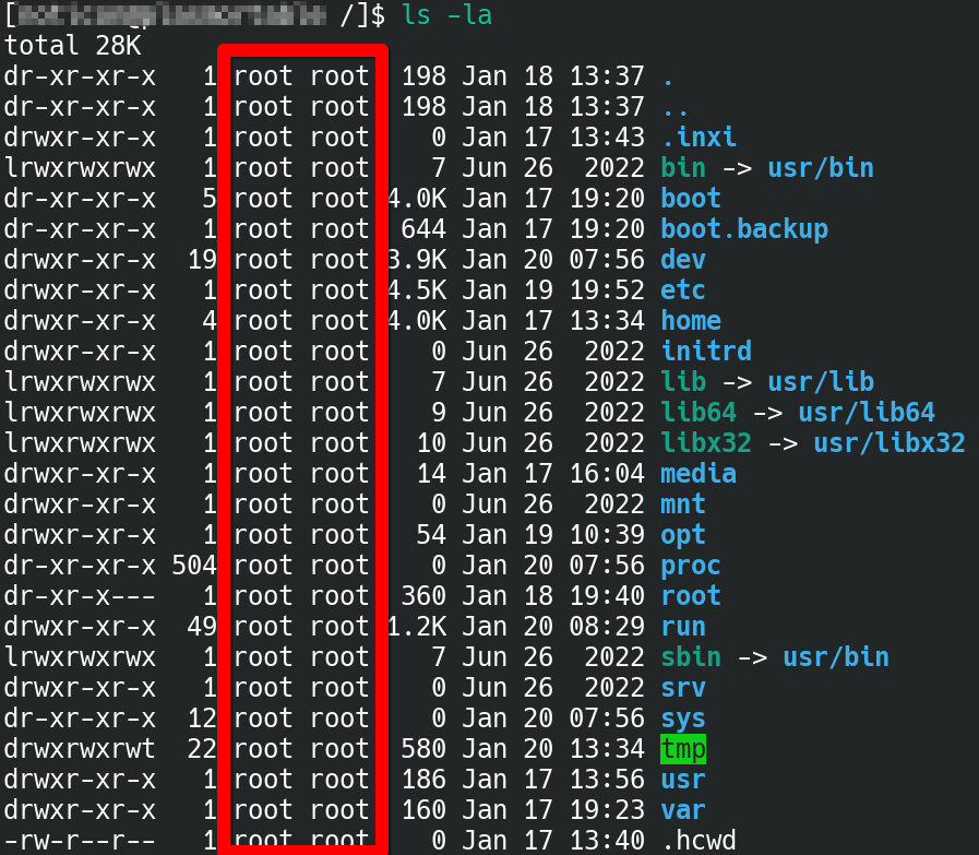

If you’d rather do it in the terminal, go to the main directory in which the mounted folder resides. So if it is /scratch, then go to the / directory
cd /
and type:
ls -la
It will list out every file and directory, where you will see scratch and you will see who owns what on the left side.
If it reads cg:cg then it has been done properly, but it will display whatever user and group you have specified. I have begun to wonder whether you ran the chown command before you rebooted or ran sudo mount -a which would change ownership upon mounting. In which case you would have to run the chown command again. At any rate, I hope it is working for you now.
If you have trouble finding the directory you can type this instead:
ls -la | grep scratch
this will do the same but pipe (|) it into another command, grep, which will look for a term you specify, which we gave as “scratch”
